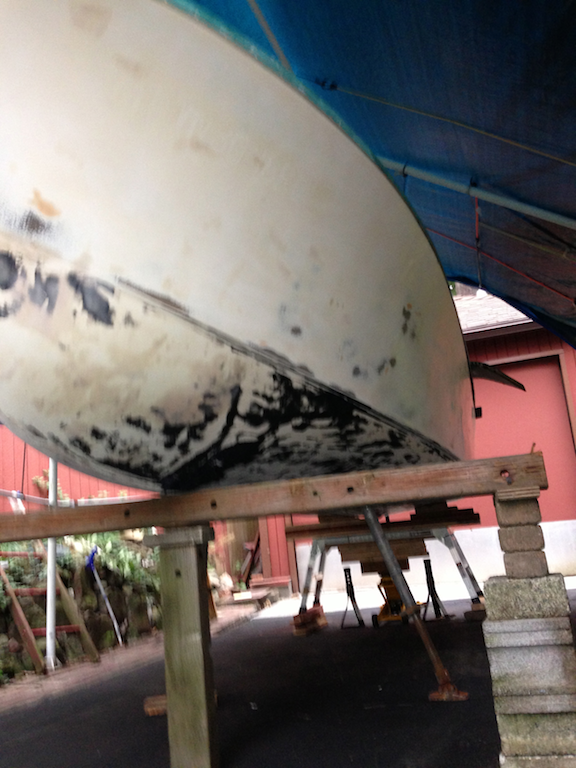

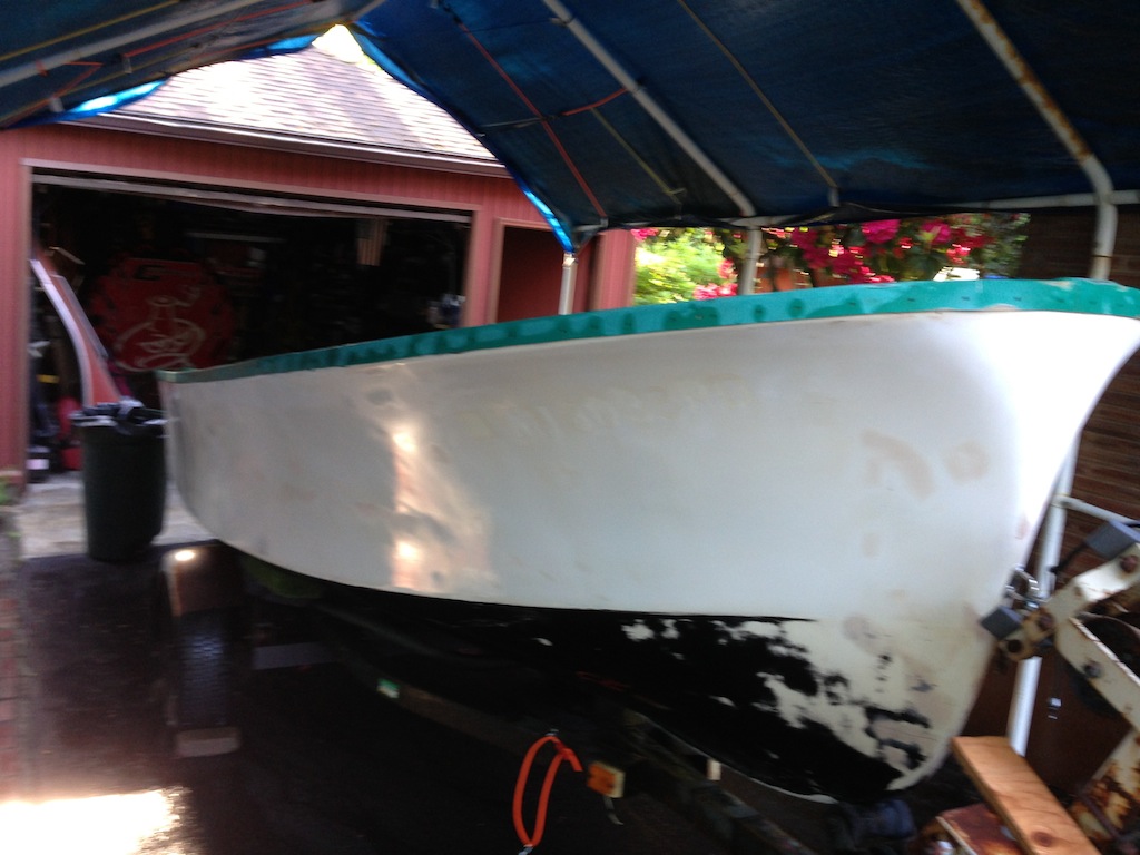

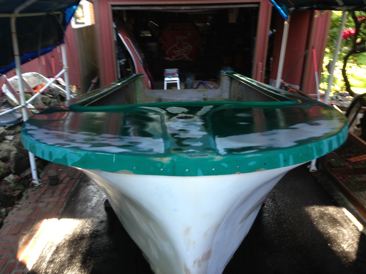

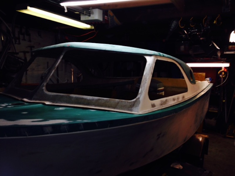

I have a new topic as i recently took my boat up for painting but i was BLOWN AWAY at the price.
Im thinking about painting it myself as i could buy the sprayer myself for the price of the paint job.but i have never painted a boat before and i dont want to mess up as i have been sanding for two years now.
not sure if this would be a good idea to paint it myself as Im not a painter.
I have four pieces to paint as it also has a hard top.
any help is appreciated.
I know this would be a process but wow this is just a 16,' bell boy.
Thanks
p.s. I have all the screws, and hardware off the boat and most all the sanding is done.

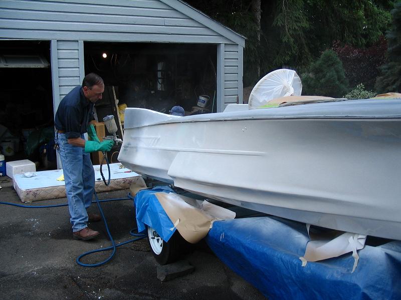

My father was in the auto body business for 55 years. We primed my boat in the driveway after all the body work was done, which really cut the cost when it came time to spray the color. The boat was done at a body shop in a paint booth...cost of paint and labor, $600.
