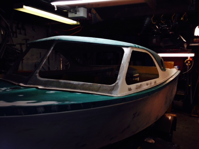

OUCH!!! price of painting
thanks for all the help.
I have a new topic as i recently took my boat up for painting but i was BLOWN AWAY at the price.
Im thinking about painting it myself as i could buy the sprayer myself for the price of the paint job.but i have never painted a boat before and i dont want to mess up as i have been sanding for two years now.
not sure if this would be a good idea to paint it myself as Im not a painter.
I have four pieces to paint as it also has a hard top.
any help is appreciated.
I know this would be a process but wow this is just a 16,' bell boy.
Thanks
p.s. I have all the screws, and hardware off the boat and most all the sanding is done.
