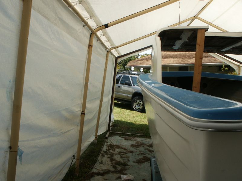

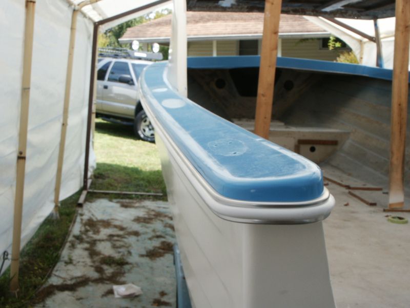

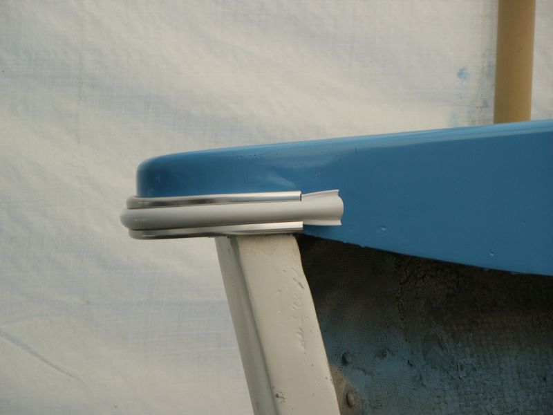

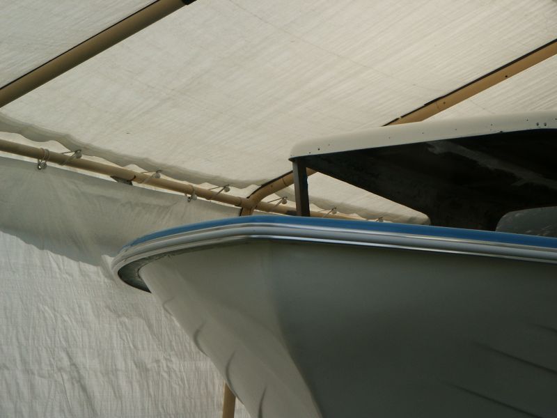

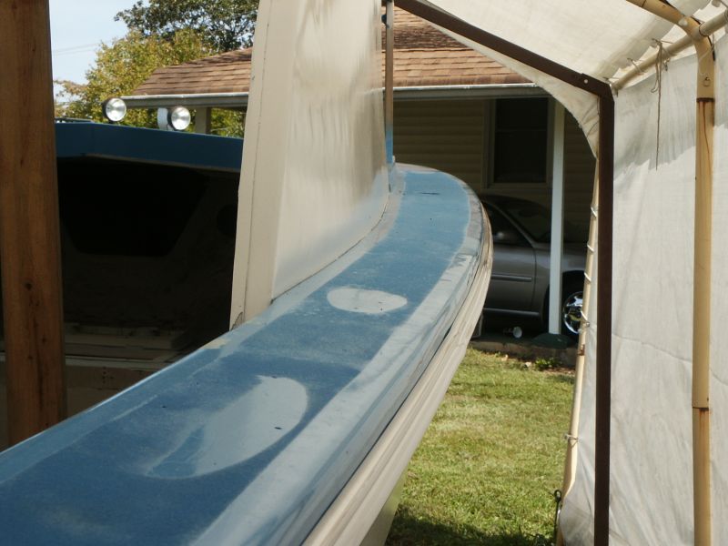

ok i got my rub rails on and the first little bit of hardware to go back on the boat and it feels good. and looks good too. note / if you buy aluminum rub rails please make sure they are very well protected. and check the shipment before the truck pulls off. \

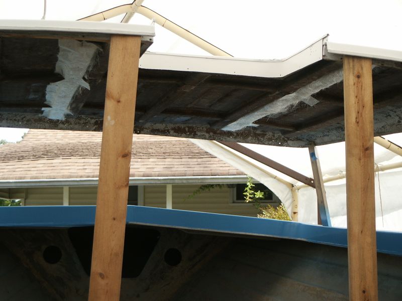

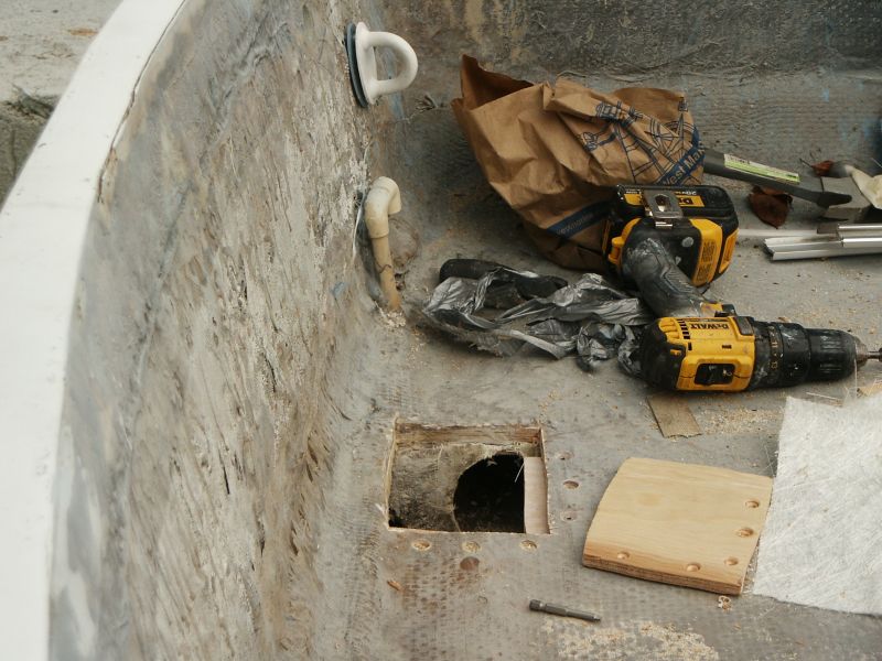

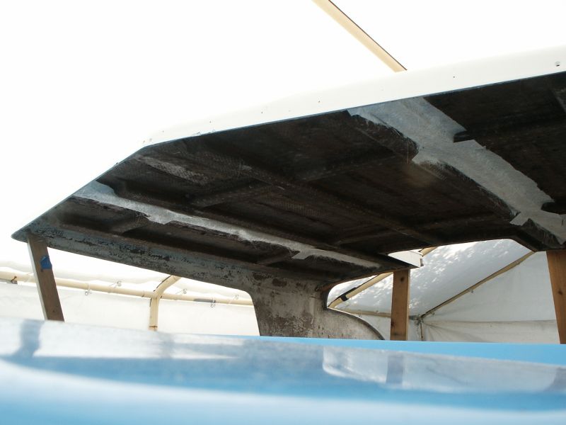

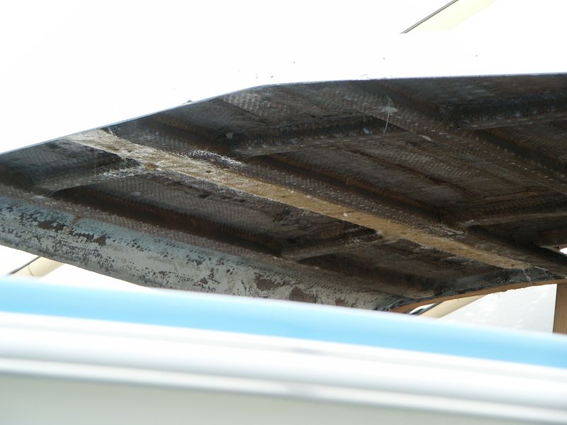

but back to my boat. i put my roof supports up today the old wood glassed in were 50 years old. i wanted to add a little bit more i glued the 1x3s in then cut my glass and stapled it to the wood i went back and wet one side but i was worried because my catalyst had the paper broken down and in the bottom i was worried about it not being fresh ... i only did one side ad then threw it away. it did harden up so i need some more to finish the other side and the hole i cut to remove the metal vent tube i installed because i was afraid of fumes under the floor.. im over that now and i cut it out and need to patch it. s picture of the rub rail the roof support and then one of the hole i cut in the floor. so here you go.
