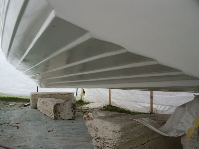

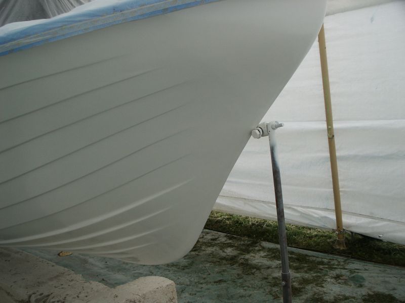

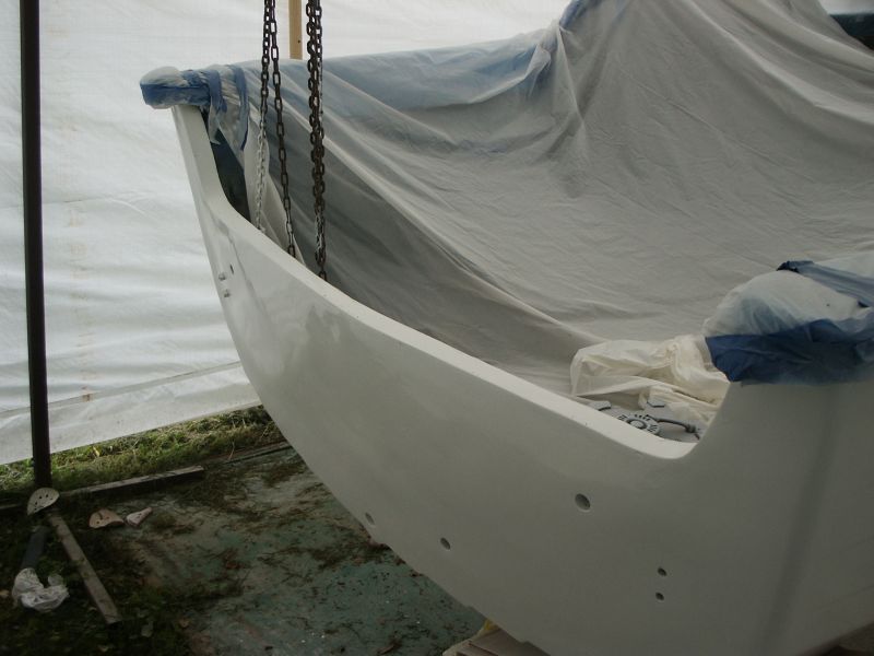

ok i know everyone around here will be glad i got the hull painted, i can stop talking about it now. looks good and if it will hold up as what the description said it would i will be in great shape. the painting jig worked fine. allowed me to paint one complete side and then flip for the other. here are a few pictures ok note if you will look at the transom, at the lap joints all those on the back were worn down to nothing, the keel was tapered up ,looks like where it was dragged up a ramp or down the street. i built all that up. looks good now if i say so, and i do alot of work went into that.

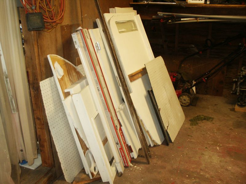

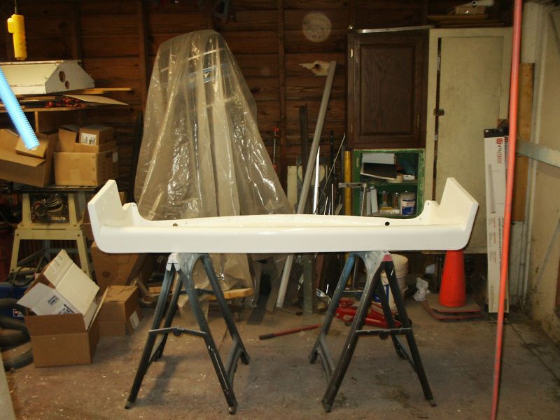

moving right along next is the cabin pieces that gets paint.

Great job, was it sprayed or brushed and tipped? What did you use for paint?
Jack
Re:painting a monster 10 years 11 months ago #114778
sprayed with a gravity fed gun from harbor freight i used primekote primer from interlux the two part epoxy then the deck i used medium blue brightsides from interlux and then i found a one part white from bottom paint store for hulls and under water i sprayed the top and the hull three coats i'm cleaning the inside and spraying the tuff coat light blue flex soon.

Hi. Can you say exactly which bottom paint you used from the Bottom Store? There seems to be a lot to choose from on their site. Thanks,
Tom
Re:painting a monster 10 years 11 months ago #114881
scuse me it was revolution the one part paint... its like painting plastic on very hard.
www.bottompaintstore.com/advanced_search_result.html?y=0&x=0&keyword=revolution&zenid=9b5b5fbf6a0f73f8094eb0d0c3a56308&search_in_description=1
not cheap but i feel comfortable with it.
