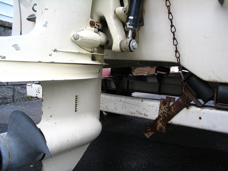

Joe:
I raised it up 2 holes - puts the plate even with bottom of keel - it's funny that this boat lived its entire life with the motor mounted too low (the crappy aluminum prop just did not show the symptoms that quickly became apparent with the new prop). The method you suggested worked perfectly (and I did it by myself with no issues). :)
I think that this will add a couple of MPH just by reducing the drag and lessening ventilation. I can't wait for the weekend to take her out for a trial run (hopefully I won't have to drop back 1 hole..... cause I really sealed up those bolt holes.
I will take pics tomorrow and post.
If it still has issues I will try with the hydrofoil removed (it just makes it ride so much smoother in chop.
