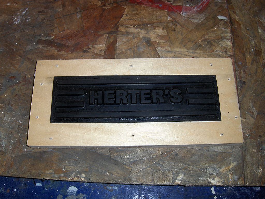

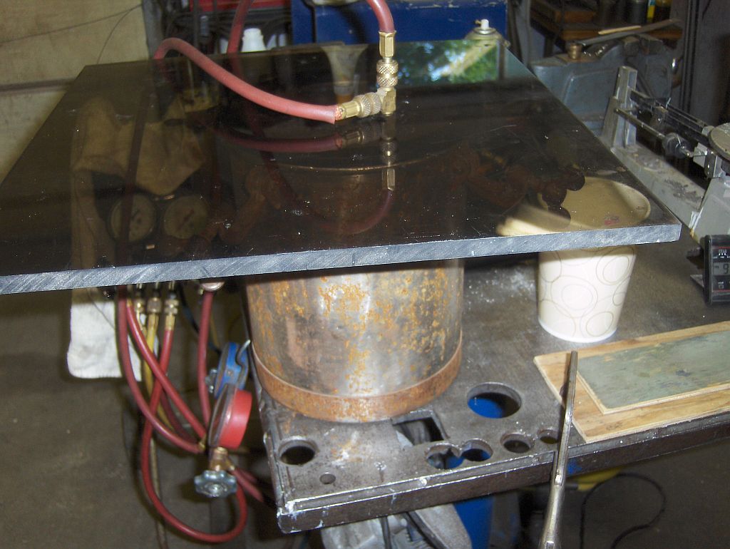

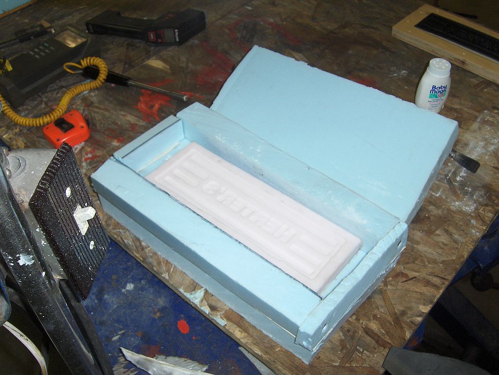

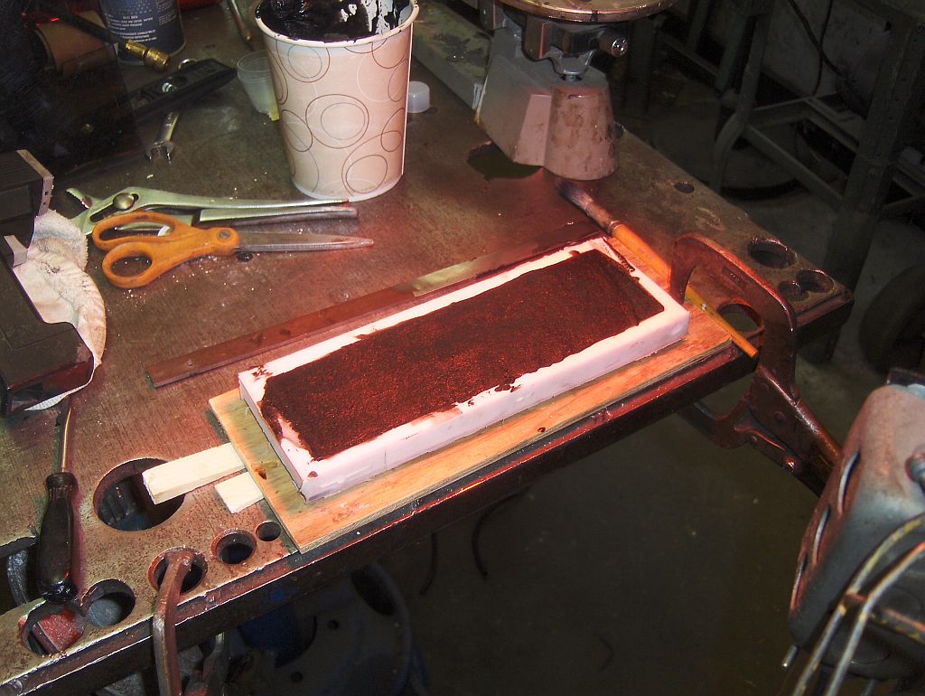

andrew,
I have made step pads for our Herters boat using Alumilite rubber.
They have compatible dye to color the rubber.
If you want perfect parts you really need to use a vacuum chamber and use a heat light to speed activation. I also refrigerate the A and B materials before I mix them to get a longer pour duration. I preheat the mold to about 150F to reduce air bubble s in the part.
There is a learning curve, but once you get it sorted out it's not difficult.
Making the mold is fairly easy as the pour time is much longer.
Pic one shows the mold in a foam box to retain heat in the mold. Next one is my homemade vacuum chamber. Next one is speeding the activation process with a heat lamp, and the last one is a finished step pad.
