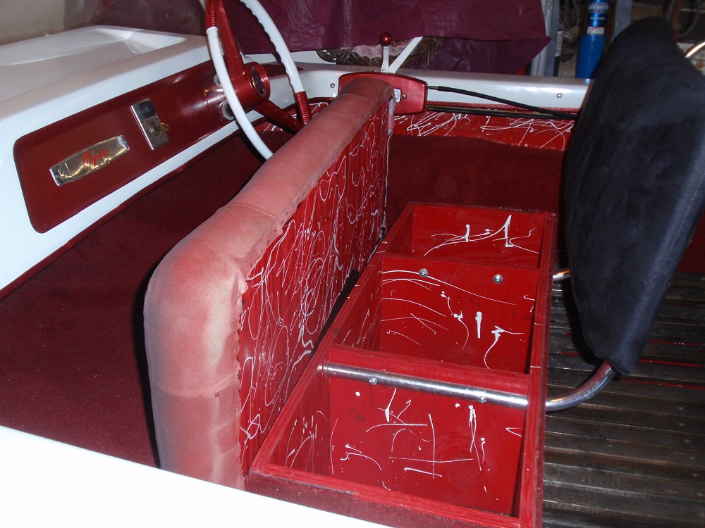

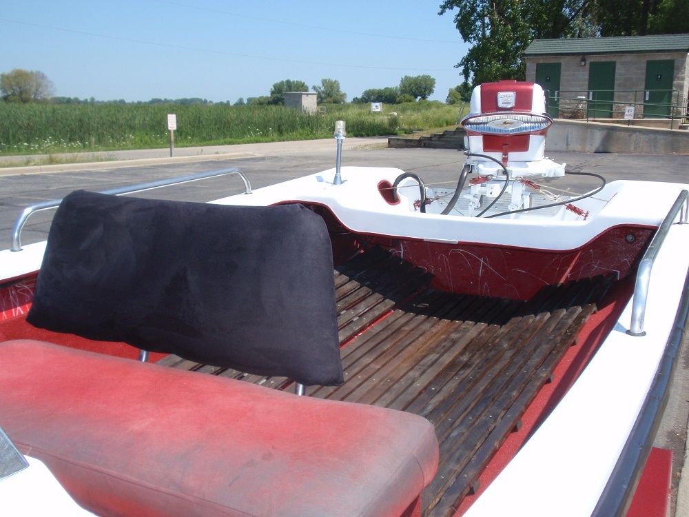

Edwardo no longer has his Mystic, it was sold several years ago. We mailed each other while I was rebuilding mine.

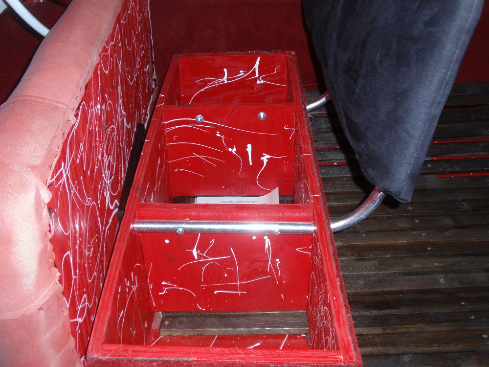

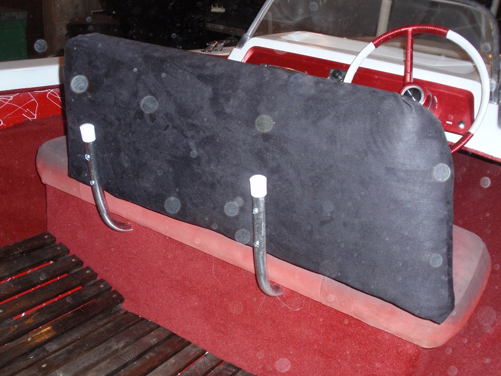

I think I already mailed you what I have. Had to improvise on the interior since I couldn't find any up close pics either. The front seat bottom is a box design made from 5/8 ply for storage and is bolted to the floor and front kick panel. The back of the seat is mounted on stainless tubing that I bent then inserted wood dowels so it wouldn't collapse when the bolts were tightened, "T" nuts are in the back of the seat for the bolts. Then drilled holes for the tubing on the seat box and then put everything together with 1/4" bolts. There was supposed to be a center seat/storage box behind the front seat but I didn't get that far yet.

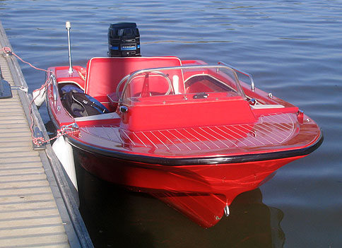

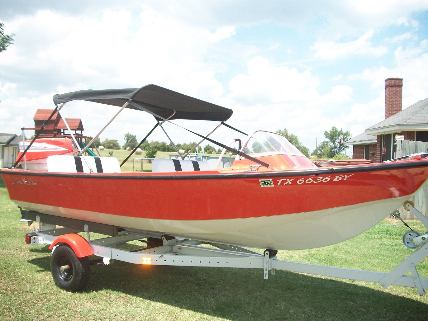

heres mine
Re:1965 Lone Star MYSTIC 11 years 2 weeks ago #113960
Cool - unique layout.
I like it!
