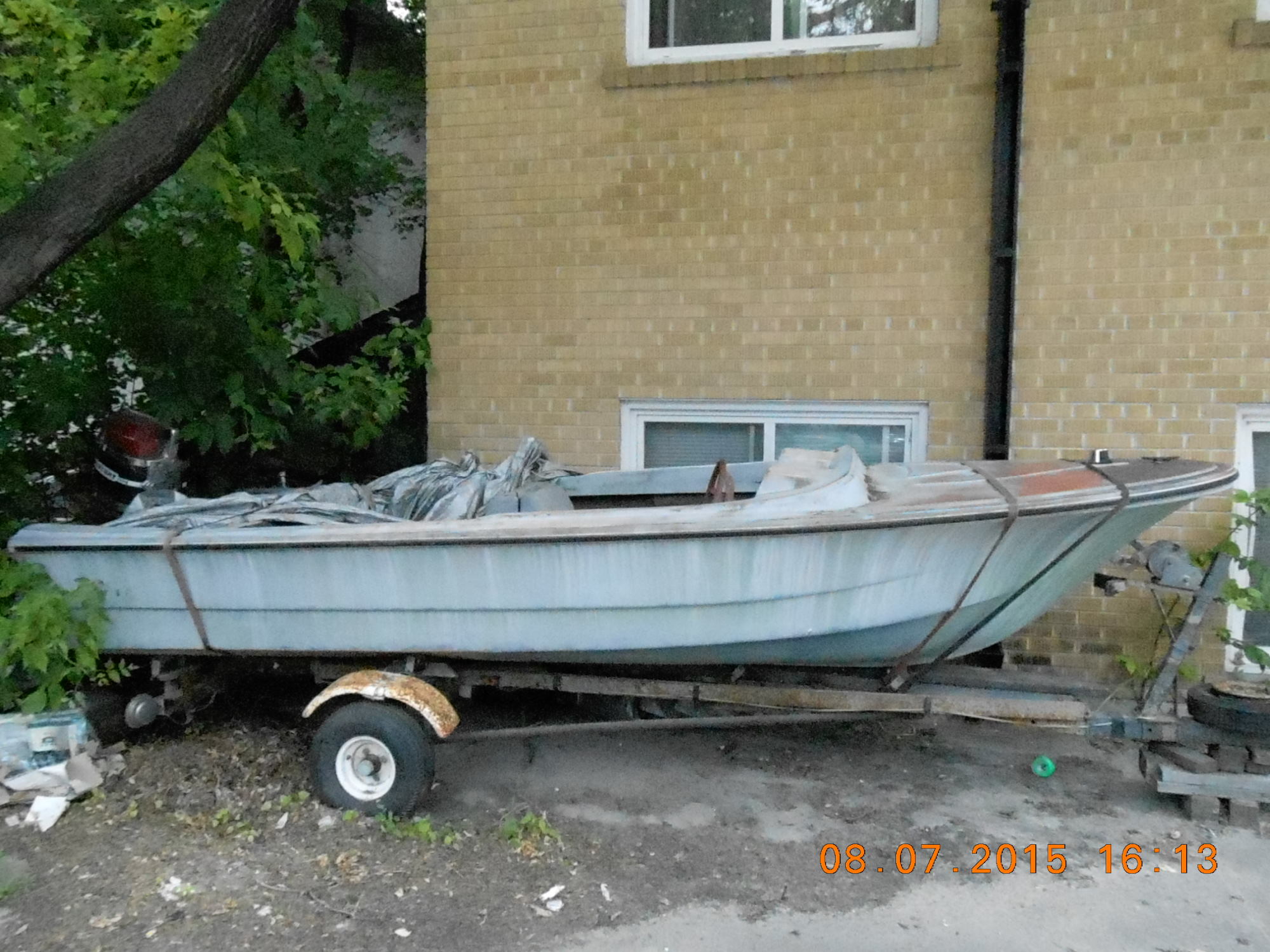

Can any one tell me what this is? I plan on restoring her in the future. The insurance company wants to know the make and model but I cannot seem to find any badging or serial numbers. It has a 65 Hp Mercury Mark 58A on it.
Any help would be much appreciated
I can take much more detailed pics if need be
Thank you

Welcome aboard , glad to have you here. Do you have any pics of the bow, that will help also.

Looks Shell Lake-ish to me.

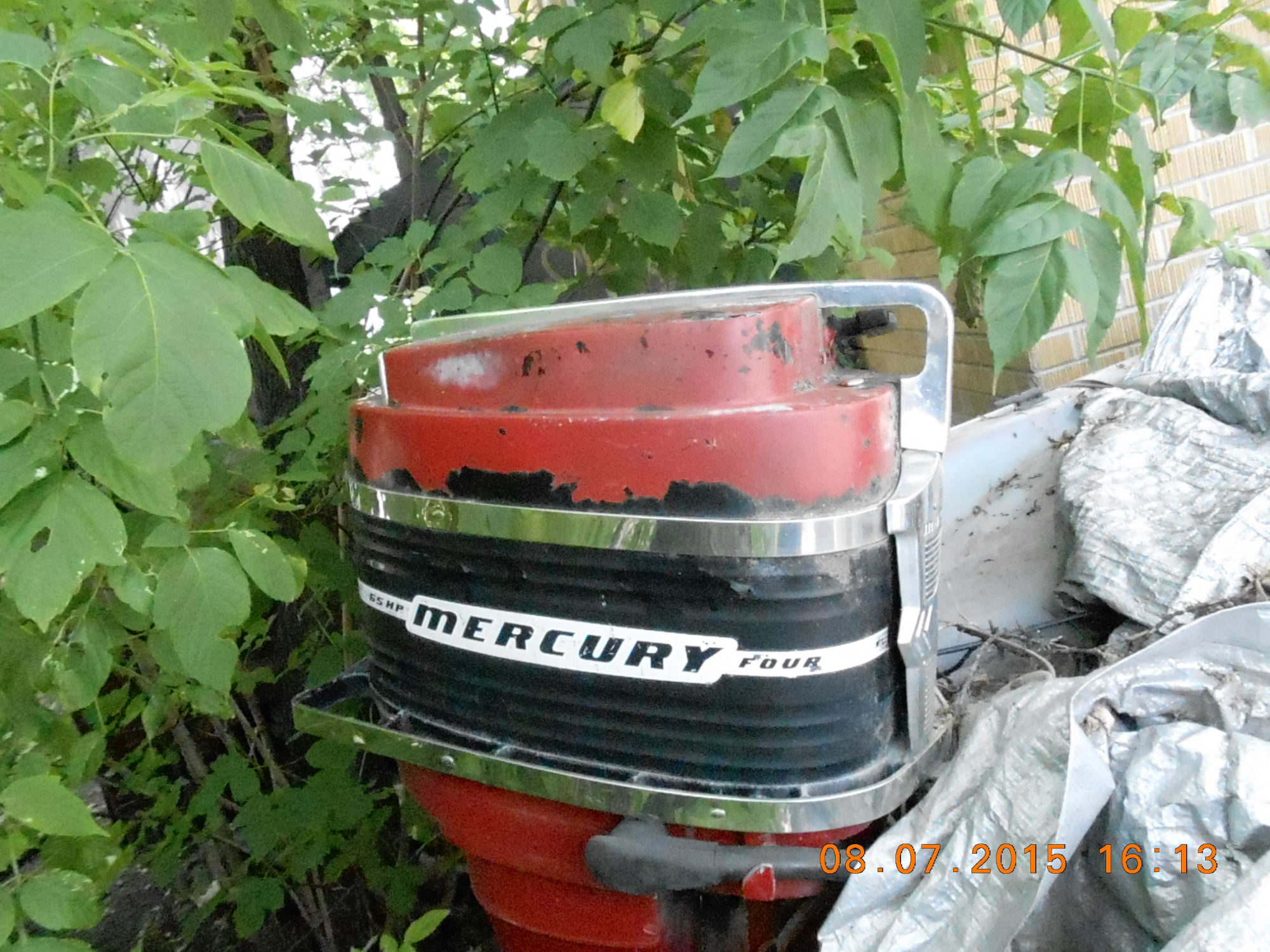

BTW the motor does look to be a 65hp, but that would be a Merc 650. A 58A is a 45hp with a smaller block. I have a couple of them. The front panel may be from a different motor.

I think I've seen that bow before but I can't place it. I know it should be a dead give away for someone here. I don't think that bird was that common.

If the serial number plate is still on the motor (on the swivel bracket, above and between the transom bracket clamp screws), post the ser. # and that will help identify the engine.
Looks like a '63 or '64 "650" 65hp.

If you change the faceplace, I'd be interested in the 58a one.

The serial # on the motor is 171005
