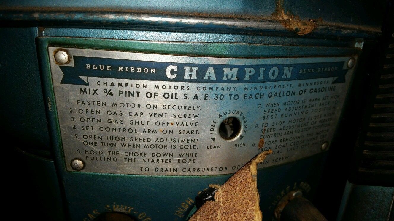

Some of the very old ones ran on 16:1 and I bet they smoked a lot when all they had was 30W oil to mix with the fuel!
Edit: Check out this Blue Ribbon nameplate I found in an eBay listing. I think it comes out to be around 12:1 !!! :0
Re:2 cycle fuel and oil 11 years 1 month ago #112889
Same label as mine. During the break in period it was even higher. Have to admit though, if it's still running after 65 years they were doing it right.
