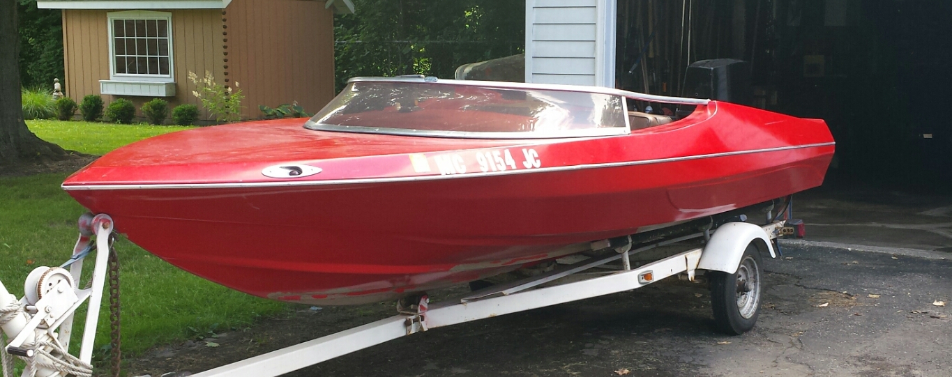

My name is Dennis. Live in West michigan. The wife and I decided to get an old boat to play with. I found a neat looking 74 wriedt spoiler 16. 70hp johnson. Previous 15 year owner. Bought off Craigslist for $1000. Hasn't been in the water since 2013. I am replacing the water pump and adding a telltale to the engine for water movement. My main question is this. The cap doesn't come off like other boats I've seen. I want to redo the transom, (previous owner did but not like I want it). Do I leave the cap on and cut the rear of the boat out and go that way or do I cut the cap off and go that route.

If you cut out the back of the transom, it will be hard to make it straight and blend into the original profile of the stern. Lots of people pop the deck off for this reason, and retain the original outer skin. Usually you can tell when someone cuts out the rear transom skin and it never looks the same. Conversely, removing the top deck is tough and can be hard to get it to fit again. The decks can be fiberglassed on, bolted, stapled, riveted, or otherwise glued to the hull.
Re:First Post. New member question and introduction. 11 years 1 month ago #112592
Typically where the rub rail is, behind that, is where the seam between top and bottom is.

WELCOME ABOARD. = ImVho, cutting out the transom's rear skin is a LAST resort AFTER you've failed at every other possibility. = I've never seen one that LOOKED RIGHT after the transom skin was removed/replaced.

Looks like a Sidewinder copy. I'm sure there's a seam under that aluminum strip. The top is probably glassed to the hull on the inside. You'll more than likely have to cut it off at the seam and reglass it back together when you're done. Not an impossible job to do.
Re:First Post. New member question and introduction. 11 years 1 month ago #112602
If there is a seem behind the trim it is perfectly straight. The trim is only 5/8" wide.
Re:First Post. New member question and introduction. 11 years 1 month ago #112611
I'm sure there are exceptions, but every fiberglass runabout I've had or seen, that is where the seam is. The rub rail hides it. Take the rail off and get out the jig saw.
Re:First Post. New member question and introduction. 11 years 1 month ago #112623
Pulled the trim off and there it is. The seam. Got the carpet and seats out. Seriously bad repair has already been made. No big deal. I can do this. Going to pull the floor out. It's been done once really recently. No tabbing, the wood isn't sealed with resin and it only has a single layer of glass csm. I will be using the boat to pull my kids in a tube so it has to be strong.

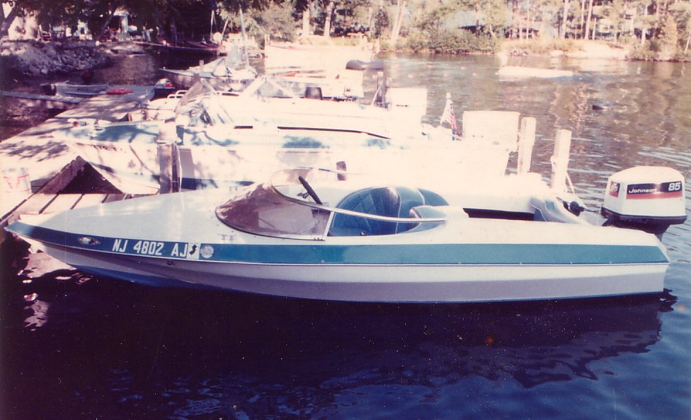

This is a picture of my '74 Sidewinder, which appears to be the same hull. Great boats. I've been sorry I got rid of it almost from the moment it was gone.
