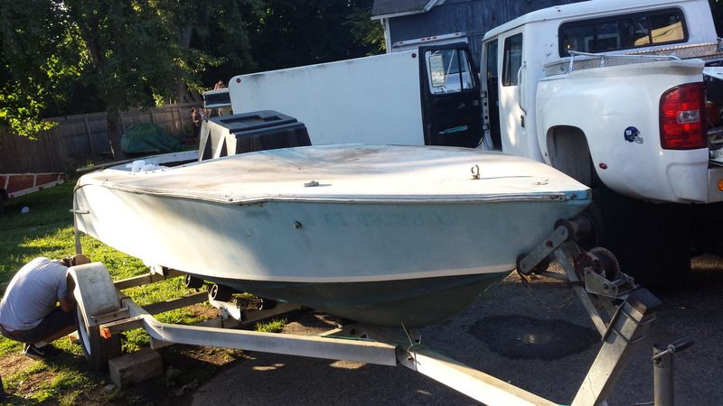

have a new question though... got the big ole 454 that was sitting in the drivers seat out of the boat last night... (moving a 454 on an engine crane when it's 7 feet up is hairy!) SO next step was to try putting some pressure under the bow area where it is concave... it seems that this is double layer without any core material... can't put pressure on it... any thoughts on how this is constructed?? I'm wondering if I'm going to need to slice open the under skin to slide in a wooden support and glass that in place??
Re:First post, 1965 Formula Jr. project 11 years 1 month ago #112633
well, I put some pressure under the bow deck and found that I could push up on the upper half by pushing against the lower.. .nothing between them but air though so that is still a concern. no support to keep it there. have it sitting up now, I will see how it reacts after a few days in that position.

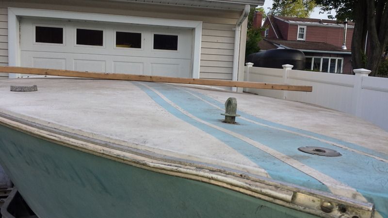

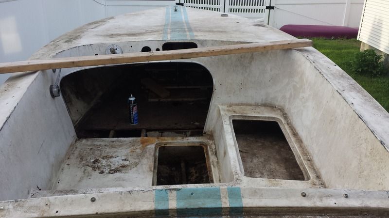

the boiling water might be a good idea but I don't know how well the suction cup would work. i'm getting enough pressure from the bottom now I think. I will be putting a longer board under it tonight for more even pressure. you can see where the 2x4 is on the bow now, it was low about as much as it is high now.. the very forward portion is hard to reach but with a longer board I think I can get it.
you can see, I have 3 shots of the sunken bow... when I first got it, then I put a little pressure too far back, last night I cleaned out the boat and got right under there with a 2x4 and got it much better, hoping tonight third time is the charm and I get it to a point that it will all look smoooooth.
