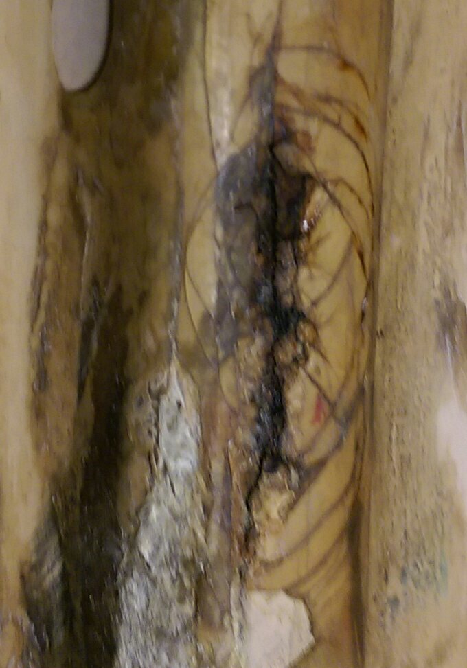

Re: Johnsen Boats 11 years 1 month ago #112391
This is the one in the hull.
Re: Johnsen Boats 11 years 1 month ago #112397
Pretty basic repair. You can use a R/O sander and some 40 grit paper or a 4 1/2" grinder and some resin coated discs to grind it down to fresh glass and then use polyester resin and CSM to lay down some new glass to build it back up. Sand it some then use some final fairing material to finish it off and either re-gelcoat it or paint it.
