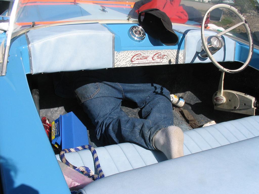

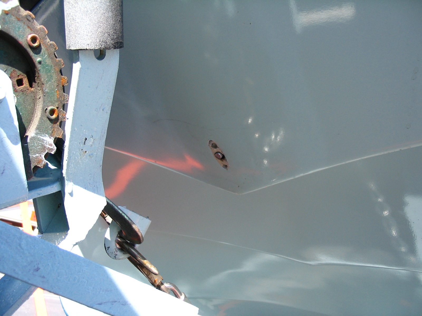

i pulled my boweye out going to a meet several years ago. luckily it was screwed in to a wood backing plate so it did no damage, other than embarassment. my buddy (houston)put a new one in when we arrived at the meet. a few pics..sorry i have no idea how to repair it, but you'll get plenty of help here. : :
let me add how he got under there was a feat in itself, because it has a tunnel hull.

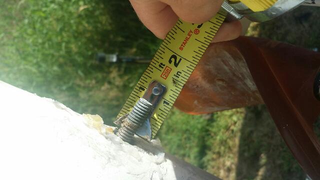

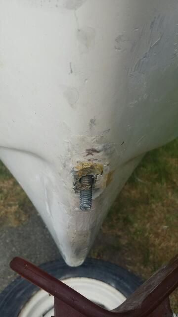

Finally climbed into the bow, behind the fuel tank (how in the world is anyone supposed to get up there) so......looks like a 4" bolt with no washers, no backing, and hanging on by a thread. All looks like original parts and the previous owner may have tried to secure it up with a patch of cheap fiberglass resin....silly if you ask me! Luckily the fiberglass didn't break or crack just the bow eye flew off the bolt from corrosion I assume. I live close to a,marine hardware who sells what looks like good ss single bolt bow eyes by sea dog. I'd love to put in a U bolt type but I'm not really into drilling more holes in the boat than I have too.
The safety chain is a whole diff issue. I'm not sure how to install it or find steps to do so. I'm assuming I'm gonna have to drill another hole or two.
After I get the new bow eye in does anyone have any suggestions on how to seal it up? Marine silicone, marine tex? There appears to be some outside patches around the bow eye. So at some point someone thought it was loose. So why replace it....just put resin on it....that fixes everything I guess.....some people are silly!

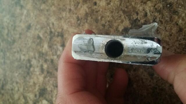

This is the eye that flew off....cheap Japan made junk. Totally stripped out inside.
It's not what life does to you, its what you do with your life!

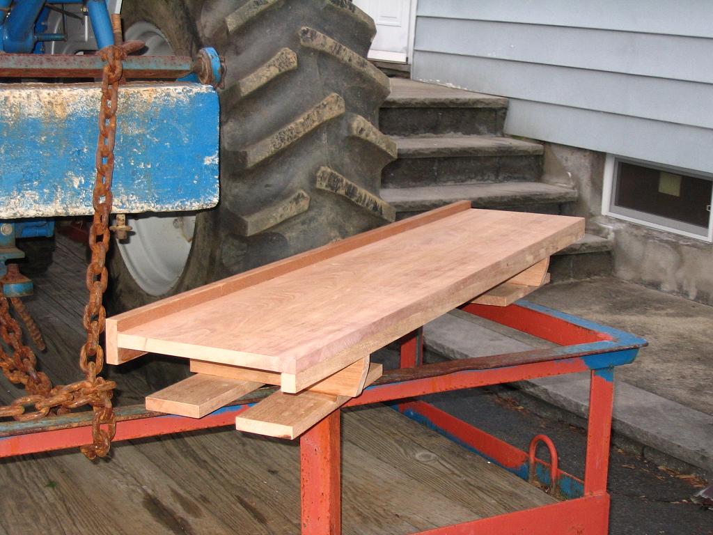

I hand carved a new piece of hardwood to fit snugly and then put a few layers of glass over it.
