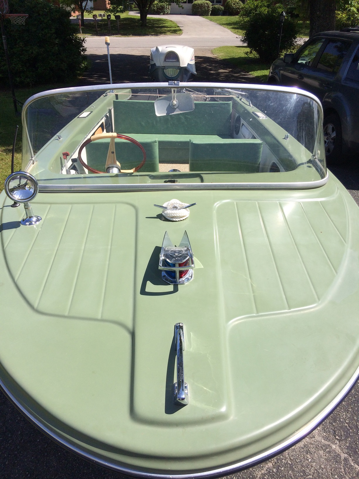

My wife and kids wanted a boat because we live in a coastal town and I have always loved the older crafts so the hunt began. Being an old VW guy (buses and bugs) I knew the style I wanted: as unmolested as possible, two tone, an automotive feel to it, and enough for a family of four. I lurked on Craigslist for a while and found a couple decent ones but for one reason or another they didn't work out... used and abused, hacked up, extensive hull issues, etc. The hunt gave me time to learn about boats. I can count on my hand the number of times I have been out on the water so simple things like how to tie a dock cleat knot needed to be learned. Reading about other's follies like forgetting to put in the drain plug were helpful!

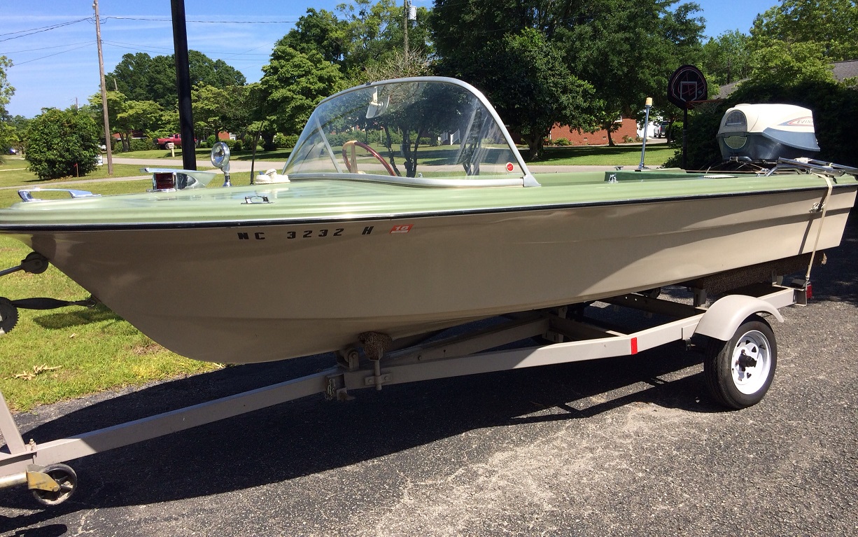

One afternoon I came across a 1964 Dixie boat that had just been posted for sale and was about 2 hours away. Dixie is a brand that is local to the Carolinas but has not been in business for a while. I left after work to check it out... bringing with me the boat buying checklist I found on the internet and a deposit.
The seller said his friend found it in the boat house of a lake front property that had been put up for sale when the elderly owner passed. It had been off the water for 30 years. He was a marine tech and got the original 1964 Evinrude 60 hp resurrected, then used the boat for a few years but wanted something different now. Very original- check. Two tone- check. Stylish- check.
I reupholstered the seats using vinyl found online and foam from a VW camper, rebuild/prime/painted the frames, and added a lot of new stainless hardware. I swapped out the black speakers for silver (not pictured), added a depth finder, added two bilge pumps, tinkered, lubed and tuned, replaced gear oil, found a NOS prop, added scupper valves, cleaned/waxed/detailed it, etc.
The kids are excited and all I have left is to re-stitch the top. The boat resides in a covered storage area on my property and I have no plans to "update" it in any way. The p.o. added the stereo and speakers so I will live with that. If you like barn finds, enjoy the pics!

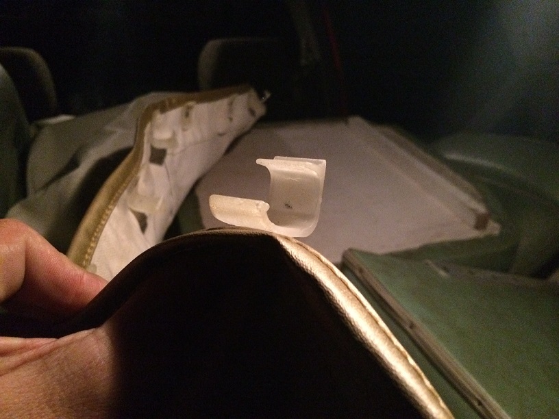

Question- any idea where to get clips like this for the soft top? They are used to clip on to the windshield. I tried the OE manufacturer Taylor Made but no-dice. I may just do snaps but thought I would ask.
Re:Our "new" 1964 Dixie BARN FIND 11 years 3 months ago #110684
I would track down shops that build or repair canvas boat tops.
They would have or know whether or not such clips are still available - or what the options are today.

Yeah, the fuel thing... I guess it is the price you pay to play. It won't be used for long drag out trips though. Mostly tubing and island hopping. It has a 6 gallon tank and I have a 2 gallon reserve. P.O. said about 2 gallons and hour. But this thing wouldn't look right with a gas sipping plastic import buzz bomb anyway! No dice at the local shops r/e the clips. I think I will do snaps.

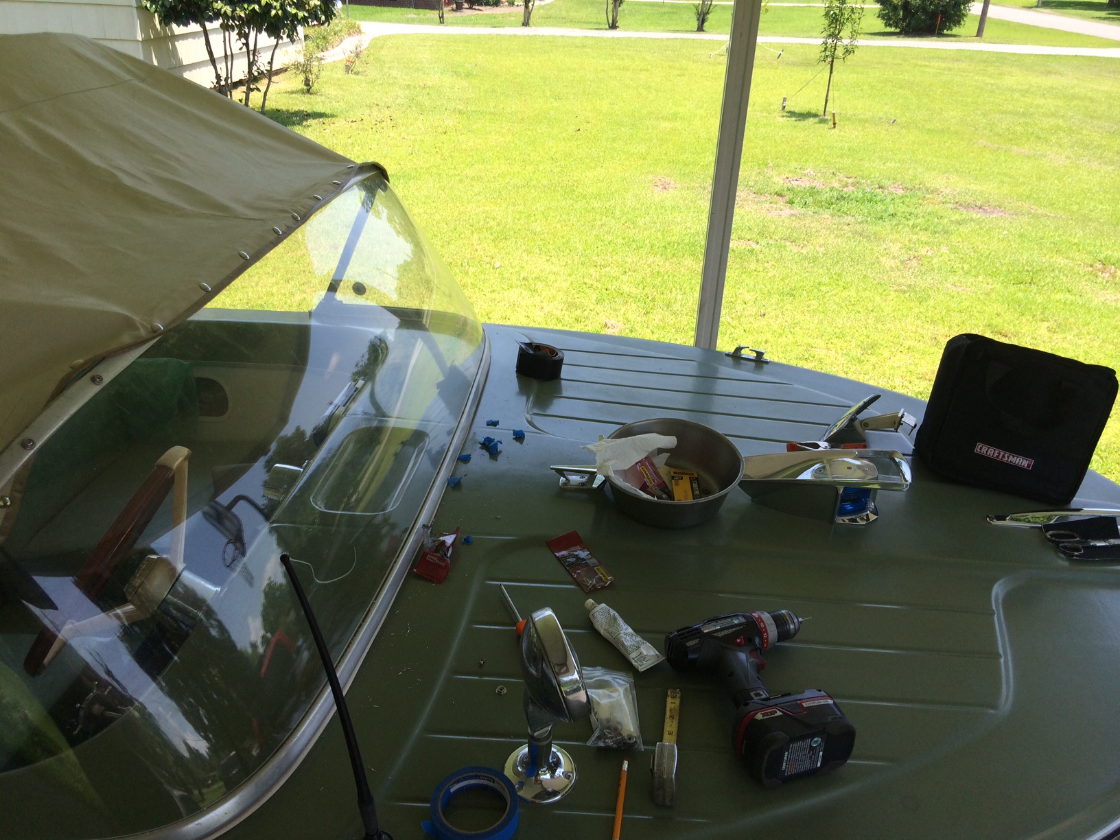

An update- I could not track down replacement clips so I drilled them out and installed snaps on the top and the windshield. After stitching a lot of the seams and treating the stains, the soft top came out real nice. I used a very diluted bleach and dish soap hot water mix, then sun, followed by Iosso canvas cleaner. Just a heads up if you encounter the same issue.
