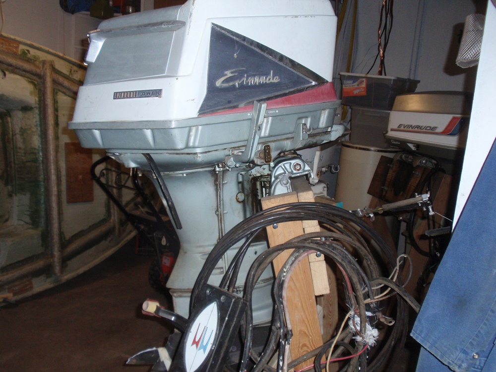

If you're looking to retro your motor I have a '60 75hp starflite that I'm parting out. Still have the fuel pump, carb, magneto, etc. No problem pulling off the downdraft or reeds if you need them. Starter is gone $.
Re: Evinrude Starlite 75 Good bad or better than..... 11 years 3 months ago #110718
I see you have controls too. I will see what happens this Wednesday. Thanks, Dave

Re: Evinrude Starlite 75 Good bad or better than..... 11 years 3 months ago #110835
Dave, what happened Wednesday? Yes I do have the controls, rear cable ends are held in place with small hose clamps though
Re: Evinrude Starlite 75 Good bad or better than..... 11 years 3 months ago #110865
His truck broke down and unable to deliver. Wont be able to escape dealer till at least Tuesday. Dave
