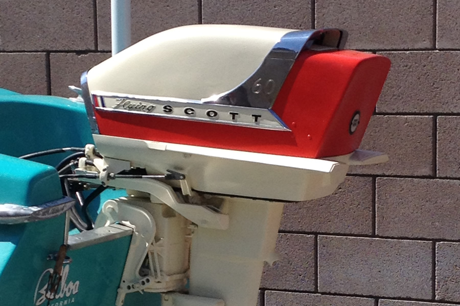

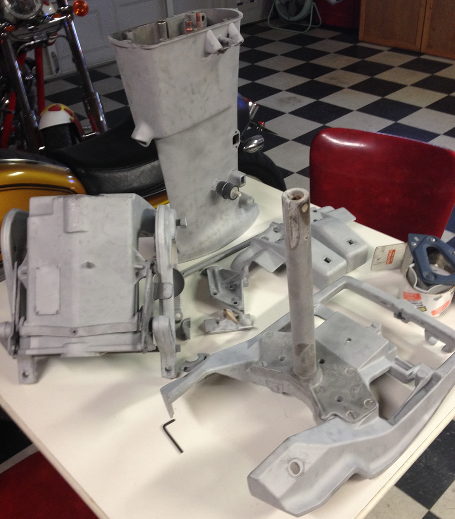

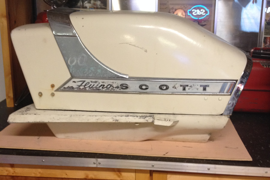

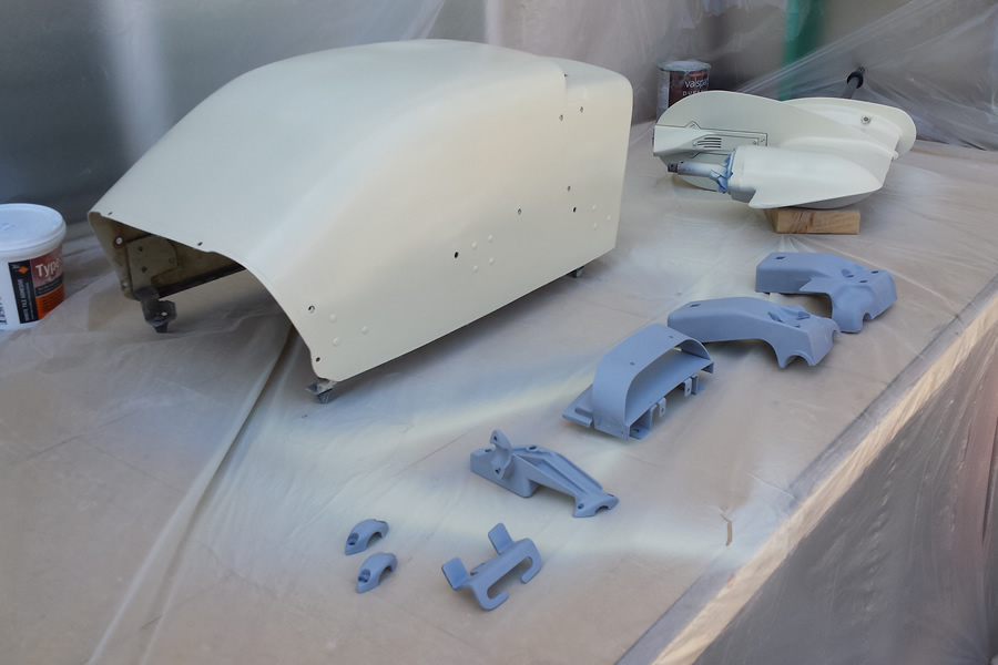

At the end of last summer I started having issues shifting the motor. We've never had reverse but even worse was the shift lever was becoming increasingly difficult to move from Neutral to Forward. I could push it with the cables but it got to the point that I couldn't move the lever by hand when it was disconnected from the control cables. The issue was rust in the shift lever post that runs across the top of the mid section of the motor. Unfortunately to get to this part, the power head needs to be removed. So in the grand tradition of "while-we've-got-it-apart" I decided to repaint the entire motor. Least fun part of the project home glass media blasting with a too small compressor. Most fun part of project turning crusty old parts into factory fresh parts.
BEFORE
AFTER

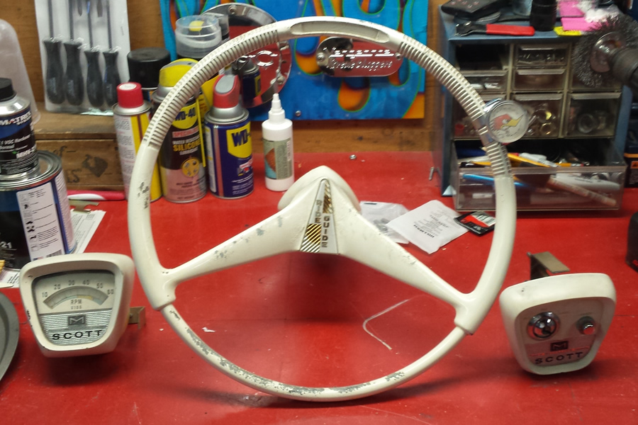

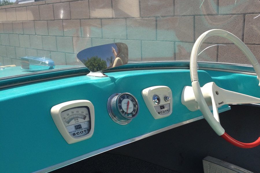

Tip of the hat to Eduardo for the inspiration to paint the Quick Silver steering wheel two-tone.
The good news is the motor is shifting great and I believe I will even be able to back up the boat this summer.
