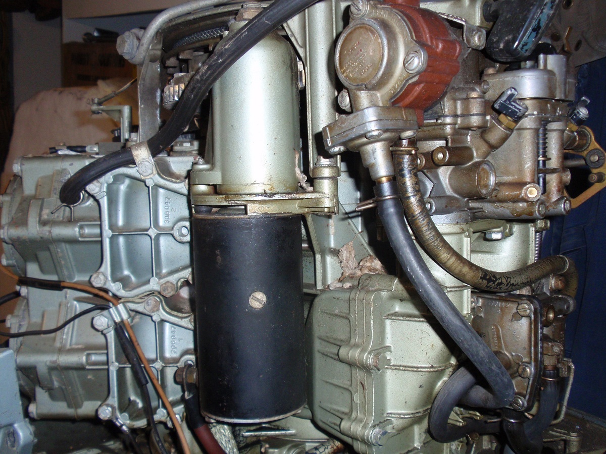

I'm parting out a 1960 75hp Rude. Everything is on the motor now 'cept the starter which was gone on ebay in just a few days. The carb and fuel pump have some watchers but the heads and reeds are all intact still on the motor. If you're interested me PM me. Going to put the recoil and magneto on the net probably tomorrow. The motor was a true barn find and smells like it :laugh:
The starter is gone now but you can see the condition of the carb area.
