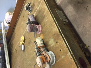

Rachel welcome aboard. The round 5" orbital sander is my "weapon of choice" these days, I've found it works much better that the rectangular pad sander I had been using. Mine came from Harbor Freight which can be bought online, but any local supply house should have an "economy model" that would work just fine. Name brand better quality models will last longer especially if used regularly, but for hobbyist usage the cheaper units usually work just as well.
I usually start with 150 grit and work my way back to 220 or 300 grit. Just depends on how much material you have to take off. A small 4" or 4 1/2" grinder with 36-40 grit flapper discs also comes in handy when you have a lot of clean up to do removing old glass work, fillets, etc..
The oscillating "multi tool" will also prove a very valuable and useful tool, once you get one and work with it for a while you'll wonder how you ever got along without it.
Some folks have good success grinding out the "crazing" (spider cracks) into a v shape and filling with marine filler and fiberglass strands for reinforcement - commonly called kitty hair. Others find grinding the gel coat down to bare fiberglass then fairing it out to be the preferred method.
Make sure you wear a respirator to protect your lungs, and some good safety goggles for the eyes - the fiberglass dust can wreak havoc if you inhale it! When heavy grinding is in order you may want to invest in a couple of tyvec suits, they help keep the dust off your skin. That stuff itches like crazy especially if you're sweating when exposed. Good luck, take plenty of pics and don't be afraid to ask questions - we're here to help!

As far as sanders go everyone will have there favorites. Here is what I recommend.
If you have a very good air compressor you can use a palm sander or a DA. Takes a good compressor to keep up with these tools.
Next there are many many electric sanders out there. I like my electric better than my air. Less noise for the main reason other reason if your friends happen to be foolish enough to want to help you sand you can run more sanders on electric.
The big box stores have what you need. But get a six inch variable speed. Rigid is one kind I have it was less than one hundred dollars works just fine but does have Some vibe ration. My favorite is a Bosch ROS65VC. VERY little vibration vacuuming system works pretty good. You can sand all day and stay clean and your hands do not hurt when you are done.
All these have a hook up to hook to a vacuum system.
For grinding gel I use 36 grit if you can find it. But 40 grit is easier to find. Make sure you get the correct paper for the sander you buy.Most will be hook and loop. But be sure to get paper with holes in so the vacuuming works.
If you have trouble places that sell auto body supplies have or can get you what you need. Paper is not cheap you may want to buy a box of it usually 50 pieces to the box.Check out paper on line to.

Awesome advice. Just do not use a belt sander!
I'd also suggest using the finer sandpaper (150 - 200 grit) to practice with before you actually start grinding. Even 150 can get you into trouble quick depending on how thick the gel coat is.
The heavier (lower number) the grit, the faster it works, and so the quicker you can get into trouble so be careful.
DA sanders (Dual Action) work great. As mentioned, for most of these, HF tools can work just fine. The one thing I would not cheap out on is the sandpaper. The quality stuff, i.e. 3M and folks here have mentioned others in the past, makes a big difference. Take it from a cheapo. for many years I used crappy paper until i read on here otherwise. I got the good paper, at about 1.5x the price, but it lasted WAAYYY longer and worked better.

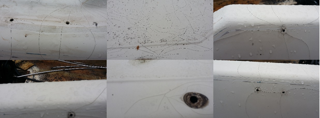

looks to me like you will have to take most of the gell coat off to get those cracks out....you will either have to re gell coat or paint, so no need to compound until it's repainted....I would go with a 6" da sander...john

Here's my 2 cents! Spider Cracking is one of the most problematic issues for gel coat repair. If you want to ensure longevity in the repair then you must either remove it all and start from scratch or at the very least repair each individual vein of the cracking. The latter is very tedious and time consuming and does not guarantee that the cracking will not reappear. If you have extensive areas of deep spider cracking then total removal of the gel coat and re-application would probably be your best bet. If the SC is more isolated then Spot Repairs might be the way to go using a V-Bit and a dremel tool. If you decide to remove it all then a 4 1/2" grinder with 36-40 grit resin coated discs would be my tool of choice. You don't have to "Baby" the gel coat. You want to get it off and down to the glass as quickly as possible. The underlying glass is pretty tough stuff and the 36 grit abrasive is not going to do damage to it. You'll be able to see the glass and know when to move on. It'll be a pinkish color. Proper PPE IS required. The Dust will be incredible and you don't want to breathe it. A full Cover Tyvek Suit, with gloves and goggles are a must as well. Again, just my 2 cents on how I'd attack the situation.

The dremel tool approach works sometimes...sometimes it doesn't. For some reason, the spider cracks seem to reappear under dark paint...black and navy blue. Maybe the heat? Whatever. Flamingo has the foolproof approach: remove all of the gelcoat. A few things to remember:

After you remove all the old gelcoat down to bare fiberglass, you MAY find that the wasn't the WHOLE problem.
MANY of "our boats" are nearing 50-70 years old & MAY have stress cracks that go into the fiberglass, as well as the surface "spider cracks".
IF that is the case, clean out the cracks & fill them with a coat of un-thinned epoxy resin, followed with epoxy thickened to the consistency of heavy cream or "peanut butter", allow to fully cure & sand down to a smooth finish & then refinish with your choice of paints.

A few things to note. Since your boat is an 87' model I doubt that the spider cracking extends into the fiberglass but, if it does, and you want to re-coat the boat with Gel Coat I would not recommend using epoxy to fill the cracks. Gel Coat is not very compatible with epoxy. Since Gel Coat is a polyester resin based product you should use polyester based fillers to do your repairs. If however, you want to Paint the boat the epoxy would be a good choice to do the repairs. If you choose to just dremel out the SC's and repair them then just mix up some Gel Coat paste (Gel Coat thickened with Cabosil) and after washing the cracks with Acetone fill them with the paste and then sand smooth with 220 grit. For sanding the rest of the boat I'd recommend starting wet sanding @ 600 grit using "Wet Water" (Water with dish soap in it) and progressively working up to 1000 grit. Then use a power polisher with Polishing Compound. She should come to a nice high lustre doing this.
