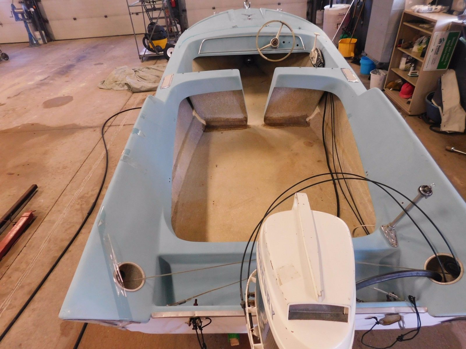

So, this Tomahawk SkiMate was an impulse buy. What I know about boats would fit on a grain of rice. The fiberglass all looks solid, no cracks, no softspots. Now that I'm doing research I keep reading about rotted wood between the layers of fiber glass. Does anyone know if there is any wood in this Tomahawk? It appears to just be single layer fiberglass with the exception of the flotation boxes and a small area around the foot area in the bow. The transom seems solid and only has one area about the size of a 2x6 that could be wood.

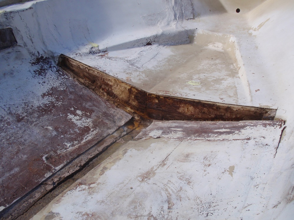

Transom replacement.
May be a wood kick panel in front, drill this also to find out.
This one was rotted plywood that was replaced.

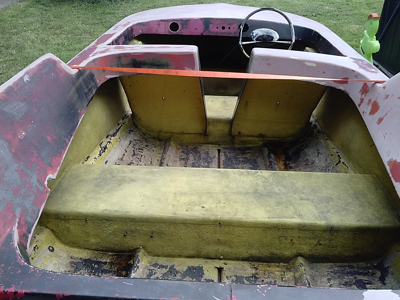

But I'm curious about the construction of these old Ski Mates. When I look online, it seems like fiberglass boats from this era typically were made from plywood encased in fiberglass, and also utilize wood stringers to give the hull support. Is it accurate that these SkiMates really only utilize wood for the transom? Is the hull truly all fiberglass and no wood?
I'm curious because I am restoring this same model. Unlike the images attached in this post, my 1958 Ski Mate has a built in subfloor and no molding for the rear bench seat (example image attached).
When I purchased the boat, I did not realize there was water trapped between the subfloor and bottom of the hull. And yesterday I found water weeping out the outside of the hull where it sits on the trailer roller.
I am concerned now about the amount of moisture trapped under the floor and the extent of wood rot and fiberglass delamination. Knowing more about the wood content and construction will help me decide what the next steps should be.
If anyone has insight, advice, or words of wisdom... I would greatly appreciate the help!
