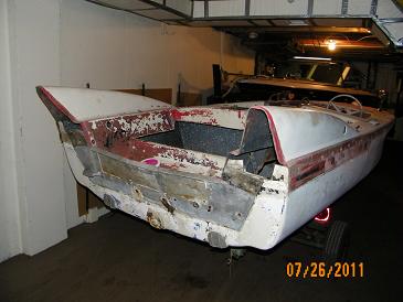

I've been on this site here and there as I am coming near to completing a "57 herters flying fish. The boat itself is pretty much complete and the motor is going to be ready in a few weeks. I'm looking for assistance with a few parts and some help setting up the cable & pulley steering as it was not connected up when I originally started working on the boat. I purchased a Kiekhaefer steering wheel but it did not come with the pulley on the back to wrap the cable around for the steering so I would be interest in tracking that unit down. As well as looking for help setting on how the proper way is to set up the cable & pulley steering. The motor going on the boat is a 1957 mercury mark 55

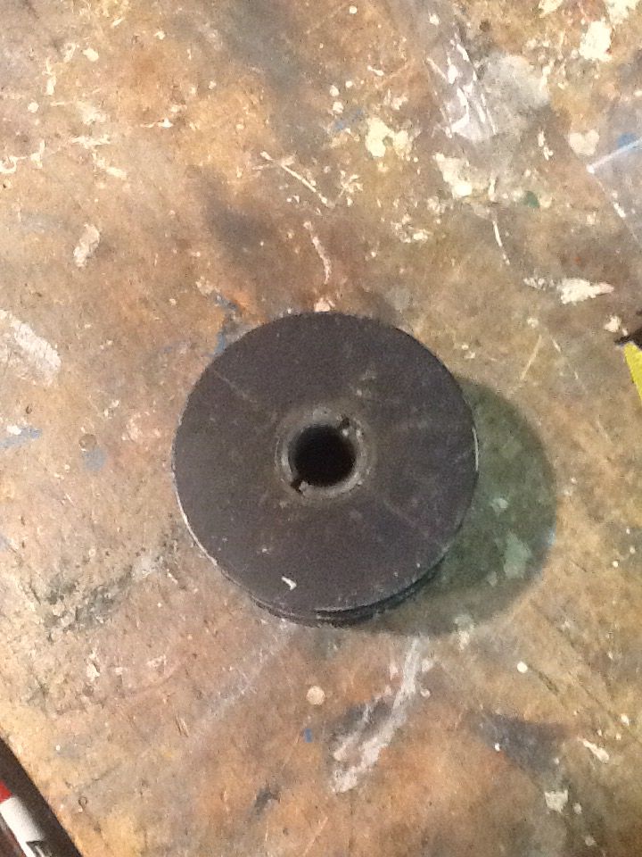

I might be able to help you out. I. Have a pulley from an old Atwood steering wheel. Don't know if it will work with what you have though. Has a 3/4" center hole and is 3 3/4" dia x 2 1/2" h.
-Brian

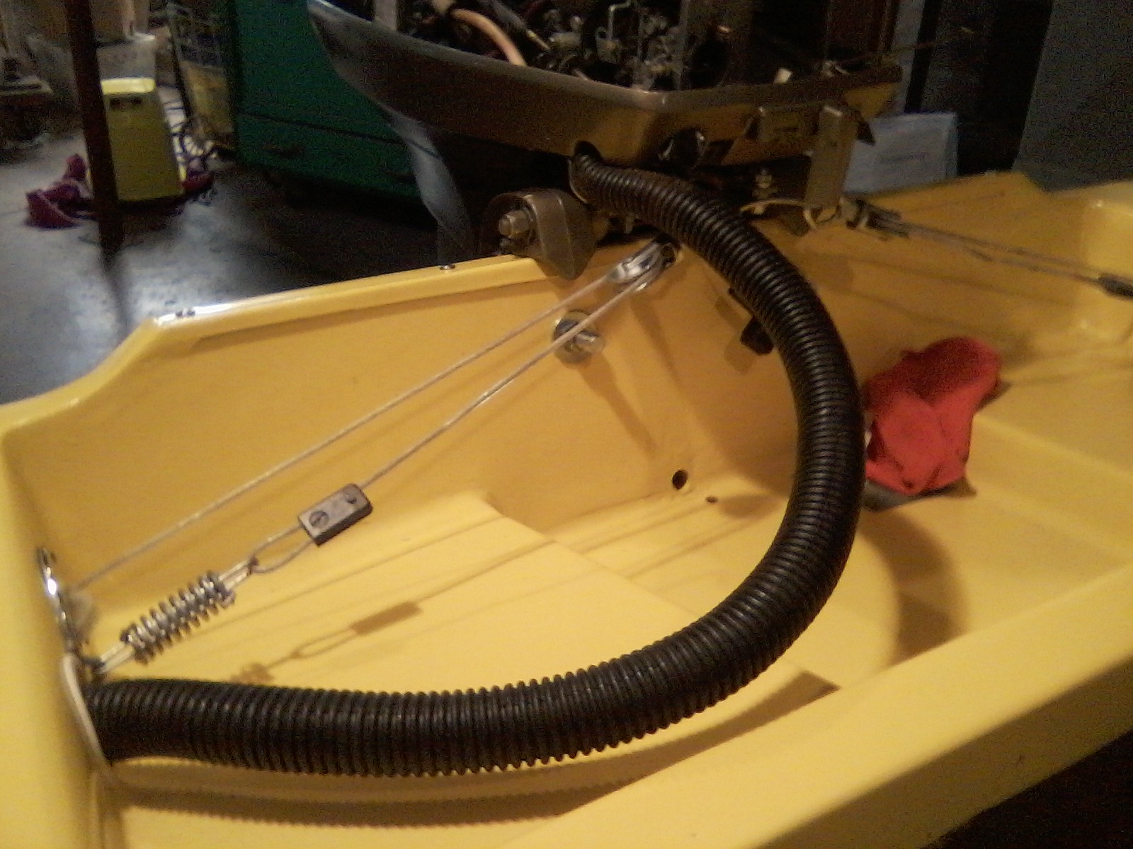

Here's how I connected the motor portion of a cable system.

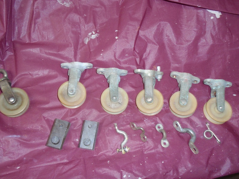

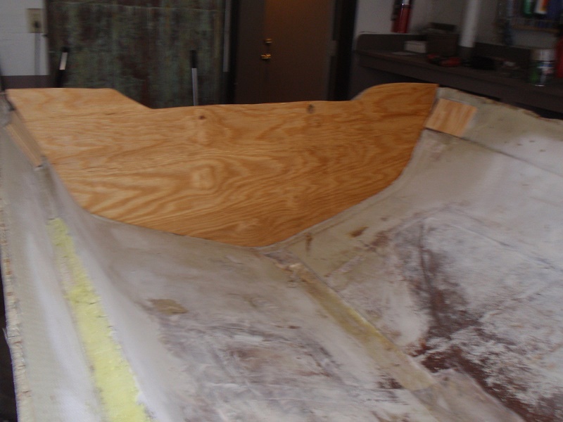

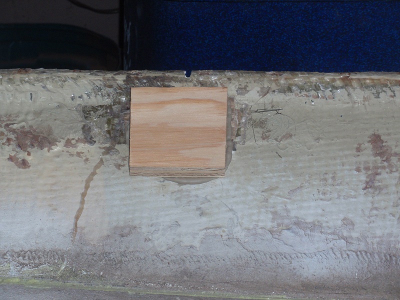

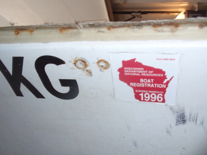

This is all I have left in my stash. Not for sale though, sorry. They are all period correct. Solid brass with perfect pulleys but they would be what you might be looking for. also the anchor loops for the cable ends and guide for the cable under the gunwale. I'm in the process now of putting in new anchor points for a cable system on a '64 Lone Star. 3/4" ply for backing. The front and back pulleys will be through bolted from the outside through the backers to prevent the bolts from pulling through the fiberglass hull. First picture is the front 3"x3", second pic is where the old bolts went through the hull. Last picture is of the new transom and you can see where the back pulleys will be placed. Everything has to be glassed over yet. Still working on that today. Final picture is of the pulleys et al.

thanks guys, I was looking on the boat and I see a space where there looks like there were pulleys. 2 along 1 side of the boat and one along the other. this boat was set up with steering wheel on the port side so there are 2 spots on the port side. 1 up near there steering wheel and 1 in the rear and starboard side only has 1 near the rear of the boat. I think that's whats throwing me off the most right now. Also was looking at steering wheel that I currently have and it looks a little on the big side for me to be able to get underneath so may be looking for whole new setup(steering wheel and all)... i'll see what I can do to update some pitcures
