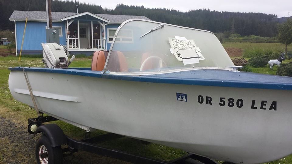

I just purchased my first boat this last week. I bought a 1956 Blake Craft 14ft fiberglass. It has an older Evinrude Seahorse 18 attached to it. It also came with 3 or 4 hornet nests! What a deal! :-)
Seriously though. The boat itself appears to be ultra solid, just in need of a good cleaning, and some new paint to make it pretty. The floor looks to be redone in the last 20 or so years, and there also appears to be some additional bracing that has been glassed on the transom. I have big hopes and dreams for this thing. I need to dig the pressure washer out and clean it up and hopefully the wasp/hornet nests are dead now (Turbo bug killer applied).
After I get it cleaned up I want to take some pictures of it and hopefully pass a visual inspection of the experts. I am trying to figure out what to do for a motor, but I honestly have NO idea what the boat is rated at, what speed it will reach plane (with an 3/4 load whatever that may be) and what type of motor I need to buy to just exceed plane. I'm not concerned with going 100 mph, but I would like to see it plane and zip wherever I need it to go respectfully.
Some basic things I measured. the transom height where the motor mounts is about 16 - 17 inches. the widest part of the boat hull is 62 inches at the top. and it's 14 feet long plus or minus a few inches because the tape measure wasn't being cooperative. This one I have does have a windshield (Has a small crack, but it's not bad) and a steering wheel with cable pully clothesline type steering mechanism. It also has the 2 lever throttle and gear control. (I was planning on updating the throttle and steering with the motor)
I'll get a few pictures of it up here tomorrow, but I don't know the lingo, but I'll give it a shot. Should I cut the transom apart and replace it, should I try and seperate the cap from the hull to do my cleaning. The floor doesn't look pretty at all, but it seems to be "mostly" solid. What are the things that I can look for to identify any issues. I wanted a summer project and this to me sounded like a great idea and a lot of fun. I never worked with fiberglass, so it's all a first for me.
I know this is like asking what everyone thinks I should make for dinner, without telling you what I have in the cupboards, but I am hoping for some direction. Maybe with some help knowing what to take the pictures of, I won't destroy this little boat and I can restore it for another good 50 years of fun.

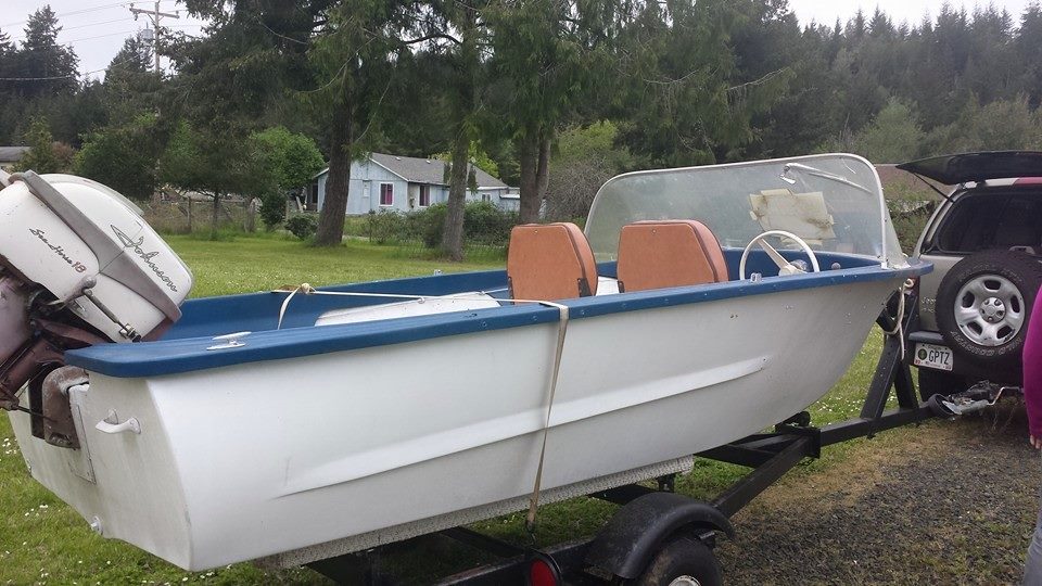

Welcome aboard and nice find. She seems to be in good shape from the outside pics anyway. To check the transom you can drill a 1/4" hole toward the bottom inside but don't go all the way through. Look at the shavings coming out, if they're black, not good, probably rotten transom, if they're bright colored you may just be fine. You can always mix up a little epoxy resin and fill the hole you made.
Nothing wrong with cable steering, I have that on mine but I wanted to keep it original. If you don't care about that then change it out, just know that you'll probably have to change out the steering wheel if you change to say a Teleflex system.
As far as motor size goes, I'd say 35/40 hp max probably but I'm just guessing, other more smarter people than me will jump in here.

Judging strictly by the pictures I'd suggest that the boat is actually from the early mid 60's. A 1959-1964 35-40hp OMC would be a good choice for power. The 2 stick controls will work fine with any of those. As far as the cable steering I'd simply re-do the cables, make sure that everything is well anchored and stick with it. I just installed the cable steering in a plywood boat project I've been working on and it just looks so much more correct in an old boat.

The two lever OMC will fit with a zillion Evinrude or Johnson motors for a large spread of years. I like the cable steering setups, their easy to maintain and won't rust up as some of the older push/pull cables I have seen. I would suggest you get on your back under the bow deck and check out the pulleys and cable. The pulleys sometimes when they get old will chip on the edges and gnaw away at the plastic coating of the cable. Make sure the pulleys are attached to the hull solid, most systems are actually bolted through the side of the boat with a small "U" shaped thingy and then the pulley is hooked onto that. Don't forget the transom end pulleys also. Last thing you want is to lose your steering while on the water doing a hundred mph. That 18 Johnson you have if running is a workhorse, take care of her. I actually learned how to ski behind one of those back when they were new....no comment. A mid 60's 40hp Rude or Jonny would match that boat perfect.

1. KEEP the cable/pulley system, as they are perfectly suitable to the use, the CORRECT system for the period & cheap to repair.
2. While the 18HP Johnny is perfectly fine for fishing/"messing about", I would look for a 1956 Johnson JAVELIN or an Evinrude LARK (both are 30 HP) engine as they are NOT all that hard to find, correct for the year of the hull, have plenty of power, are simple to work on yourself & the OMC BigTwins are so over-engineered that they will outlast you if properly cared for.
