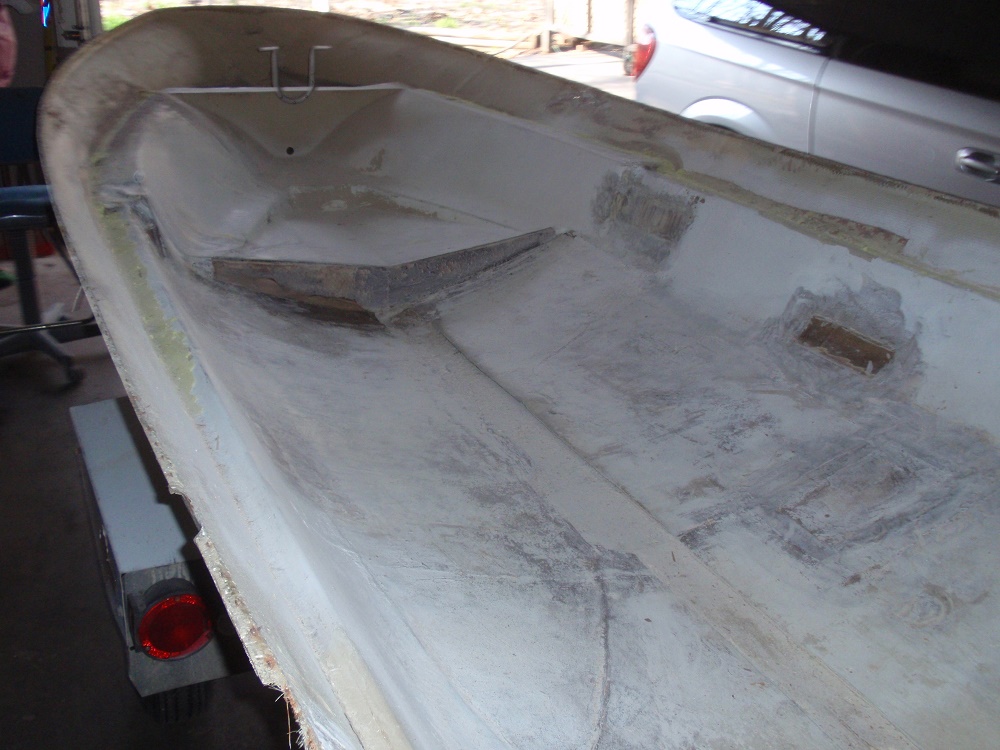

Seems I got myself into another project where I learn by doing. Bought this Lone star Mystic from a salvage yard with a EZ loader trailer, and "58 Johnson super quiet 35hp for $250. First glass Lone Star that I've attempted. Find out there is no frame! It's what they touted as "sandwich" design. Glass hull, about 3" of foam and a thin glass inner lining, no keel board or anything. Nothing to build off of so everything will have to be glassed to the inner shell. Got the transom removed, only wood on the entire boat. Should be interesting.

Thanks for the reply. This "project" is almost as bad as the Herters I did a few years ago. I'm plowing through it one day at a time. Have the topside upside down on the garage floor now repairing glass splits and putting in a new dash backing board. Going Red over white.

What did you do with the inside bottom? This one was soooo bad and cracked up I had to to glass the entire floor area and put in a new layer of 1/4 plywood and then another layer of glass. I made up new strip flooring like Edwardos' pics.

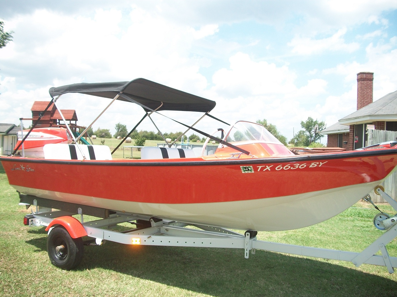

I can't get my pics to upload?? I seen a picture of my boat someone posted on an earlier fourm. It is the orange and white.

Other than that, this mystic was a basket case. Glass cracks all over the place, topside, interior, transom well etc. I think it was underwater for some time because there was sand and small gravel in places it shouldn't have been.

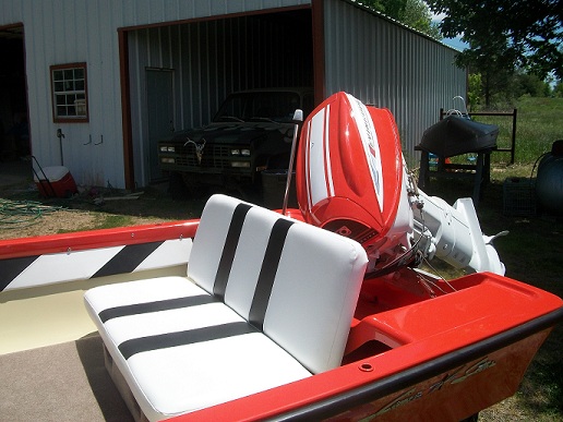

Re:Lone Star Mystic 11 years 2 months ago #111070
She's a beauty. That pic will get printed and put up in the workroom. Same color scheme I'm going for. I'm thinking of doing the original back center seat though.

yes that's the only thing i didn't keep orginal. i wanted to go for something a little more family oriented and safer place for kids to ride.
