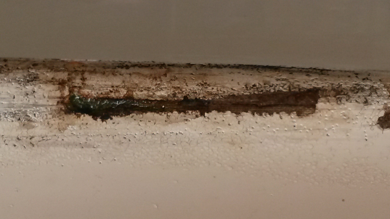

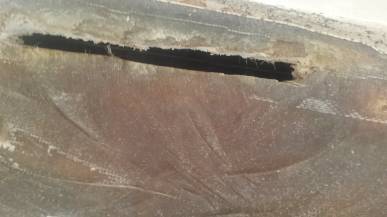

when working on my trailer last night I noticed a drip coming from the bottom of the boat . At firs I just thought it was a drip from the drain plug running under the boat. Upon further examination I found this. It is about 4 inches long on the side of the keel just forward of the aft keel roller. I did gently run aground the last time I had her out 2 weeks ago (actually drifted aground while fishing, What would be the best way fix this?

dry it out.. grind it down and patch it up.. if you know how to work with glass its not a hard fix..
Re:Hole in the keel 11 years 4 months ago #109029
There is a pictorial on fiberglass repair in the Research / Restoration section Hustler, here's a link;
www.fiberglassics.com/restoration/fiberglass-repair-pictorial
Definitely park her with the bow up and drain plug(s) open for a while, really do you best to get the bilge and under-floor areas dried out.
Re:Hole in the keel 11 years 4 months ago #109039
The other thing I would worry about is if the keel is waterlogged and rotted or starting to rot. Like Mark said, raise the bow, pull the plug and let any water drain out. Watch to see how much is in there. Hopefully not a lot. That's a good link to glass repair that Mark posted.

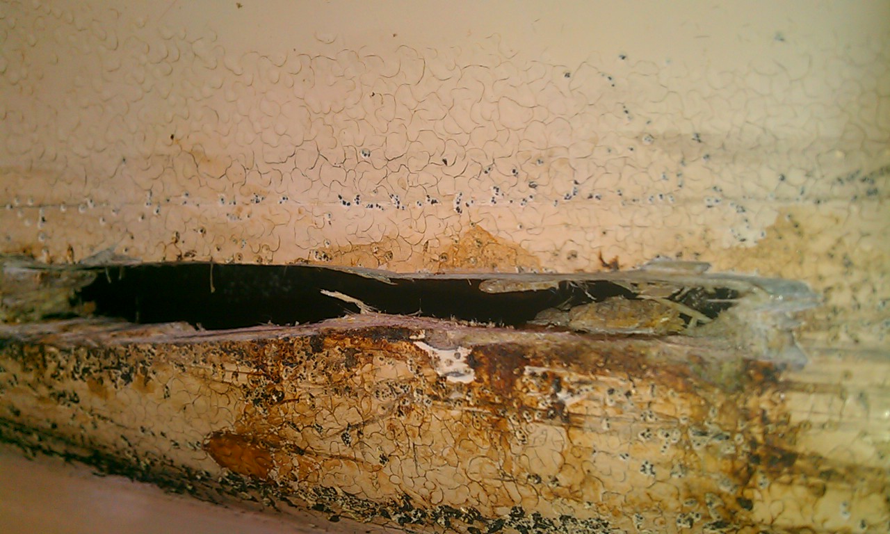

I have a similar problem. It is from one of those pesky rollers. The roller was set too high and the boat was actually cantilevered over it. Very bad situation. Anyhow, same as you, I noticed drips of water coming from it. I put it up and drained what I thought to be all of it, but I think water is trapped between some of the stringers. I used a shop vac and made a seal over the crack to suck out what I could. Seemed to stop the dripping. I'm going to 'V' out the crack with a grinder, lay in some thin woven glass pcs when the resin is almost kicked off (since it is upside down), then go over with new resin. I'll use West Systems since that is what I am used to working with. Any other ideas for upside down glass work??

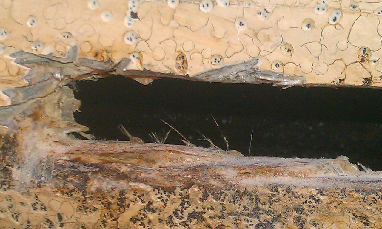

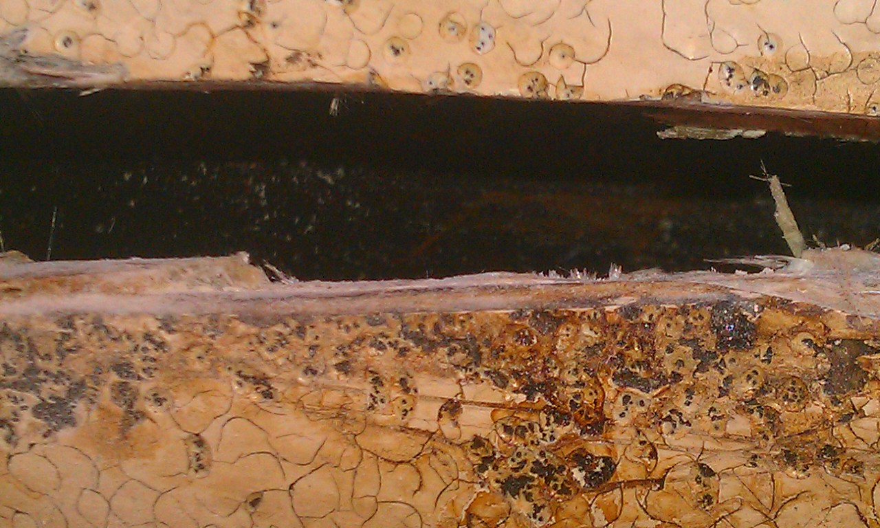

I opened it up some more and got some more water out. I thought it was dry but found a damp spot and pushed a 1/4 in drill bit through the fiberglass and got a steady stream of water for about a minute.
Should I cut out the fiberglass still in the gash?

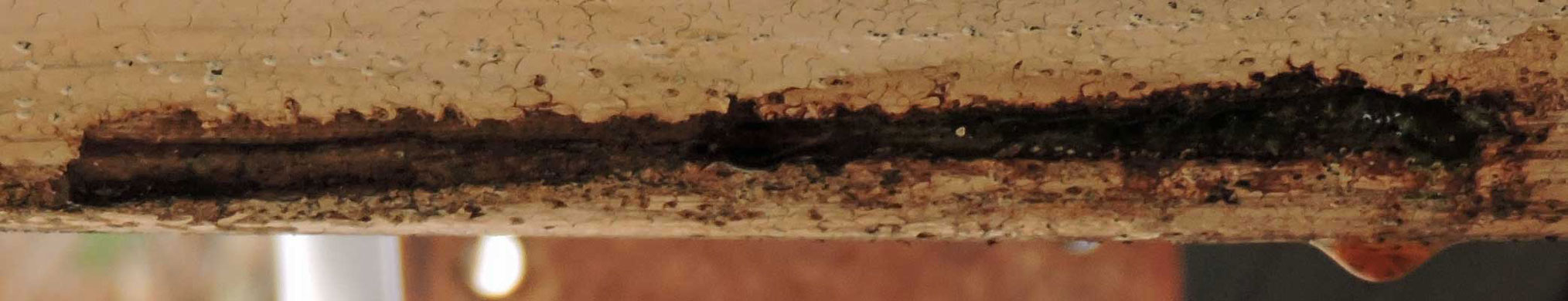

I opened it up some today. It was perfectly dry inside. however I did not find a wooden keel like I figured I would, just excessively thick fiberglass. Is it possible they did not use a wooden keel or stringer here. There is a board about a half inch above the fiberglass. I looked inside with my inspection camera and saw no apparent rot or water.
I still need to grind it smooth and clean up the inside cut with a smaller cutting tool.
My next question is how do you lay up 1/4-5/16 inch fiberglass without access to the backside?
Re:Hole in the keel 11 years 4 months ago #109399
The plans I am thinking about a very similar to patching a hole in drywall. I would make up a curved tool of some kind to clean up and scratch the inside edges, dry it up, cut or make a patch of glass mat in a separate tray that is slightly larger than the hole but easy enough to slip through at an angle. Put a small screw in your new "patch" to act as a handle for you to manipulate it. Slobber some resin on the new patch edges and pull it tight to the inside of the hole and figure out a way to hold it in place until the resin kicks. Remove the screw and then use the mat/cloth method to fill the dent.
Here's a link to patching a drywall hole that can probably explain this better than my rambling. Just put up with the commercials :laugh:

Same thing here......was tired of watching the 'drip', so I hit it with a 1/4" drill bit. Steady stream of water for about 30s. I put a level on the keel and adjusted the trailer jack until it was level to get most of the water out. I keep adjusting up and down periodically to get it all out. I'm also running a dehumidifier next to it.
Found out that some fiberglass boats actually had a tube running along the bottom for water drainage. Anyone know anything about this? Thx.

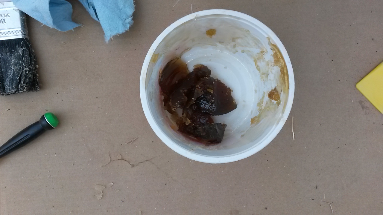

Question on making peanut butter. Can I cut the ends of fiberglass mat in 1/4 inch lengths for the filler? I can't find any chopped glass like the videos I have found show. I am planning on using short strands and sawdust for the filler. I hope to be able to work on her Sunday. Tomorrow I have to do a photo-shoot for a local car show.
Re:Hole in the keel 11 years 4 months ago #109561
I've cut up CSM for filler before, worked pretty well. I can't say about the sawdust, but I did try the ag lime and it worked well.

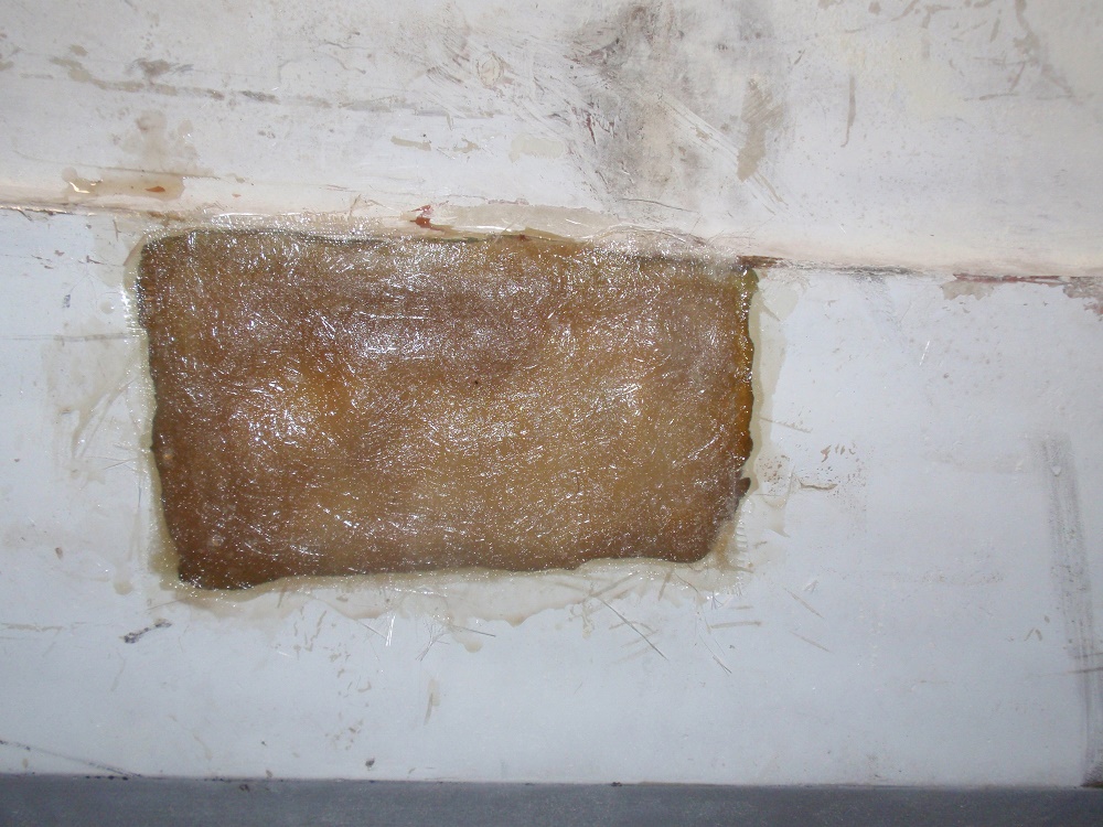

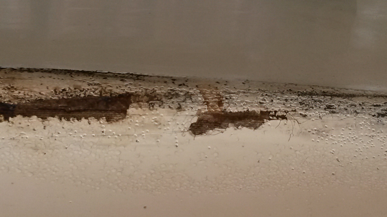

I feathered it out but I think I went to deep. The curve caused the grinder to dig in. I also think that I need to make the hole larger so I can sand the inside of the hull.
Re:Hole in the keel 11 years 3 months ago #110343

Hustler, you're doing good! With that much raw glass showing IMHO you'll have a good bite on the situation. When you start laying your mat some of it will no doubt ooze into and around that opening and be an anchor on the back side. I patched a hole that was 7" long and 4" wide a few weeks ago. Alternate between layers of mat and cloth. I think I put seven or more layers each one larger than the succeeding one and gradually build out to the original surface. You can do wet layers so you don't have to wait for the resin to set. In this picture I used a flat board with 60 grit paper the next day to fair it down and then used Bondo LONG STRAND to fill in the little dips.
One has to look hard and know where the hole was in order to find it.

Well I finally got around to it I made the first patch last weekend but it didn't turn out too god I think I made it too thick I used one more layer of mat to make it better. so I remade the patch yesterday but it was too large it met the size quoted as 2 inches larger but then it hit the inside bottom of the keel and wouldn't lay flat against the hull so I ground down that side this morning. I then made up my PB out of cut up mat and cabosil it was a little hairy compared to the pictures I saw on U-tube but it was PB consistency. I am now waiting for it to cure for the one hr.
I admit I was a little scared that is one reason it took so long. I am such a perfectionist. But then as my wife says, I get frustrated and make it worse. so I decided to just do it.

Well I got at it again. But I need to go buy some more resin.
I cut my eight layers and had it all sanded down. Mixed up my resin and harder. I bad to layers laid down and went to wet out the third, when I stuck the paint brush in I found this.

Looks like too much catalyst :laugh: to me. Either that or you have to step up the pace somewhat. I usually mix 2 to 4 oz or resin at a time so it won't kick in before the end of the job. The ratio I use is 12 - 14 drops of catalyst to each ounce of resin. If it's a hot day use a few drops less. I use a glass Pyrex measuring cup for the resin, pour it into the mixing pot and then add the catalyst, mix with the brush and start working. Should give you 10 to 15 minutes of working time.

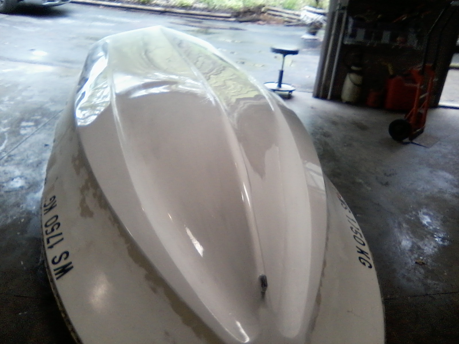

Finished her up on Saturday. I still have a little bit more sanding to make her look really nice but then I would end up doing the whole hull. I used some Rustoleum outdoor furniture spray paint made for plastic to paint her I couldn't find the Rustoleum paint they talk about on here at Lowes or Home depot but then again I couldn't find a sales person either. At least not from that department,
I took the boat out on Sunday and the patch worked great. The paint is still on and no leaks. Well at least she didn't sink.
Re:Hole in the keel 11 years 2 months ago #111626
Glad we could help. You will not have any problems with that patch, probably stronger than the rest of the hull that is unless you run up on sharp rocks.
