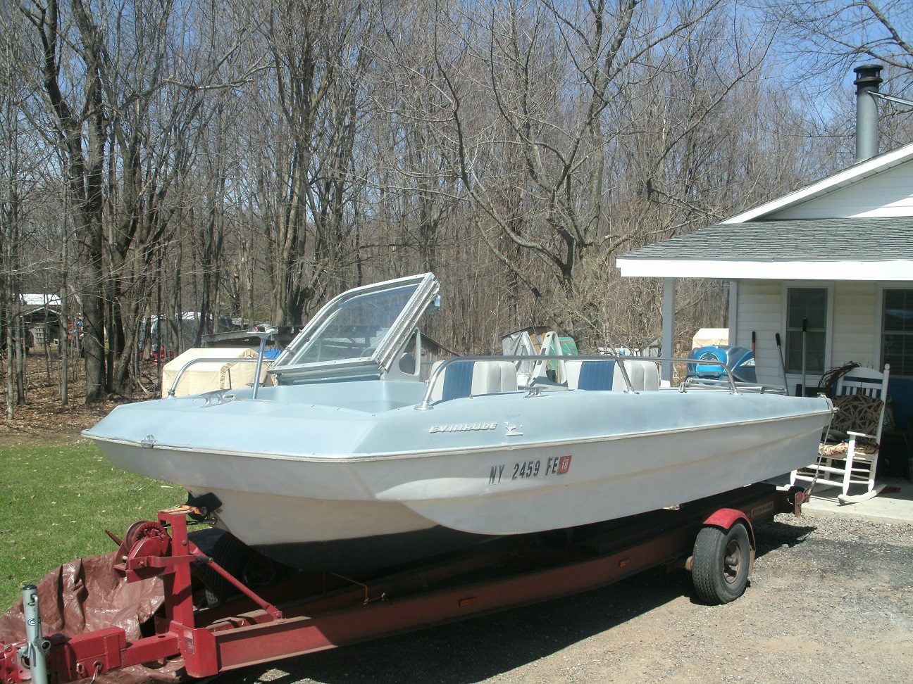

Hopefully here is a photo of it

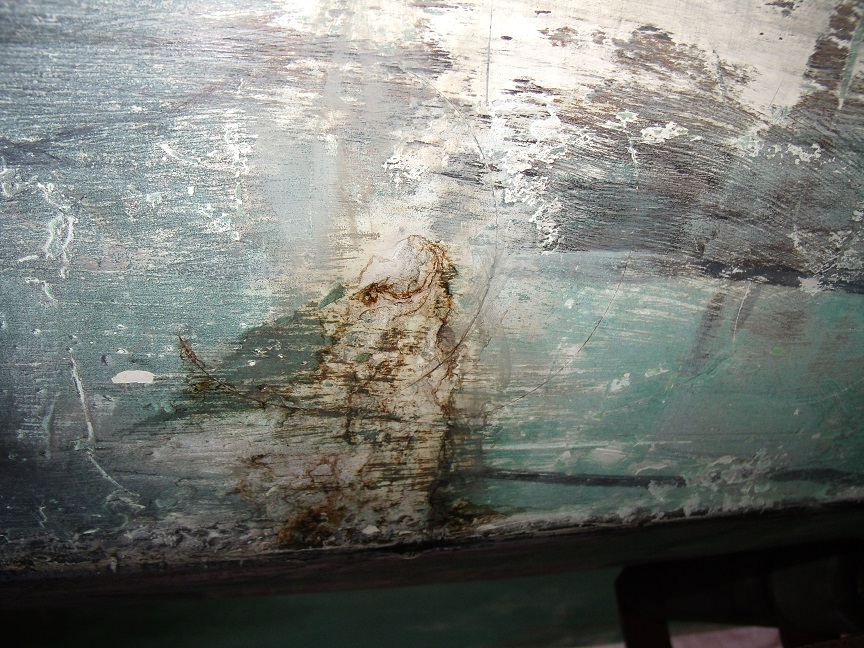

Patching fiberglass is a DIY'ers easy smeazy project. Post up some pics of the areas needing repair and we can help you thru the process.
Re:1964 Evinrude Sport 16 11 years 3 months ago #110409
Hi Flamingo,
I was figuring it might be a fairly easy job, but getting the water out is kicking my butt, and my wife doesn't want me grinding away at the hull because of the lead paint being around our little ones. Anyway, I started out by drilling a 1" hole in the floor near the plug to hopefully get the water to drain from the hull and out the plug. I was really surprised it didn't have a way to drain the hull. The foam is really slowing the drainage though. After I get it drained I was thinking of taking it somewhere to do the grinding and cleaning away from kiddos. There are five or six spots running down the keel where the water is coming out. And the big problem is there are a lot of holes in the floor I didn't know about until now. I think I may end up cutting some 1/4" ply to fit the floor and then lay glue it over the top of the existing floor and cover it all with some non-slip material or something.

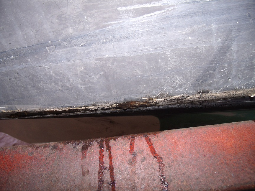

Re:1964 Evinrude Sport 16 11 years 3 months ago #110410
here is another spot

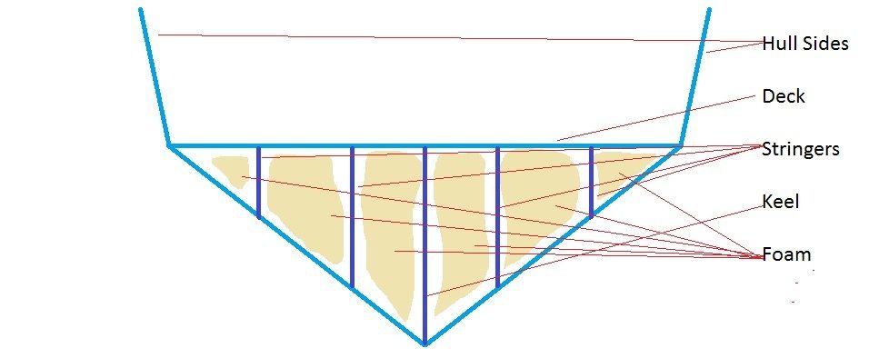

Ok, the Floor/Deck of the interior of the boat needs to be totally removed to expose the stringers, bulkheads and foam that are below. Then all of that will need to be ripped out and removed all the way down to the glass hull. I'm guessing the transom at the rear of the boat will also need to be removed and replaced as well. I seriously doubt that there is any "Lead" based paint in your boat. I wouldn't worry about that but...You do need to wear the proper PPE anytime you're working on the boat because fiberglass and any dust is NOT healthy to be breathing for anyone!!! I highly recommend a full cover Tyvek suit and a full face respirator. Also if you dust yourself down with baby powder every time before you do any Fiberglass sanding or grinding it'll really help keep the "Itch" off!!!
I'm really not sure what I'm looking at in the pics you posted. Close ups are good in some cases but backing off to give a bigger perspective is also helpful at times. Normal construction on boats of this vintage is kinda like this drawing...
I truly believe your boat is going to require a total rebuild in order for it to be seaworthy. I believe the foam, below the deck is totally water saturated, and will need to be removed and replaced. It cannot be dried out. It is adding Hundreds of lbs of additional weight to the boat and has rotted out the substructure of the boat and this structure is critical to the overall safety of the boat. IMHO to do this job correctly you'll be looking at approximately 100-200 man hours of work and about $1,500 to $2,500 in expenses depending on how much damage you actually find once you get all the demolition done

Thanks flamingo! The photos I added were of the keel on the center hull. I am in the process of draining it out now, which is taking forever because the foam is refusing to let it go, and I am thinking this is above my means. I am just not prepared to rip the floor out and the foam and the stringers, which I think are beginning to rot. The transom seems clean on a positive note. I drilled into it and got nice bright shavings, but this is proving to be above me. I was thinking of throwing to caution to the wind and doing a band aid patch, but I live on Lake O. No way I am taking it out with out a real repair being done. Would be different if I had any skills and/or a place I could work away on it until I developed the skills.
Re:1964 Evinrude Sport 16 11 years 3 months ago #110494
Yeah, the waterlogged foam can add Hundreds of lbs of weight to the boat and make her unsafe. I'd not feel safe in her.

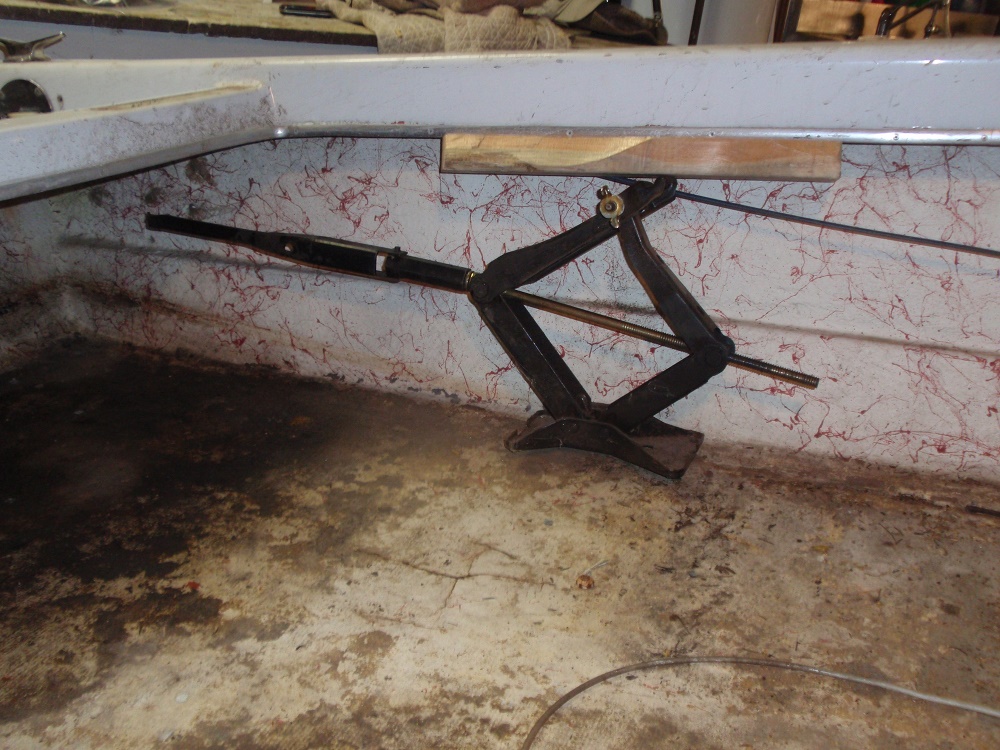

Had a Crestliner that was giving me a lot of grief pulling the top, here's how I solved the problem. Jacked it up and put 2x4's under it and then just shoved it off to the ground to deal with later.
Re:1964 Evinrude Sport 16 11 years 3 months ago #110690
Great idea sabre! I was just out trying to figure out what the hell I was going to do, and using car jacks is a good, easy thing to try. Now, I just have to get the wife and kids on board. :P
