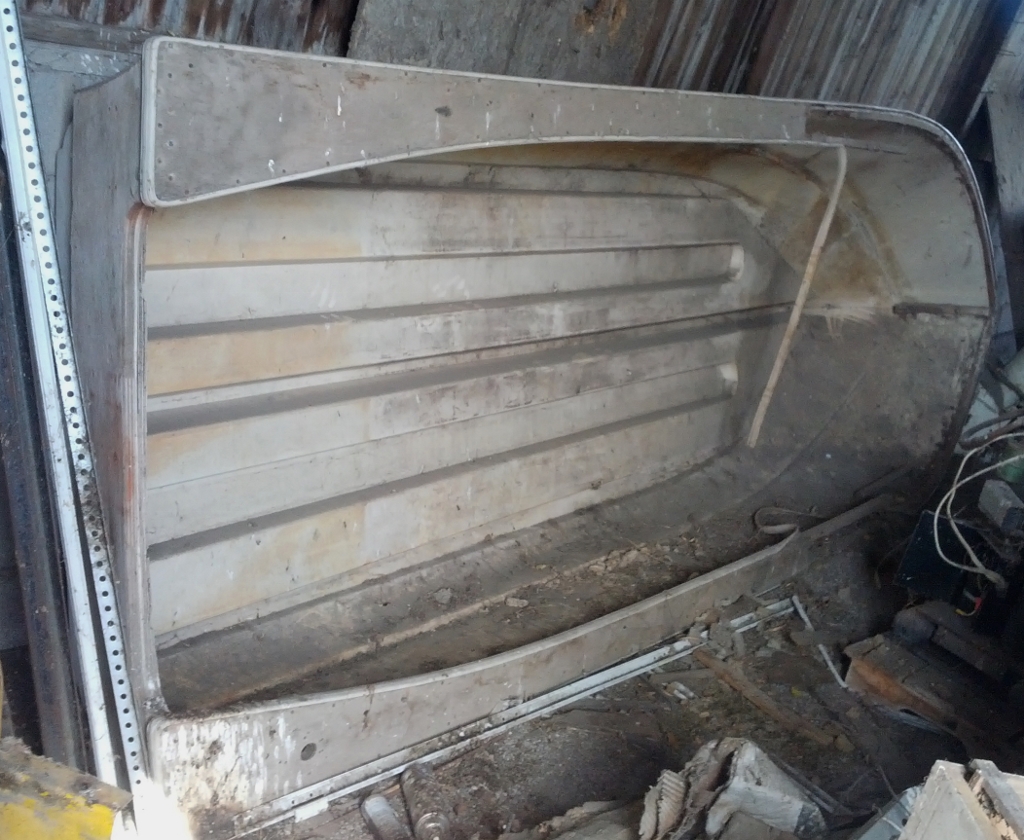

Finally some pictures...
Any info??
It's 15 feet long and beam is roughly 5 feet.
Any idea on HP rating?
I will be repairing gunnels, installing floor
and elevated front deck, and gelcoating the outside
surface. The interior will be light grey truck bed
liner with blue spatter.

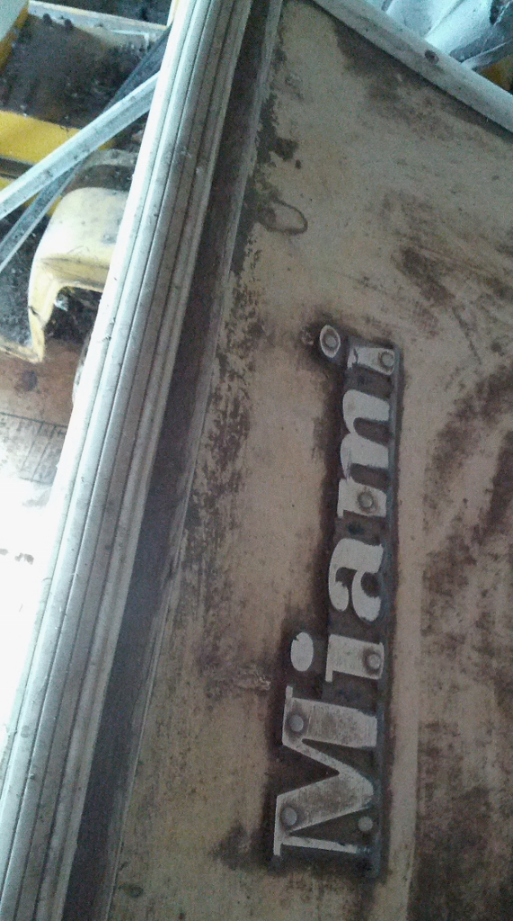

Logo

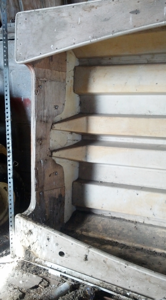

Stern

IF it was mine & as "the oldtimers" here know, my choice would be a Evinrude, Gale or Johnson BigTwin & of the same year as the hull.
While the 18HP Evinrude is an OUTSTANDING, long-lasting, tough, OVER-engineered OB, I think 25-35 HP would be better suited in every way for the hull.

I was afraid of HP rating... but the transom looks
good.

IF I was guessing, I'd guess a 1956 or 1957 build date.
(A large percentage of 1958-60 hulls had fins. - By 1961, every builder that I can think of had deleted the fins.)

The hull was made by Good Year's Aviation Division. It is the same hull as used by Bowman. I believe that Miami was a division of Bowman, or licensee. The hulls were made much like the MFG boats with matched metal dies used under something like 700 tons of hydraulic pressure. This gives both the inside and outside smooth surfaces. The fiberglass is somewhat thin and had wood framework inside to stiffen it up. I've got some Bowman literature someplace.But I recognize the floor/stringer/reinforcement layout as identical to what I have in my Bowman. These first appeared in 1954 with later production models by Bowman in 1956, 1957, and 1958. I have seen some Miami advertising, but can't put my hands on it at the moment. Running on memory here, but this information should be correct. I hope that this will help.
