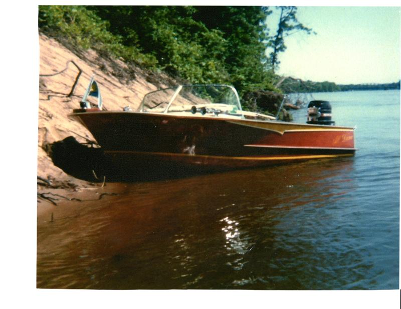

Years ago I had a 50 hp on a 15 ft light plywood runabout. The boat dry weight was probably about 400lbs (I am assuming that is lighter than your tri hull). If I remember right I had a 13" pitch aluminum to start with but ran across a deal on a 11" stainless that I couldn't pass up. I got about 30 mph with both,I am assuming because of the lack of flex in the stainless, but got more out of the hole with the stainless. It was running out at about 5500 to 5800 RPM, about where it should have been. Here is the boat that it was on.
Bill

That is a beautiful boat Bill! Thanks for the input.
