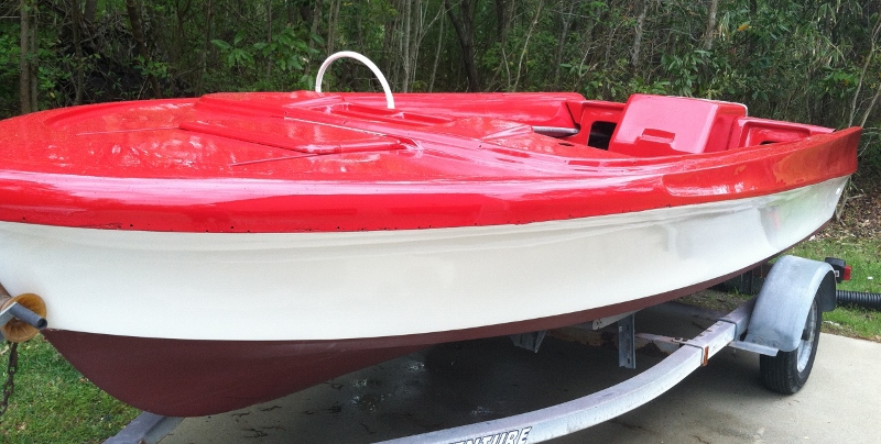

I am restoring my '66 Aristo Craft Funliner. Just got her back from the paint shop and I am putting her back together. Question...The rub rail is original and in decent shape (Lots of dents and some corrosion).Should I try to keep the original rub rail or go with new? I have investigated a TACO white semi-rigid rub rail with a chrome insert. Any suggestions?

I think i would try and stay with the original rub rail or try and find something as close to original as possible. I'd like to hear some more about your restoration. Any pics of the progress as you went along? I have 2 Funliners, 61 and 66.

My suggestion would be to use the original aluminum rubrail if the dents could be sanded and buffed out without changing the shape too much. If the dents are too deep,maybe a new rail of similar size would be the ticket. IMHO, these boats too small for the bigger rubrails How wide and thick is the taco rail you speak of.

pirate, you boat looks great, and you should be able to find rub rail that is close to original. keep looking. and nice job. frog

Thanks for the tips. I have decided to use the original rub rail for the time being while I continue researching a replacement. With new screws and bolts, it will not be too difficult to work with in the future.
Does anyone know a good source for a replacement windshield? Mine has a split and I would really like to replace it. I have seen a post on this site that shows a guy building one out of Lexan. Any thoughts?
