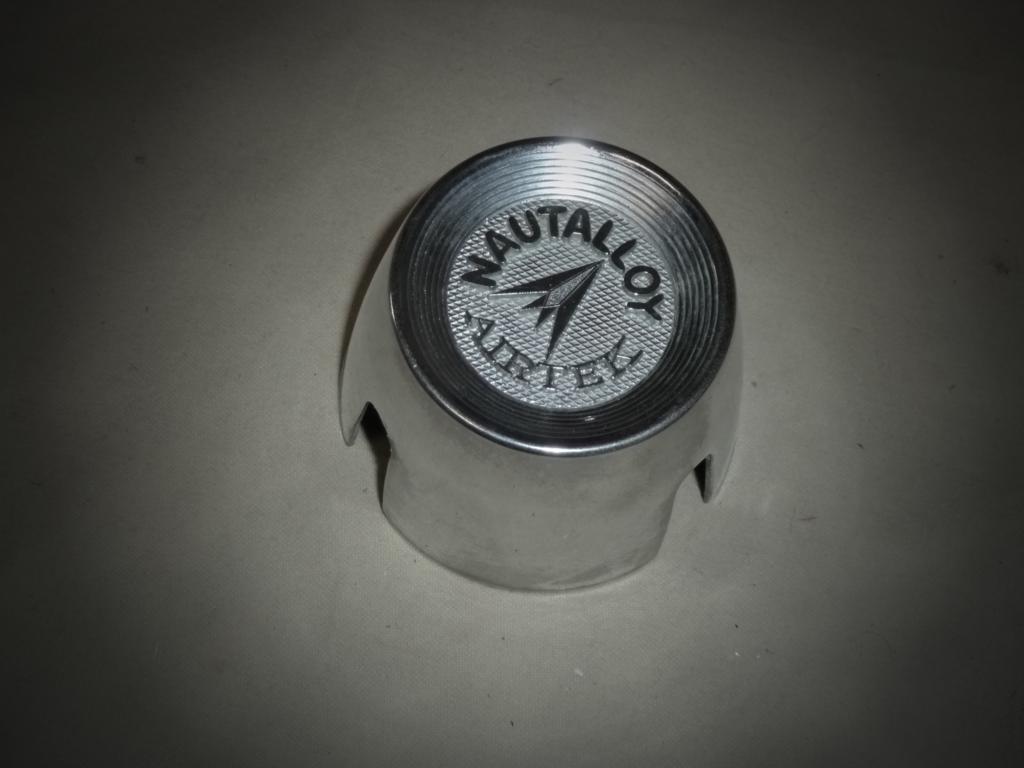

I found a nice Nautaloy Airtek metal steering wheel. I am missing the part that holds the center cap on the wheel. Looking for ideas. The cap does not have a hole in the center.

Here are two pictures of the steering wheel cap

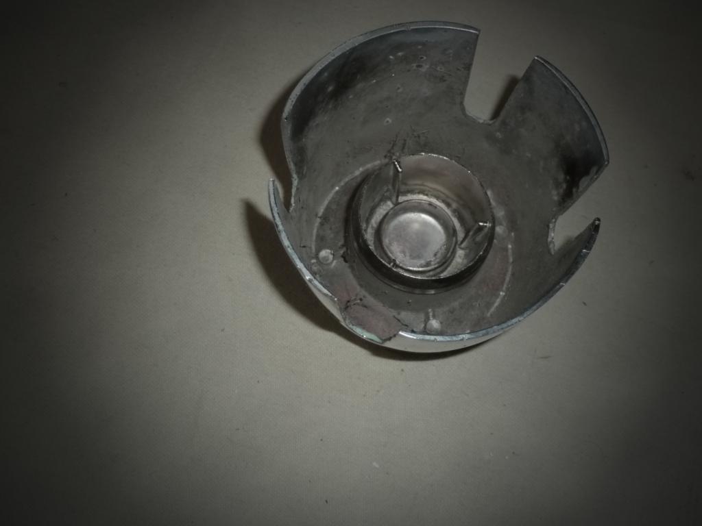

Here is the second picture

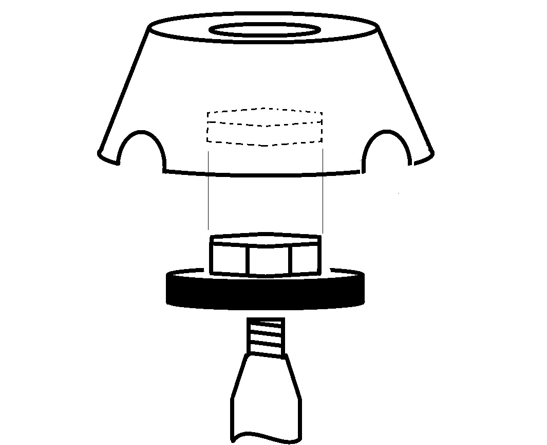

The push - on cap was held in place by a large pot metal nut made specially for this application. It has an 1/8" tall skirt around the base that acts as a spacer & washer against the steering wheel. The faceted hexagonal portion of the nut is just the correct size to make an interference fit to the cap. Look at the vertical ribs on the circular adapter underneath the cap - those are what hold it onto the nut. You will likely have to make something up if you can't source an original.
