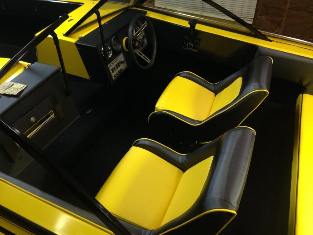

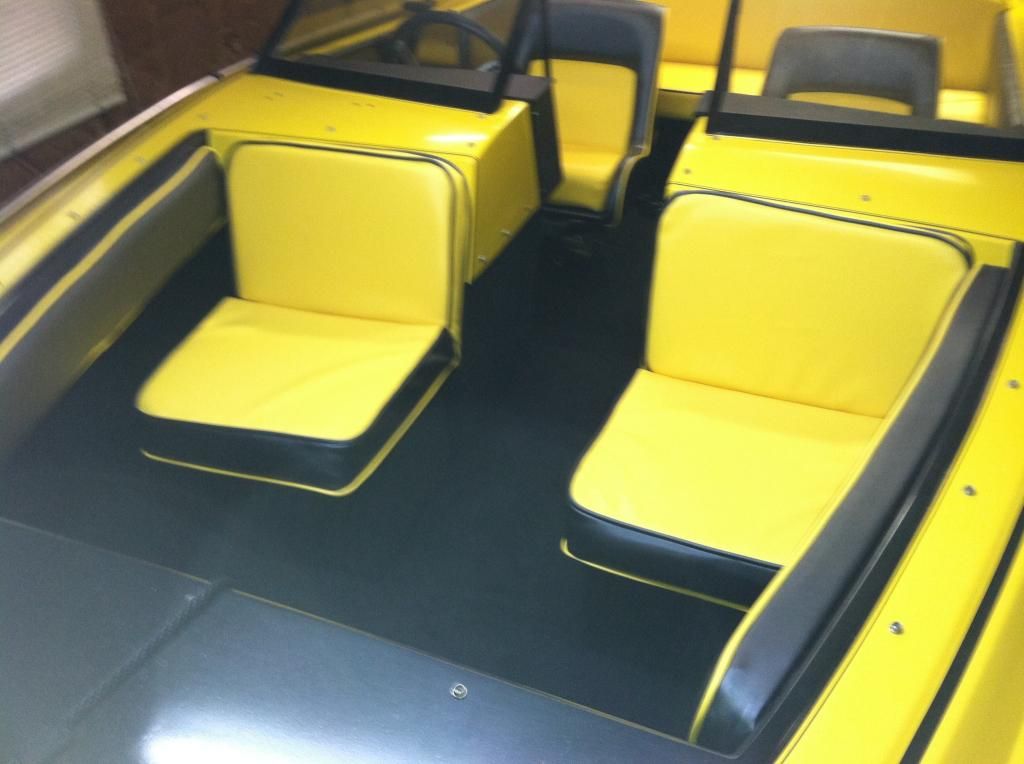

I was in the same boat you're in. I didn't like the prices the PRO's were giving me soooo, I did my own upholstery on my boat 3 years ago and have since started doing seats for others. Another one of our members, andgott, did his too, and has posted here on the forum as well. He did some excellent work too. I started out with an Old Morse machine from the 50's for $75 bucks and it worked OK, but then I bought an old Walking Foot machine for $300 and can do just about anything that needs done. Getting pretty good at it now. My phone keeps ringing maybe I'm too cheap!!! I did these seats for a guy in Ohio. He sent me his old brown and tan skins and said he wanted yellow and black. I sewed em up and sent em back and he stretched em back on. They turned out ok I guess. I might be able to help you out too if you want.

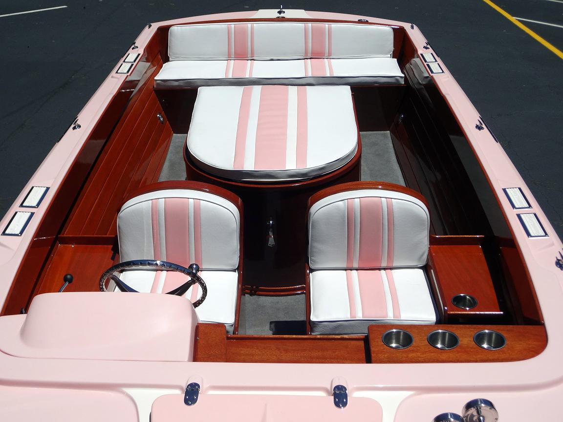

you get what you pay for...
These were pricey but well worth it. Only a pro can get the beading right.
