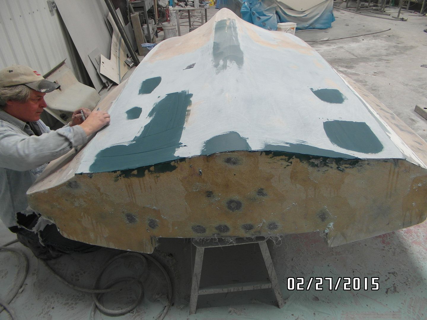

Many boats have wrapped bottom shapes after all these years. The correct way to fix the problem is to take a known to be straight 6' long level and grease pencil where the boat bottom has twists, hollows, and bulges. If one get all of those out of the bottom. The boat will be faster after this attention, also.
Re:Porpoising ?? 11 years 5 months ago #107242
  • Ronny
  • Ronny's Avatar
  • Posts: 403
  • Karma: 17
Here is a pic of our G3 hull getting a tune up

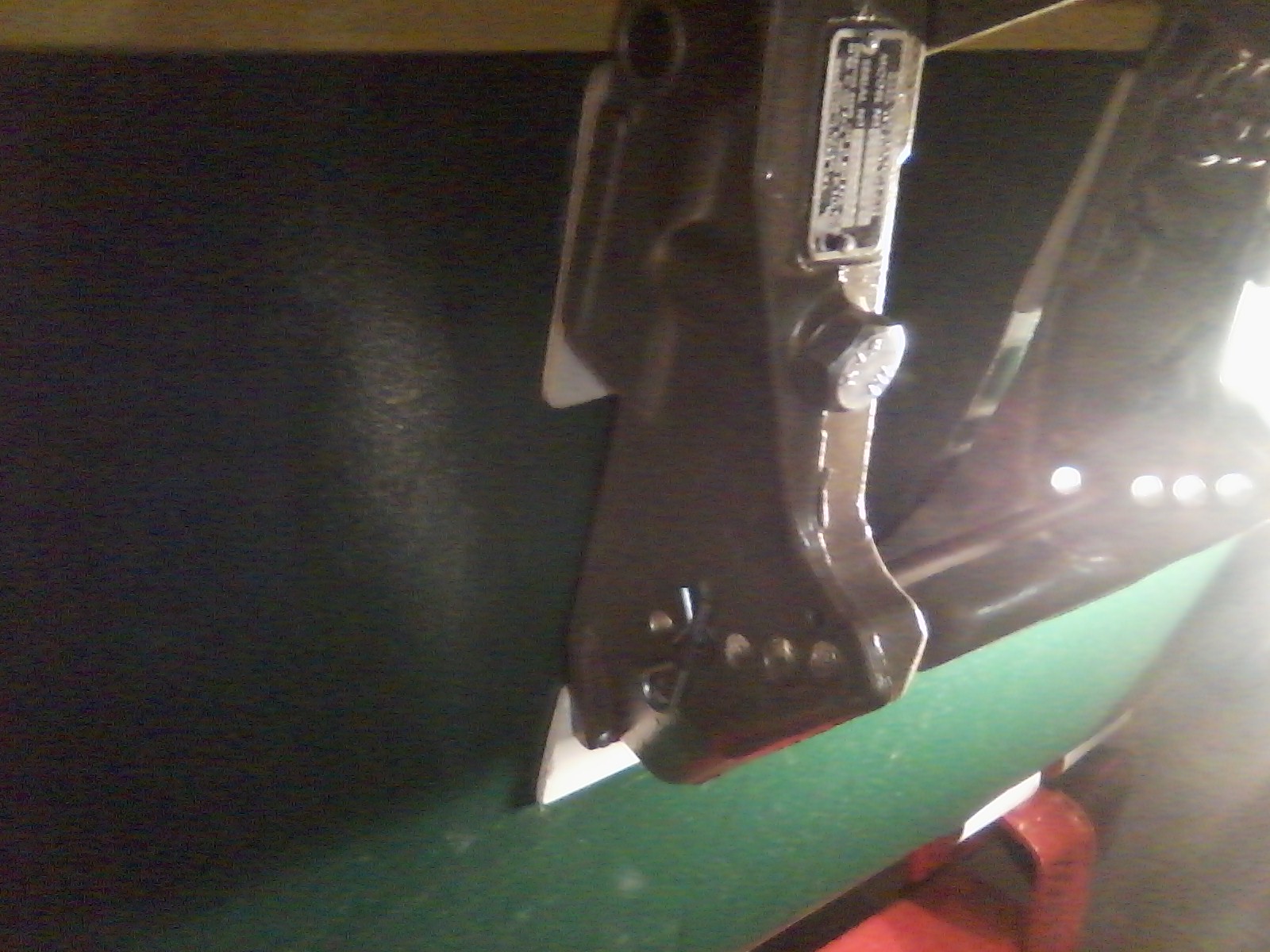

Re:Porpoising ?? 11 years 5 months ago #108108
Maybe this is an explanation of the "wedges" or shims that Bruce was referring to. When this transom was raised a PVC cap was put on the top for protection. That extended the width of the transom by about 1/8" just at the top. When the motor was hung the angle of the motor brackets to the transom was quite noticeable so pvc shims of the same size as the cap were put in place to distribute the motor "push" load. I've never done this on any other boat but without those shims I think it would stress the upper portion of the transom somewhat and cause the bow to plow or maybe cause a porpoise unless the motor angle was adjusted.
