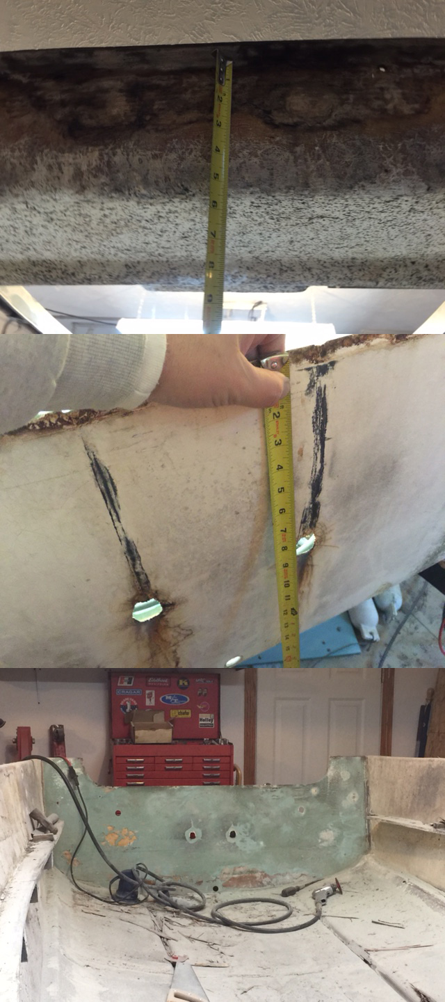

I have run into a question on my boat restoration. The Del Rio had an 80hp motor on it and the hull tag says it is rated for 90hp. When I opened up the rotten transom, it is only 1" thick. The recess on the deck won't allow it to be thicker. It's hard to tell because it was so waterlogged, but it actually looked like it may have been made up of 3 layers of 3/8". That would be 1-1/8" thick. Either way, everything I've read says that it should be 1-1/2" thick for an 80hp. Am I going to run into trouble if I replace it with two layers of 1/2" marine plywood? I was thinking of possibly adding some vertical stiffeners to the inside of the transom at both sides of the bilge, but they could only be as tall as the deck recess would allow. Any advice would be much appreciated. Jim

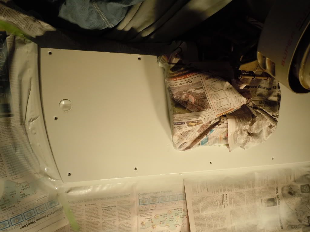

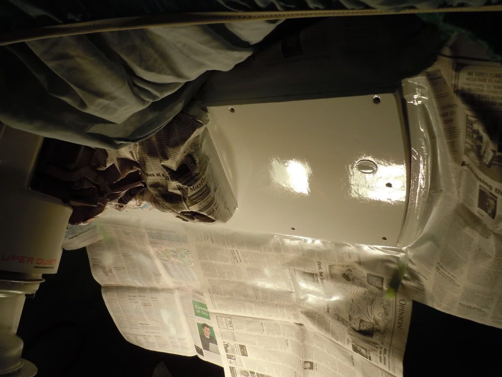

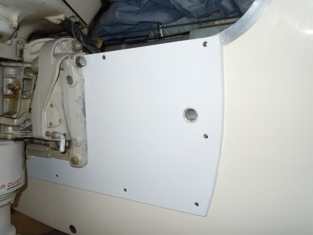

Jim, I've been thinking about your problem and thought that maybe your transom could be reinforced like the factory did the older models of Del Rio. The piece of Marine grade plywood on the outside of the transom might have been their way of strengthening it. Here's some pics of the plywood on mine when I repainted it a few years ago. I hope (if you go this route) maybe these pics will help out. Jim L

  • Jim L's Avatar
  • Posts: 1426
  • Karma: 60
The top 4 bolt through the cap and the rest just screw into the transom. Most of your stress is at the top of the transom anyway when you throw the juice to it.

I'm back at it and have another quick question. The inside of the outer skin has that green coating on it which I assume is epoxy. The holes that were filled have the same green epoxy filling them. As you can see from the photo above, it chipped out in some spots when I removed the wood. Do I need to get all that green off before installing the new wood, or is it sufficient to just rough it up and smooth out the harsh edges? Thanks Jim.
