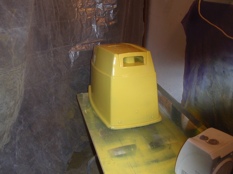

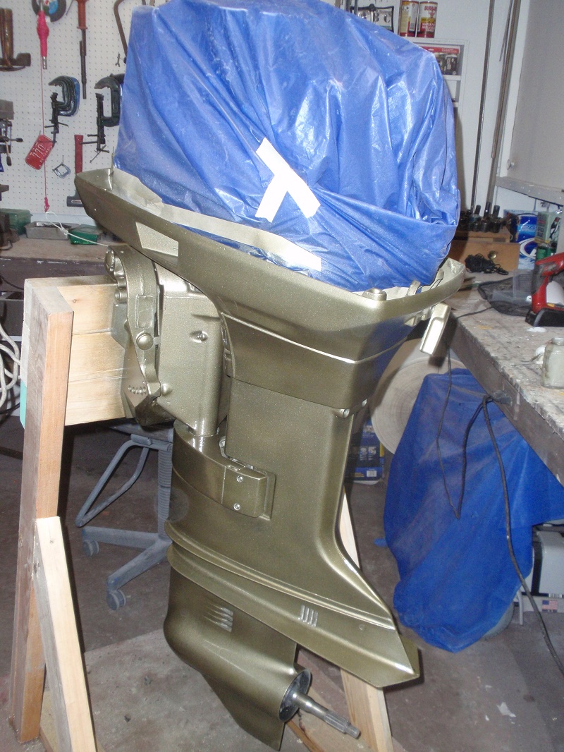

Norm, I opened a can of worms with my latest rebuild. The motor I picked up for $70 with the intention of parting it out. When I got it home I did a compression check and found out it was about 124 in all three. There were some parts missing but Ebay supplied them and I did have an old controller that fit the bill but minus the push button shifter. Decided to rebuild and recondition the motor and it's running like new so I started looking for a boat to put it on. The hood was pretty much trashed with holes, nicks, scrapes etc. Spent a few weeks with fiberglass, bondo, sandpaper and got it in pretty good condition but it sat most of the cold weather time in a corner with primer. Yesterday I decided to give her a coat of paint, the rest is the beginning to the thread. I didn't take any pics of the before and after. I painted the lower part of the motor original pea green of the era and the hood I'm painting yellow and probably will put some decal appropriate to the "theme".

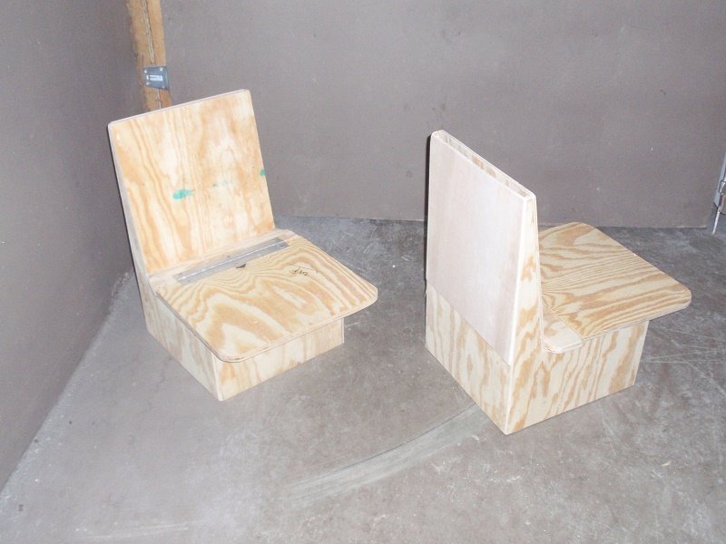

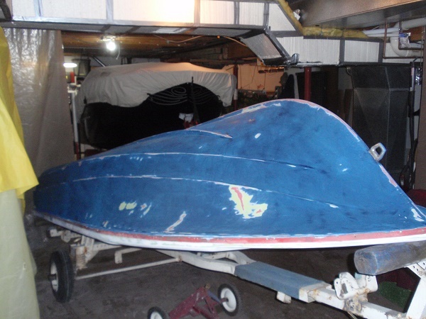

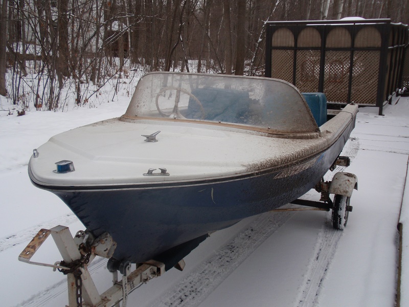

Found a 1970 14 foot Crestliner at rawhide with no motor and picked it up for $195. Put a new transom and floor in it and now it's ready for paint when the weather co-ops, probably Wednesday, supposed to get in the upper 40's. Over the winter I stripped the boat down did all the essentials and now it's flipped just waiting. Built new seats front and back and adding a new dash so I can put all the motor controls up front vs the shift lever. I'll put some pics.

This is what I started with. seats were "ripe" transom was fairly solid but wet and someone already tried to patch it up.
These are the new front seats that are going in. I already have them covered now.
Here it sits waiting for bottom paint.

The new paint job on the lower.
The yellow hood that is going to be repainted.

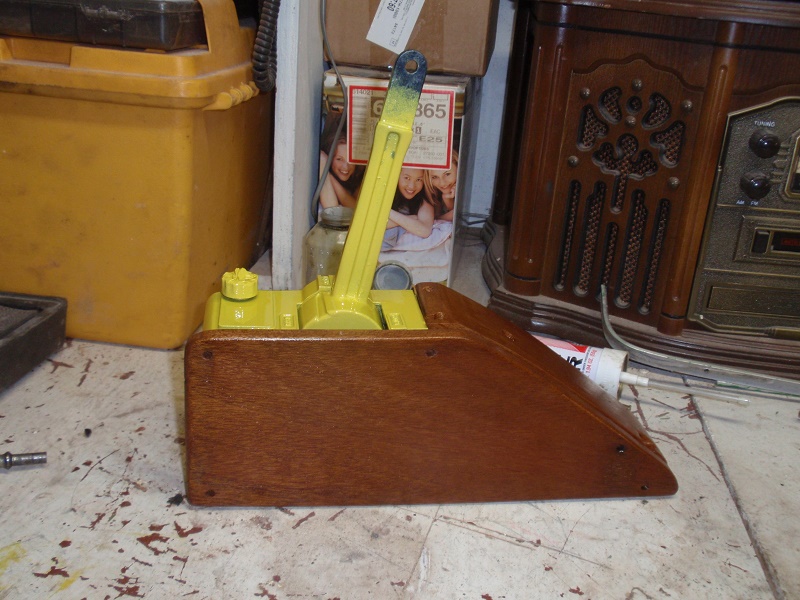

And finally the "new" shifter which was also junk that will match the dash. All controls other than speed and shift will be mounted on the dash with a push button start vs. a key.

Hey 63, how did you sand and prep all the little nooks and crannies before painting the lower end without taking it apart?

Mercooper, The nicks were all sanded down to bare metal and feathered. I did not take it all apart but used auto parts cleaner in a spray can with the red tube to get in all the cracks and voids. That stuff softens up paint also so it puts a tooth on the surface. I took all the knobs, levers and fuel connections off then wiped it down with liquor thinner and shot on a coat of etching primer, high build to fill in any other scratches. The green paint was old stuff I had from many years ago. If I remember I got it at an auto store that mixes. I brought in a green part from a motor and we matched it close with one of the little swatches they have in a book. I've done this with several motors and never had any issue with peeling or paint flaking off in water. Now days if you match paint those guys will mix it and put it in a rattle can for you. I prefer those small pint cans so I can mix and thin just what I need and not worry about the spray tips clogging up and spitting globs.
