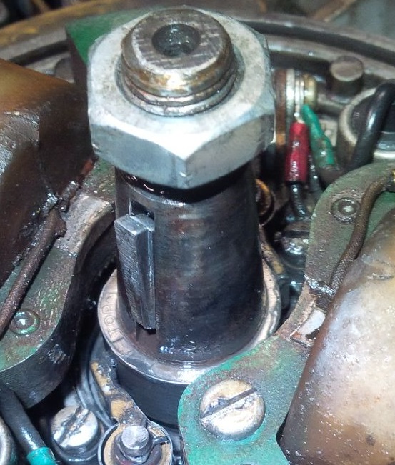

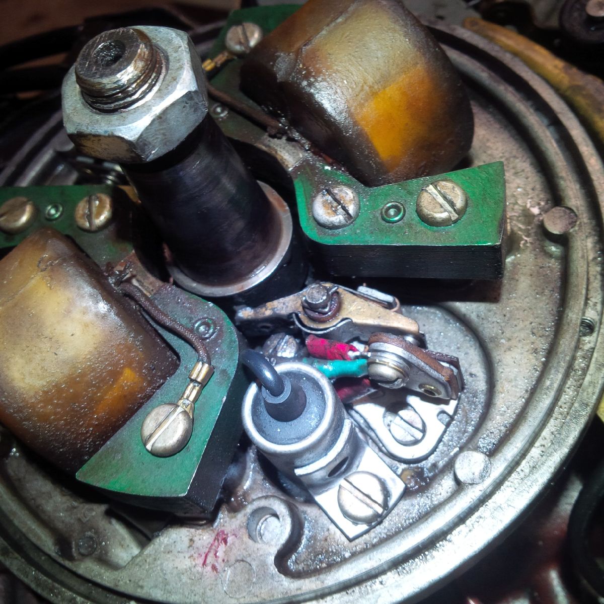

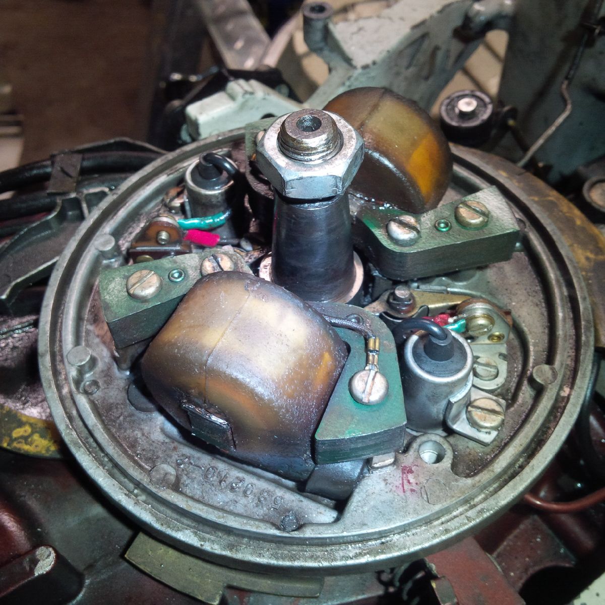

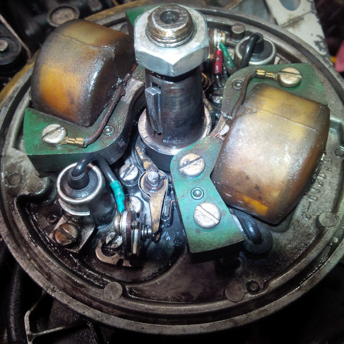

I pulled the flywheel just about 15 minutes ago. I didnt have a 3 jaw gear puller big enough so I used a piece of flat iron and a pair of C-Clamps and she popped right off.
But for the Nitty Gritty-
here are a few pic of what it looks like underneath. Im not sure if this looks good or bad. but I'll just plan on replacing it all anyway.
The only think that stuck out to me as particularly odd is the flywheel key. It has an odd jog in it. Is this what they look like right before they break or is this just how they did them?
Satx- what do you mean by chocolate milkshake? Where would i see signs?
Thanks for all your help guys
Andre
Re:GIVEAWAY ON THE BAY!!! 10 years 4 months ago #106173
HellCat,
Like I said, "your coils, points, plugs, wiring & impeller" need replacing BAD. = I'd bet that your "curse" is BAD coils, that "break down" after a few minutes of running.
Re:GIVEAWAY ON THE BAY!!! 10 years 4 months ago #106174
  • ed-mc
  • Posts: 1442
  • Karma: 232
  • Thank you received: 124
HellCat wrote:
Is this what they look like right before they break..........?
Oh, Yeah! That flywheel key was about ready to shear, fer sur!!! That's what happens when the flywheel nut isn't properly torqued down (or sometimes hitting a log!).
Time for a new key, new coils, and new points/condensers. Set the points so a feeler gage drags thru them just a tad loosely, at .022" (it'll run better that way).
Take note of how the coil laminations fit flush with the posts sticking out of the magneto plate; be sure the new coils are set the same way, so the flywheel doesn't drag on them.
Seen coils like that a Jillion times, they're always bad. It's a miracle she ran at all, let alone for the 9-or-so intermittant hours you got!
I'll bet you'll notice a diff in how she starts & idles, when you're done. Besides will probably run now without dying on ya.

As an FYI, I strongly advise doing one side at a time, or keep this picture with you when replacing coils/points. It's easier than you may think to screw up ...don't ask me how i know that :S .
That motor will hum after you replace all that - throw in a carb rebuild as SATX suggested (easier to do than you might think), and it will sing!

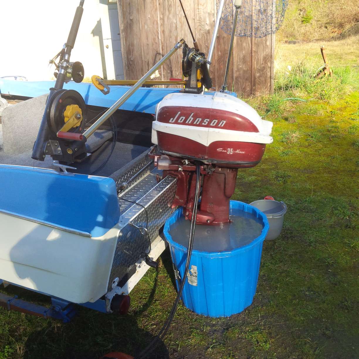

So I got in new parts yesterday and I just installed them tonight with no hiccups. I primed it and gave it 1 pull and it started right up.
I'm going to get it out on the water Saturday and really find out how she is doing, but I just wanted to say thanks to you guys for the pointers and the advice.
