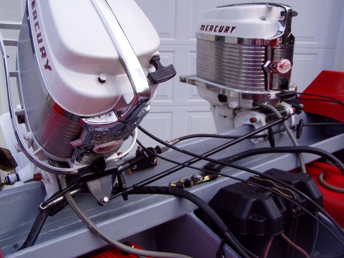

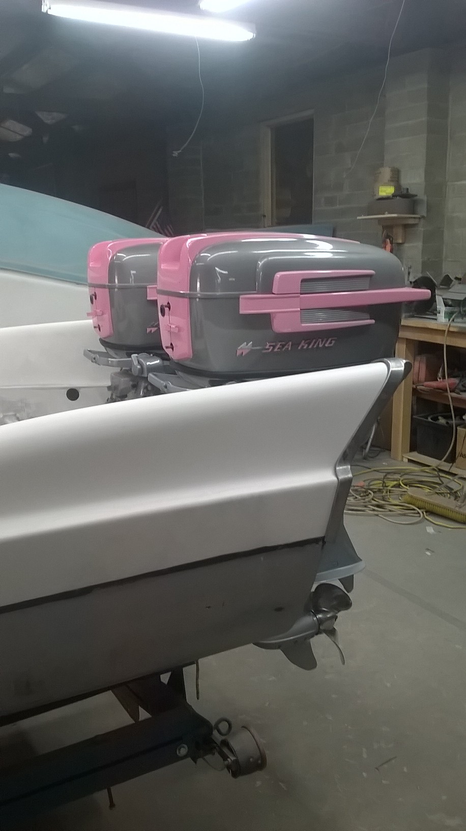

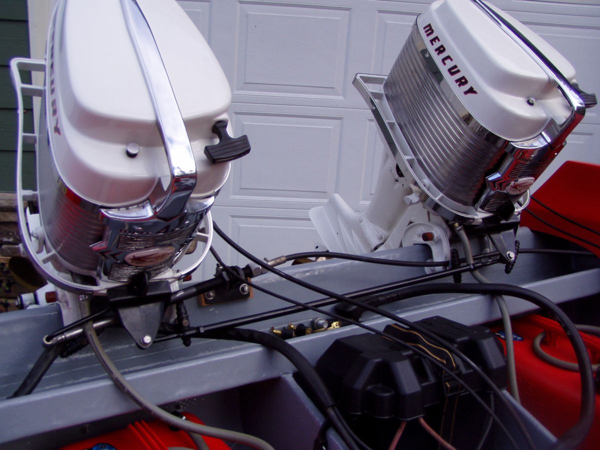

Here is a twin set-up I did a few years back.

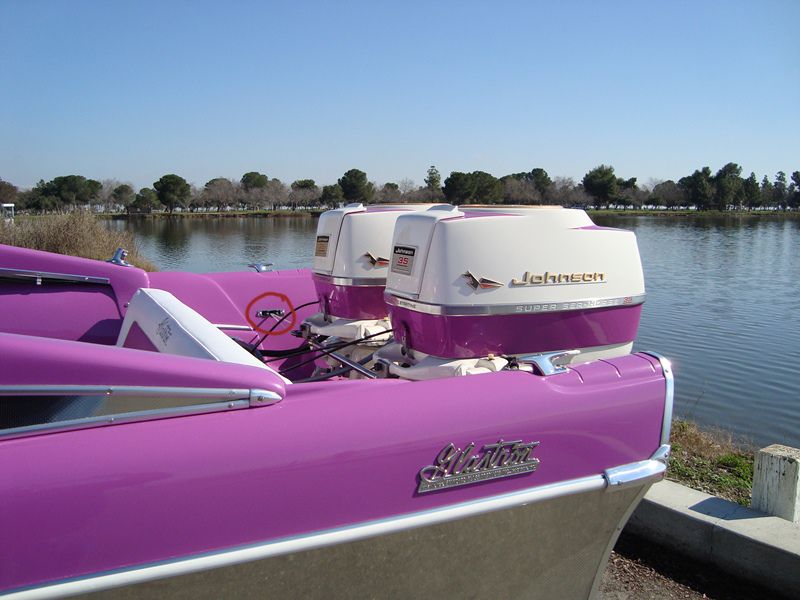

Bill, I hope these help.

Re: Twins 11 years 4 months ago #105994
Hi Bill, you may want to search online about the engines, they look pretty close together, there is usually a distance between and a toe in to get it to work correctly.

Re:Twins 11 years 4 months ago #105996
Are you keeping the pulley system, or switcing over to a push pull system? Makes a difference.
As I recall, Johnson suggested 20" between center of motors, which does make them close. If you are using the original aluminum clamps on the motors that the pulley system connected to, I have a NOS tie bar I am not using I can sell you for cheap. Was going to use it with my Gale 40's Rideguide system as it is pretty heavy duty, but am using a mercruiser one that is even more substantial!
Interstingly, the Gales came with the associated tie bar, and it was MAYBE 3/8". It was used with a pulley system and was obviously adequate, but not what i would be comfortable with.
For what it is worth, mine will be a mix of what is below.
Al T

Thanks for the replies, great pics.
Larry, did you build that boat? Would like to see where the wire harness goes through the splashwell. Thanks
Whatsleft, yes I am keeping the original cable system, and I believe you are right on the 20" as per my old Johnson brochure.
Cheers
Bill

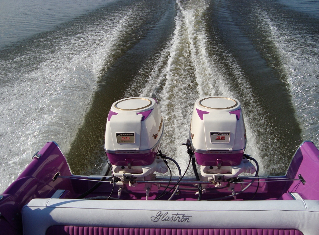

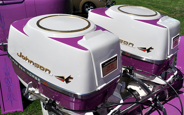

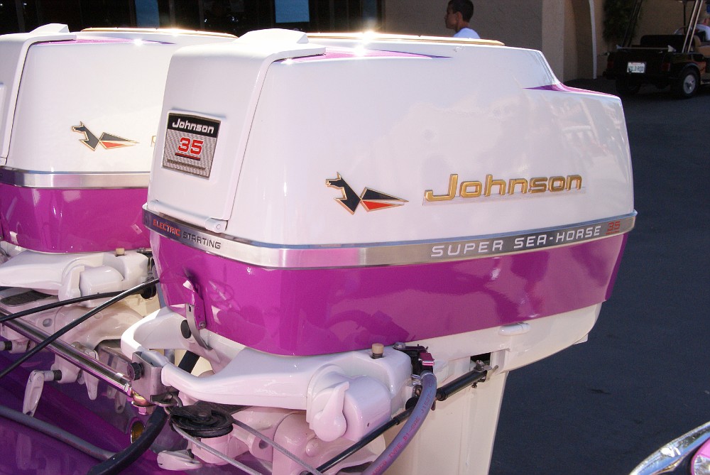

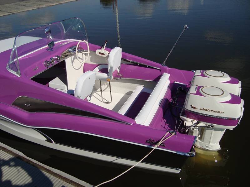

Yes Bill, We built to boat. It was a really FUN restoration.
This is the only photo that I could find of the wiring going through the splash well. Both go through the starboard side. We trimmed the hole by buying a stainless steel cup holder and cutting it apart just below the flange. Well...... it was exactly the right size :laugh:
The motors are set at 24 inches on center with a 1/2" tow in.
Larry
Re:Twins 11 years 4 months ago #106040
I have the same hole in the starboard side, but didn't think the wire harness would be long enough for the port engine. Did you use a standard harness or come up with something longer? Did you use springs on the cable steering?
Thanks
Bill

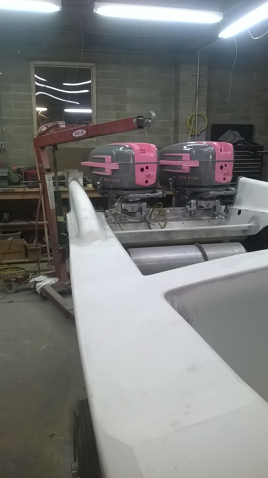

Bill, The Glastron is so wide that we had to lengthen the harness for the port side motor about 14 inches. It's not a huge job. The connections were made under the splash well.
We got lucking on the Herters. It so narrow that the standard harness is going to work. We test fit these last week.
Larry
Re:Twins 11 years 4 months ago #106044
Sweet looking motors, thought that might be the case on the harness.

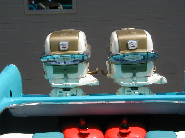

All fine examples shown, here's another that may give you some ideas Bill. It's from a while back, but a classic design IMHO;
www.fiberglassics.com/glassic-forums/home/main-forum/power-cat-18dc/page-2#6420

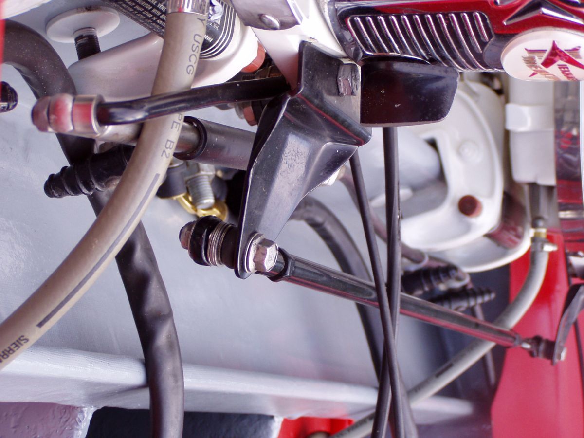

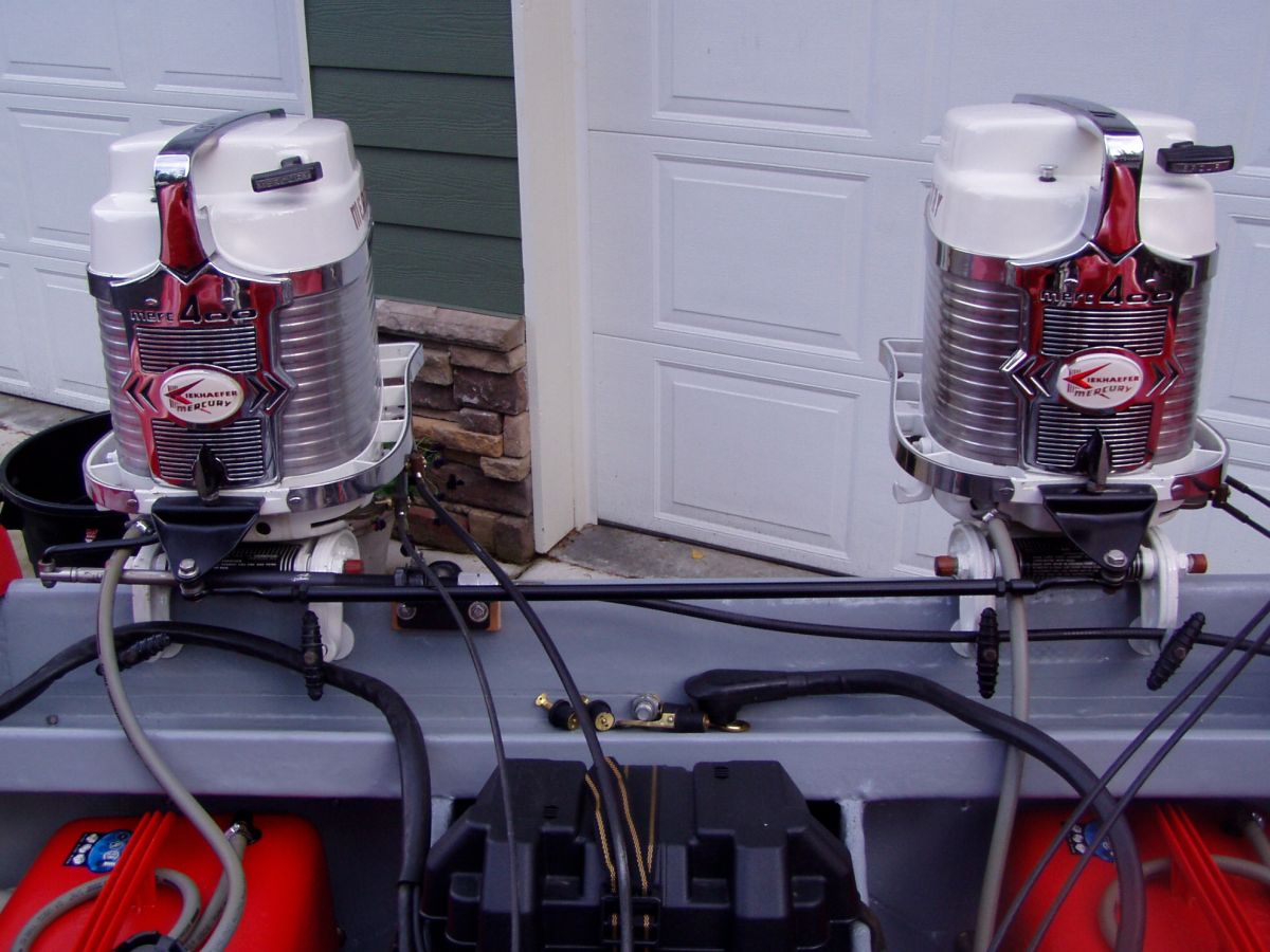

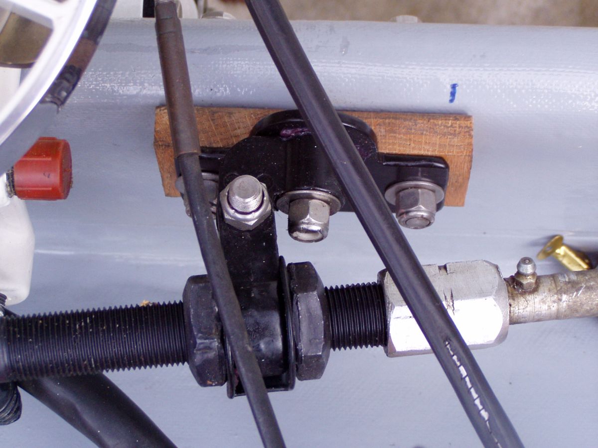

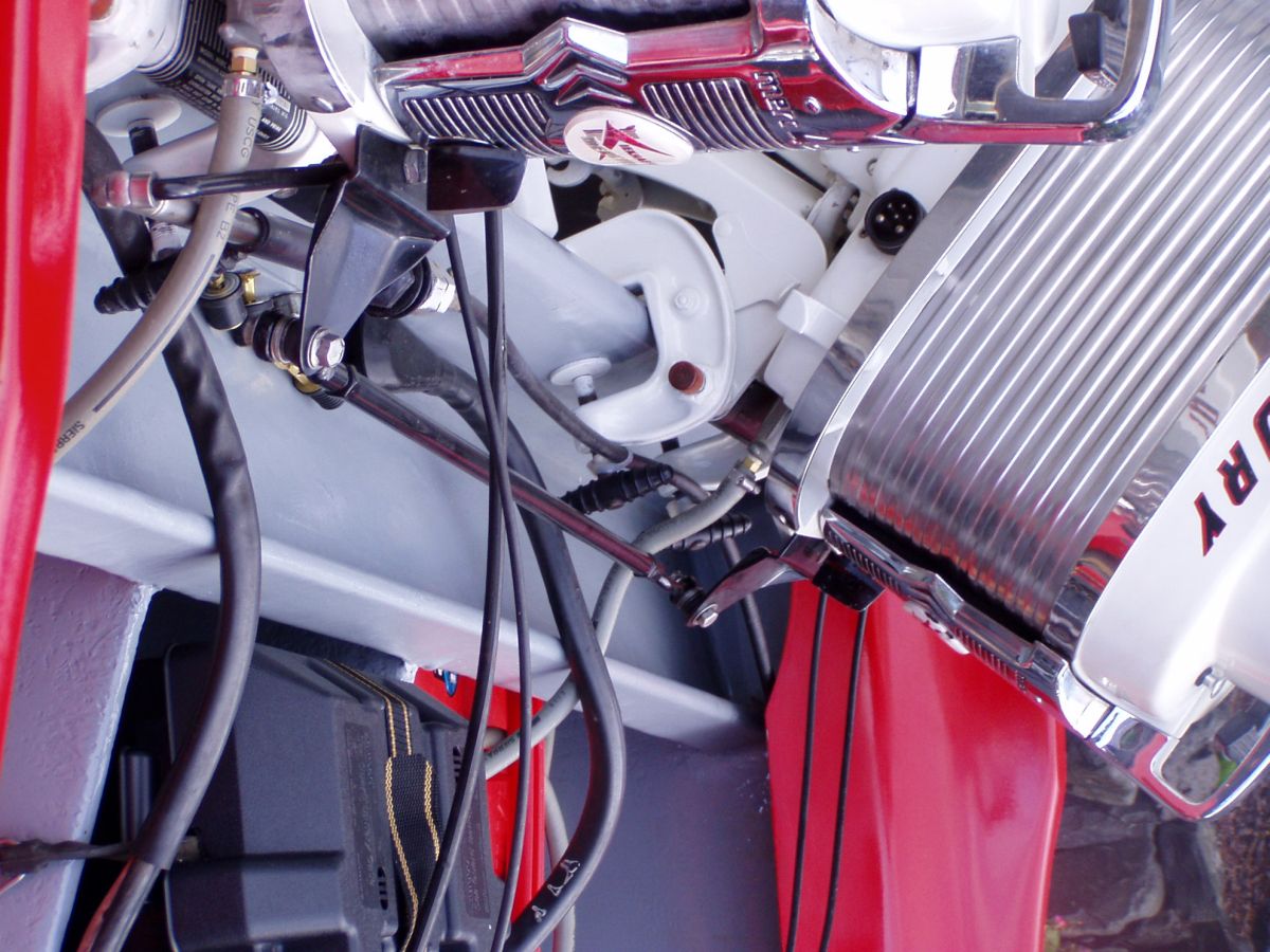

Pic of bar between two 1957 Johnson 35 HP outboards on my 1957 Thompson 16'-7" Sea Lancer:
Re:Twins 11 years 4 months ago #106113
That setup is very similar to the ones on that came with my '62 Gales, Thompson...
Re:Twins 11 years 4 months ago #106122
Thanks Handyandy, that's one of the manuals I was looking at. ( I actually scanned that one). That & the big service manual don't show the springs that prompted my question. Thompsonboat, thanks I believe that's the bar I'm looking for. Is yours still available whatsleft?

Re:Twins 11 years 4 months ago #106127
Yes, I sent you an email Friday, I'll re-send. I have that one also, but is buried in the garage and won't be able to get to it until next weekend.the one I sent you pic of is much more substantial.

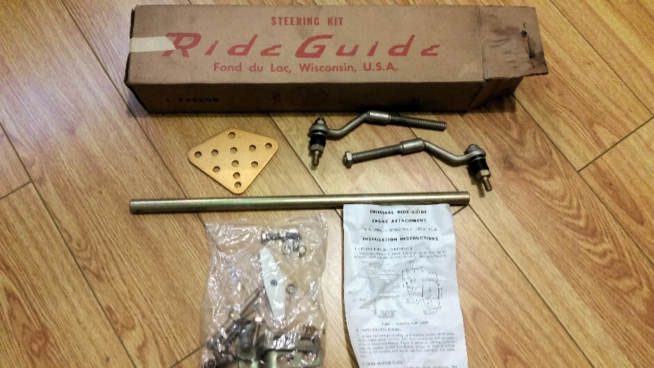

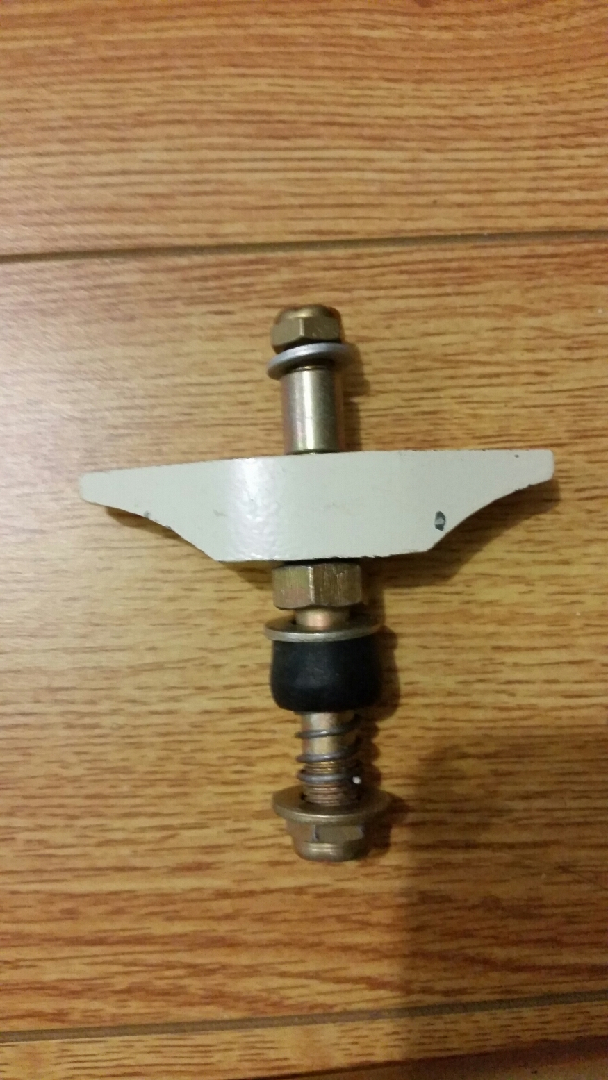

I got this set today for twin engine hook up the guy said it a original ride guide set.ya look original all right still have box and instruction sheet on how to hook up.even that I still don't get it I'm just going to need a few parts only so the rest is up for grab.I bought the whole set for only $10.
Re:Twins 11 years 3 months ago #106202
Outof the whole set I think I only need this parts but again I not sure if it is a right connection fir my motor
Re:Twins 11 years 3 months ago #106205
Make sure you get what you need, and if you'll let me know what shipping is to the US zip 26554, I'd be interested in the balance of those parts.

Sure just hang in there I order a few more parts and it's coming this week as long as you pay for shipping it's your.

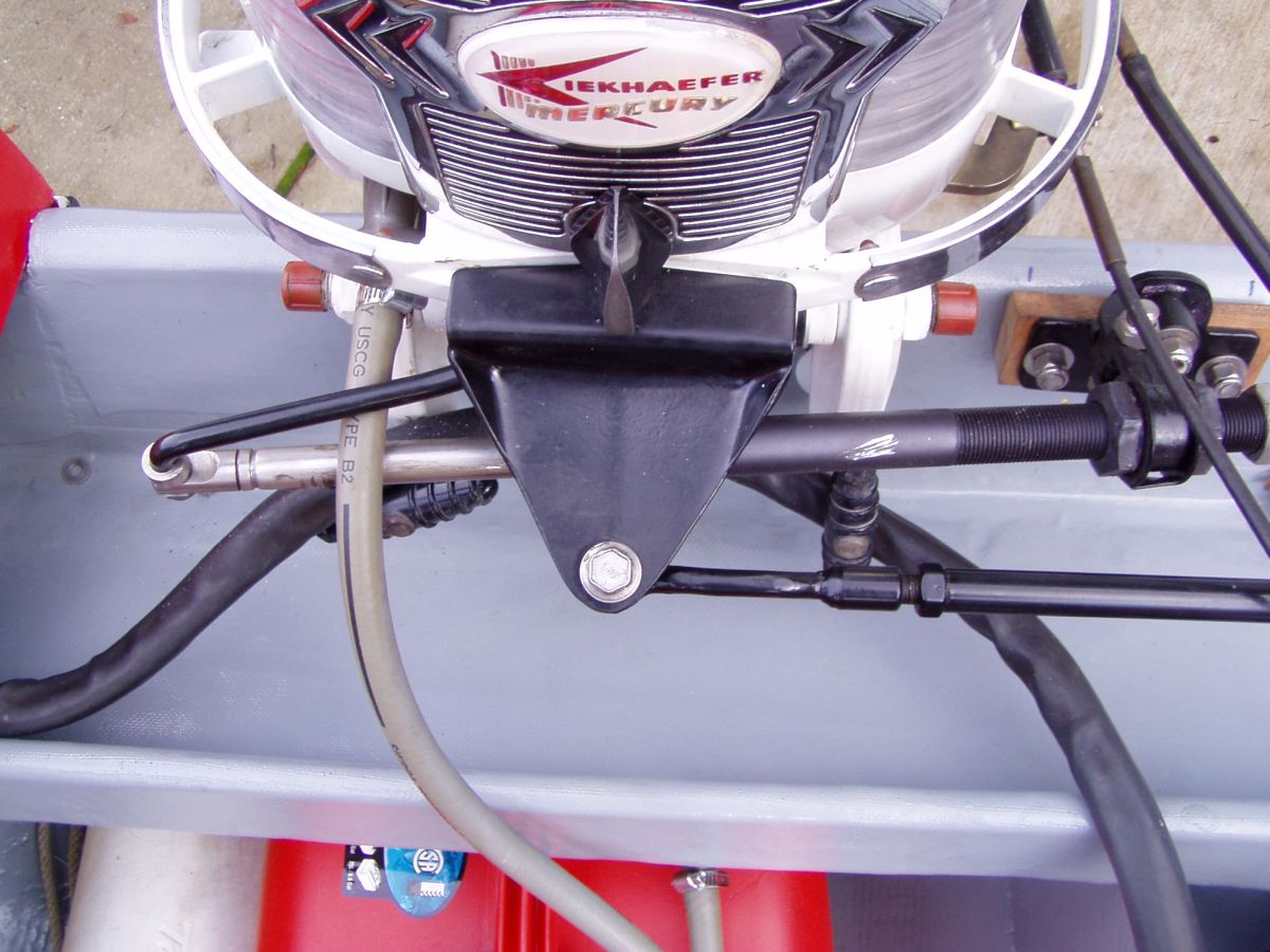

Re:Twins 11 years 3 months ago #106556

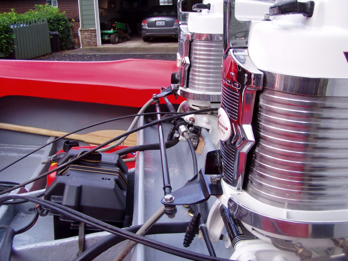

This is one of the best twin motor steering setups I have seen.
It uses all original Super RideGuide parts and works as smooth
and steady as any in my experience. Jim was fortunate enough to
have saved the complete setup from his days in racing and used it
on this nice Power Cat 15c with twin 150xs Mercs.
Danny

Larry, a couple questions if I may. On the purple Glastron, did you use springs on the cable steering, if so, where? Where did you fasten the ends of the cables? That is a nice neat install.
Thanks
Cheers
Bill
Re:Twins 11 years 3 months ago #107166
  • Larry
  • Larry's Avatar
  • Junior Boarder
  • Junior Boarder
  • Posts: 99
  • Karma: 28
Bill, We used springs on both the port and starboard sides of the hull.
The springs and pulleys aligned perfectly with the rub rail, so they were through bolted through the rub rail before installing the rubber rub rail insert.
We have, on several occasions had the glass in plywood blocks to secure both the springs and pulleys.
Larry

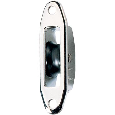

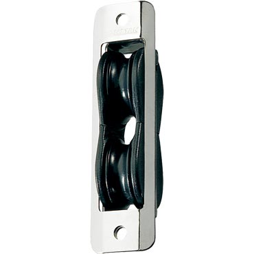

Larry, I have decided to follow your lead & attach the pulleys to the inside of the rub rail. Where did you get this piece from?
Thanks again
Bill
Re:Twins 11 years 3 months ago #107298
  • Larry
  • Larry's Avatar
  • Junior Boarder
  • Junior Boarder
  • Posts: 99
  • Karma: 28
Bill, Those are Ronstan Series 30BB Double Exit Blocks. They are Sailboat hardware. They come as either single or double pulley set-ups. I bought these off eBay for about $25 each. landfallnavigation.com sell them. There may be other sources and manufacturers. Look up "exit blocks". We, of course, used them strictly as cable guides. There may be cheaper alternatives.
