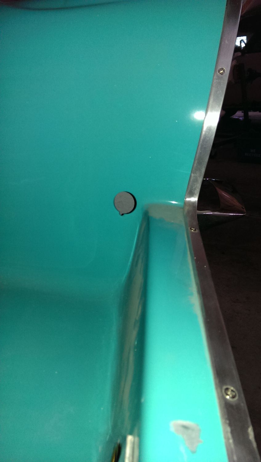

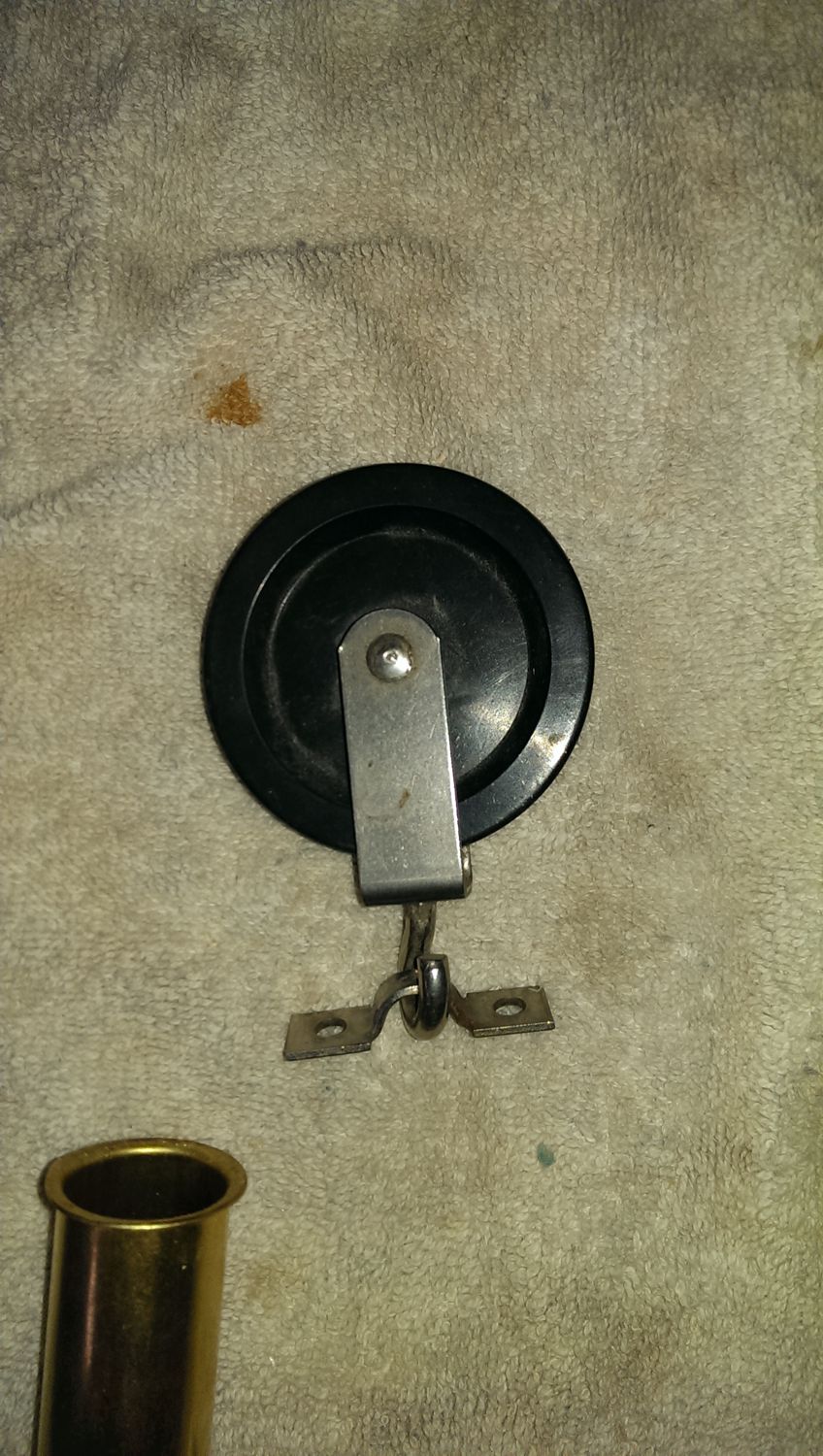

Ok, more cable steering questions. When I got the boat, the system had been removed, so I have nothing to go on. I have two pulleys (see pic), that I believe were on the front. Would the same pulleys have been used on the rear or would it have been a fixed one? The spacing seems right from the inside of the transom to the center of the holes for the cables. Also, I'm guessing when the cables are under tension, the pulleys would be at a 45 deg. angle, so i would have to take that into consideration when mounting the rear pulleys inside the fin? Thanks again for the help.
Cheers
Bill

Hi Bill, Here is a diagram showing one very simple way to do a cable steering set-up. The same pulleys may be used, front & back
Larry

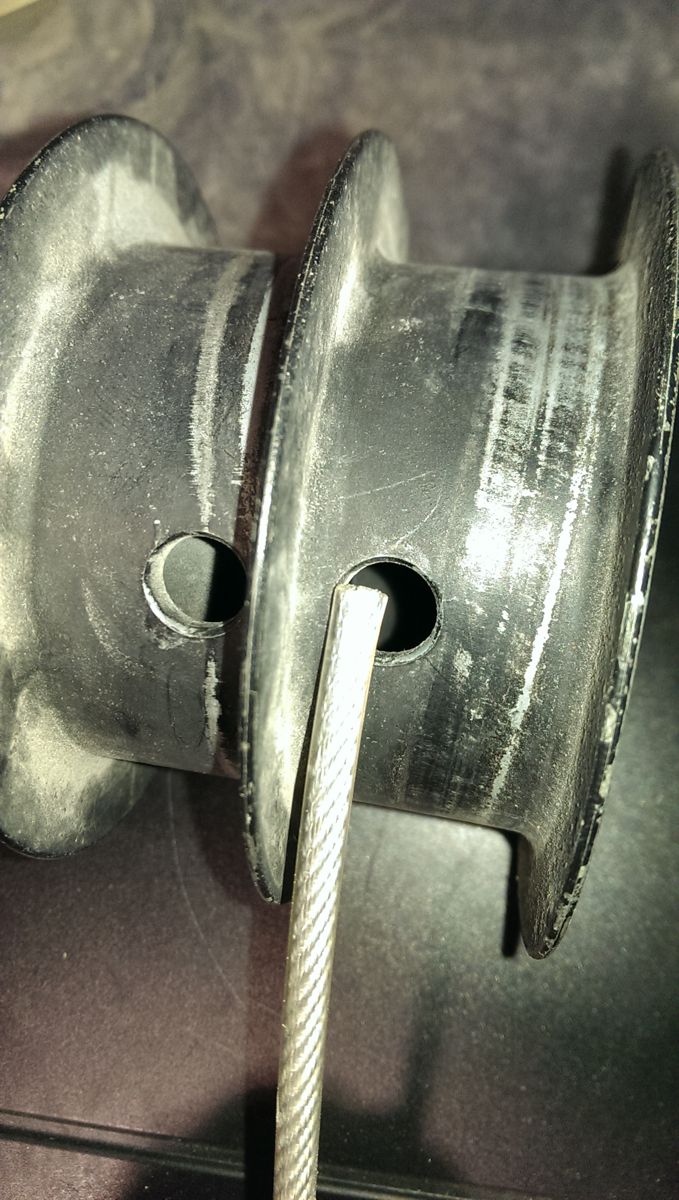

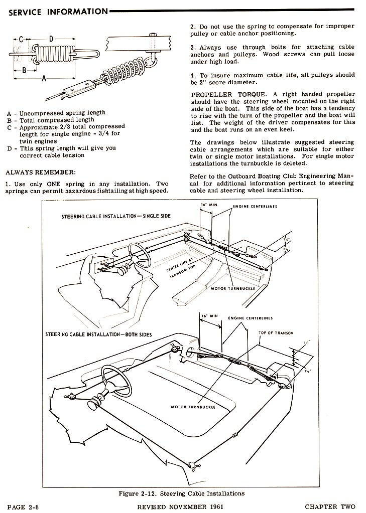

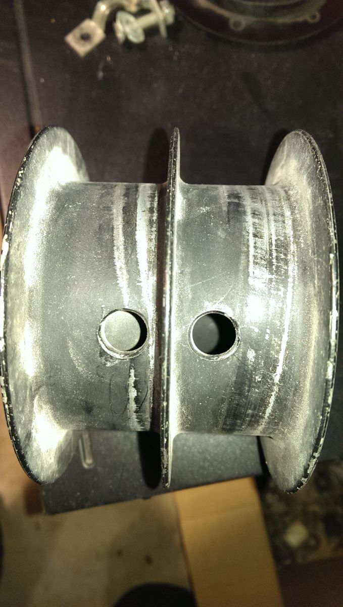

Ok, so I'm learning more about cable steering. Was searching on this site and came across these instructions. Says to use only one spring. Every pic or diagram I've seen shows two, but this makes sense. Also read a remark about someone having a cheap Attwood pulley with no grooves, so off I go to the local marine supply to see if I can get a pulley with grooves. The guy standing beside me happens to be a rigger (overheard cranes, winches etc.). He says nothing wrong with the pulley, you just have to wind it properly. If it's wound as shown in the pic the cable will stay tight to the inside. As evidenced by the marks on the pulley, it was done wrong last time and walked to the outside of the pulley. The cable should be fed so it looks like threads of a bolt going into a nut. Who knew?
Cheers
Bill

Bill, here is another diagram on winding the cable on you steering pulley. Hope it helps.
Larry
