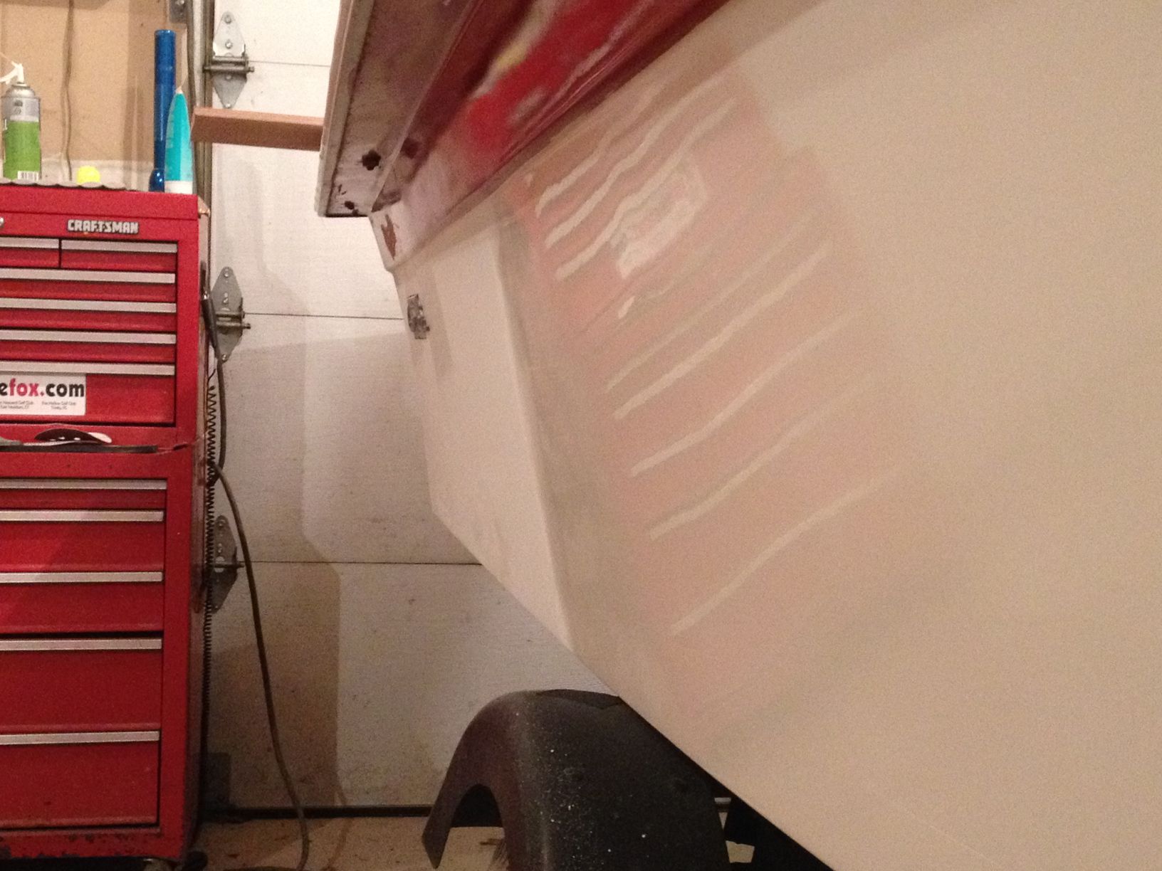

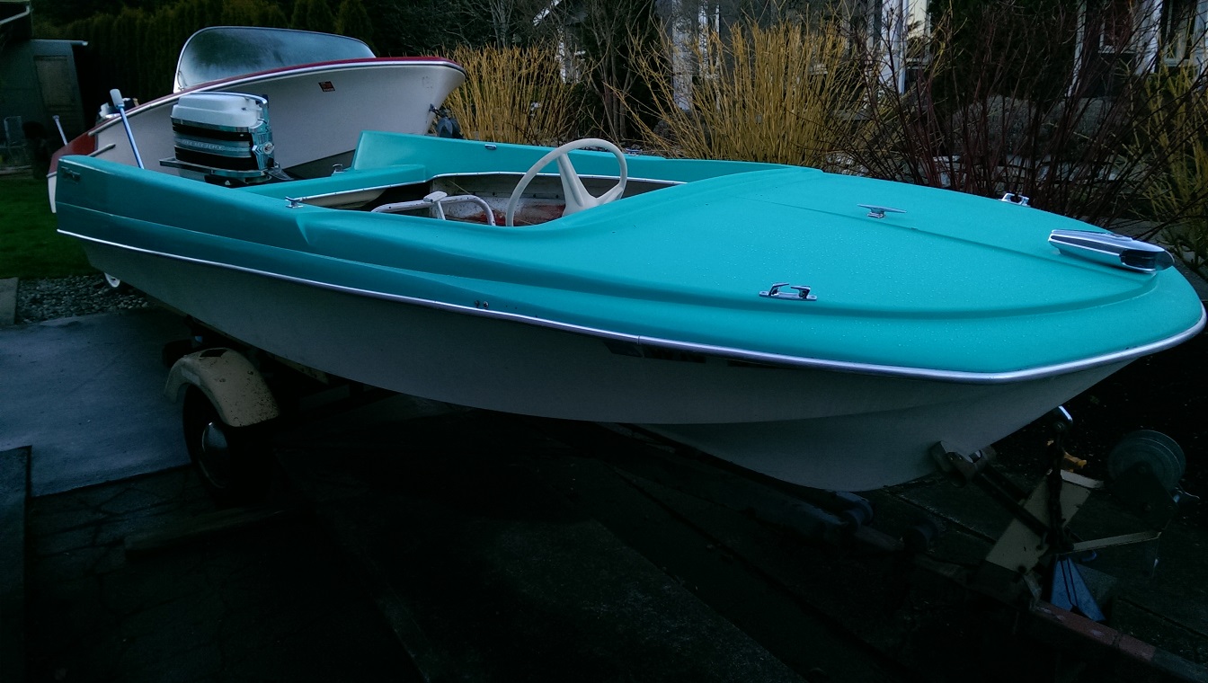

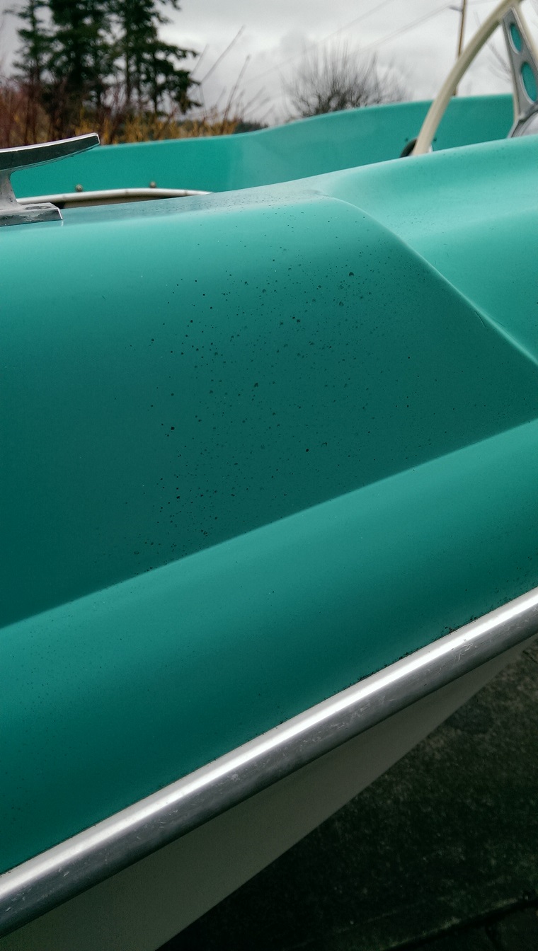

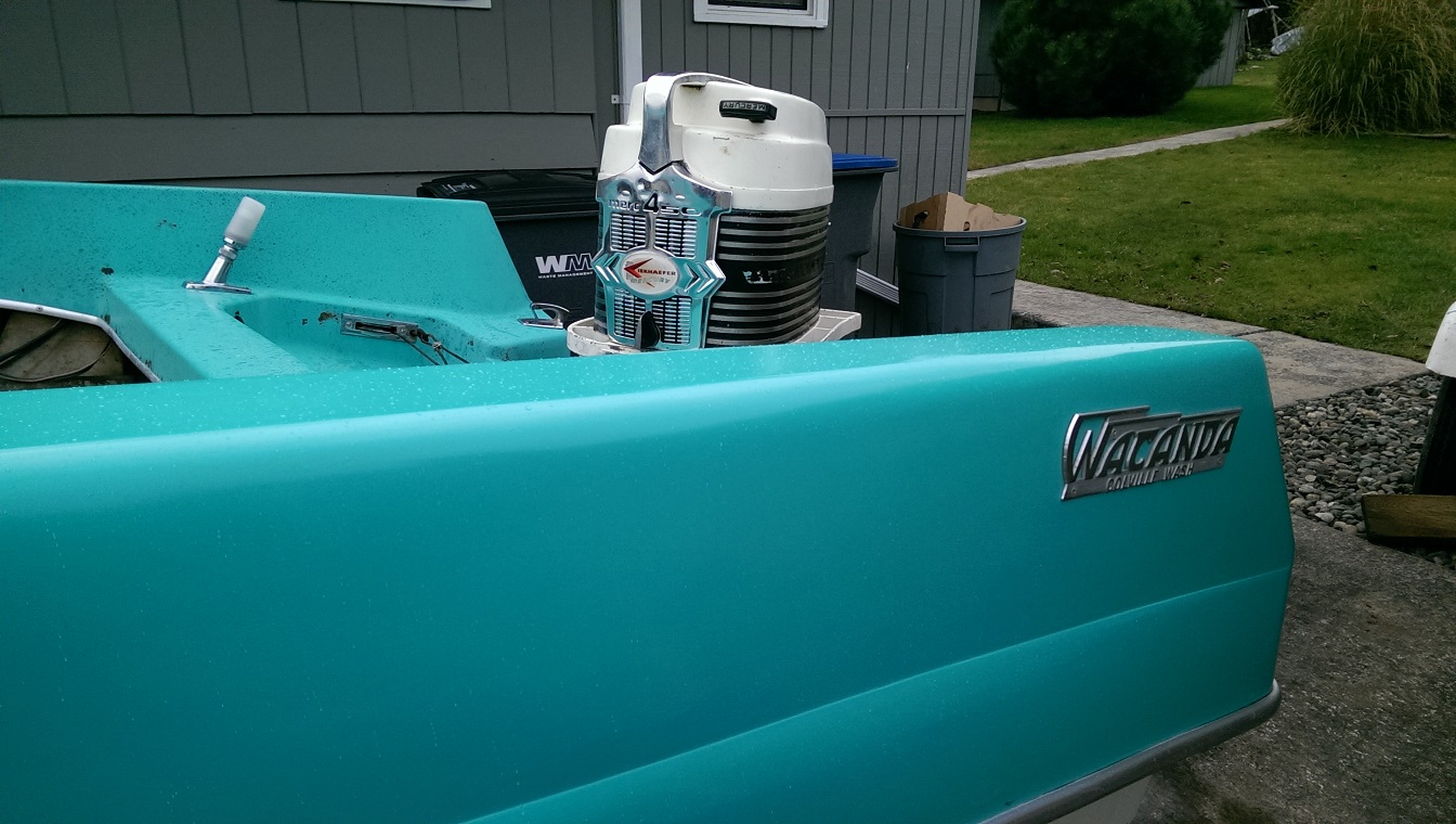

Welcome aboard BigBlue, you have to try to sand it, what I did is take a small section and wet sand with 1000 or 1500, buff with polish compound, wax. Does it look good, no then 800,1000, polish, wax. I would then go 400 max, if that don't fix it paint, you have nothing to lose, my Waconda came out great, my Pacific Mariner not as well. Also different surfaces need different levels of sanding, top flat needed more than sides since less sun, also VERY careful on ANY curves, I over did some curves on the bow, I thought it was corrosion but it was the fiber glass under the gel coat and I messed it up, use 1000 and hand sand very careful and learn on the transom or somewhere you don't see as well, by the time I got to the bow and dash I was an expert.

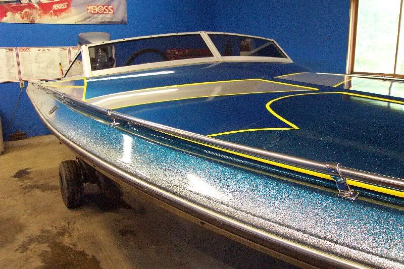

You might want to start just by compounding with a machine. Especially if you're not familiar with sanding. Buffing and sanding both do the same basic thing. They remove layers of bad paint exposing layers of good paint underneath. Like exfoliating your skin. I used to be strictly a 3M product guy. However, over the past year, I've grown to really like BuffMagic. It's a progressive compound. Meaning it starts off pretty aggressive and gets finer as you work it. Think of it as starting out as a compound and slowly turning into a polish. If you're a novice (or not), it takes the guess work out of what to use. Use a good wool pad and start on a slow speed in about a 2'x2' area. I'm a Chris Craft guy and early CC glass boats had very good quality and thick gel coat. Results are usually pretty stunning.
