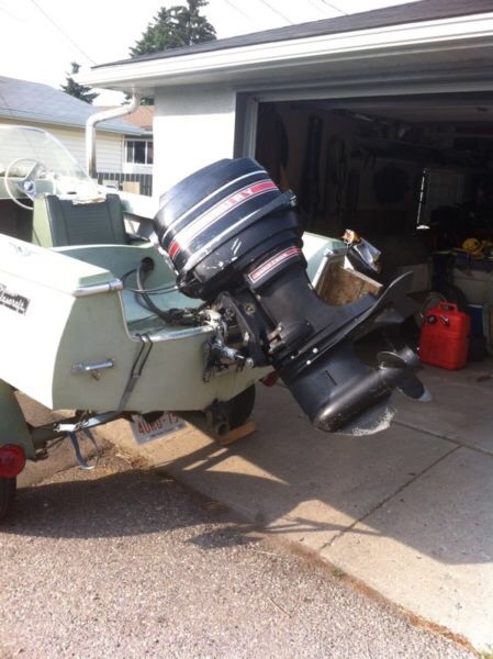

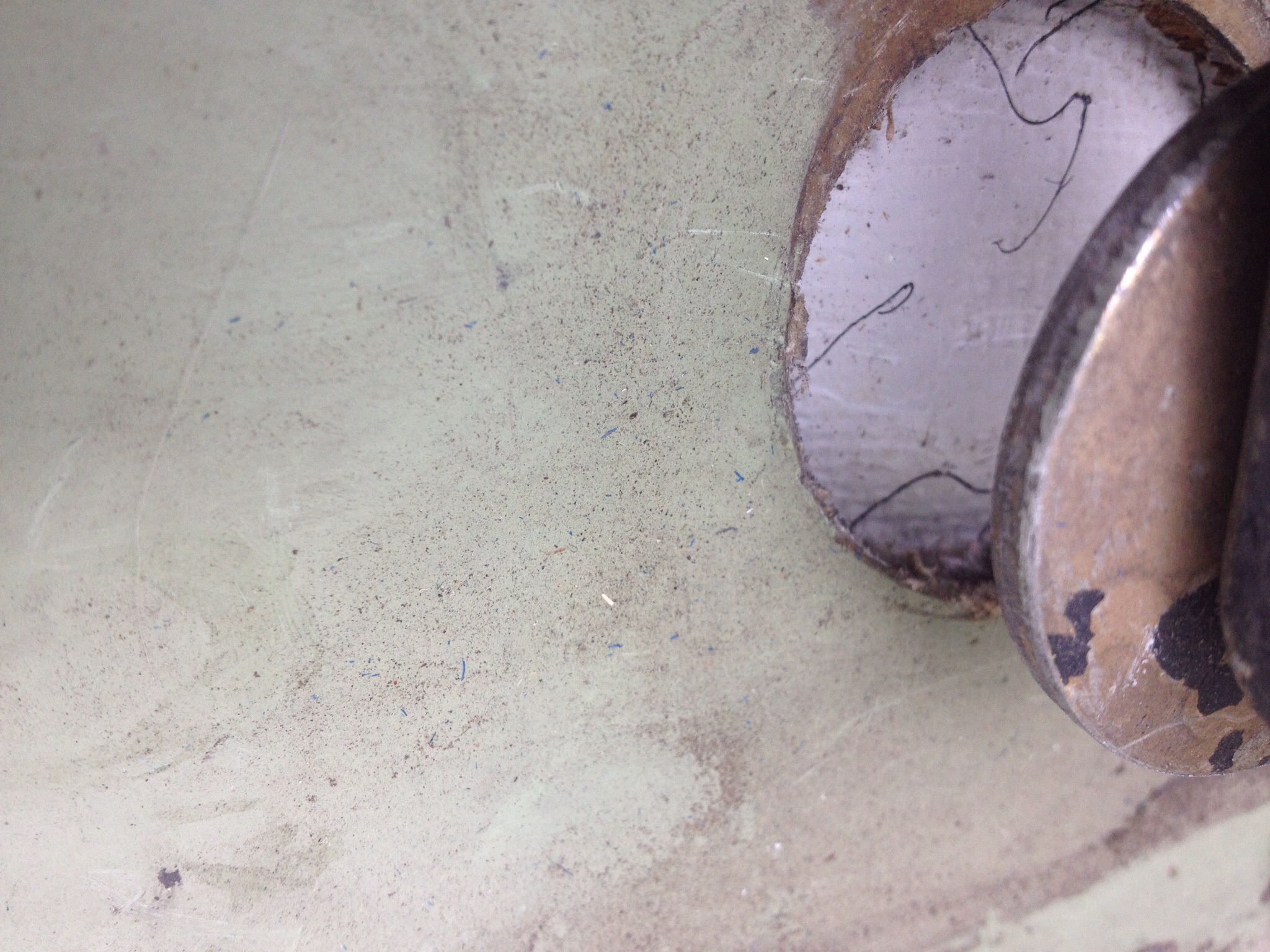

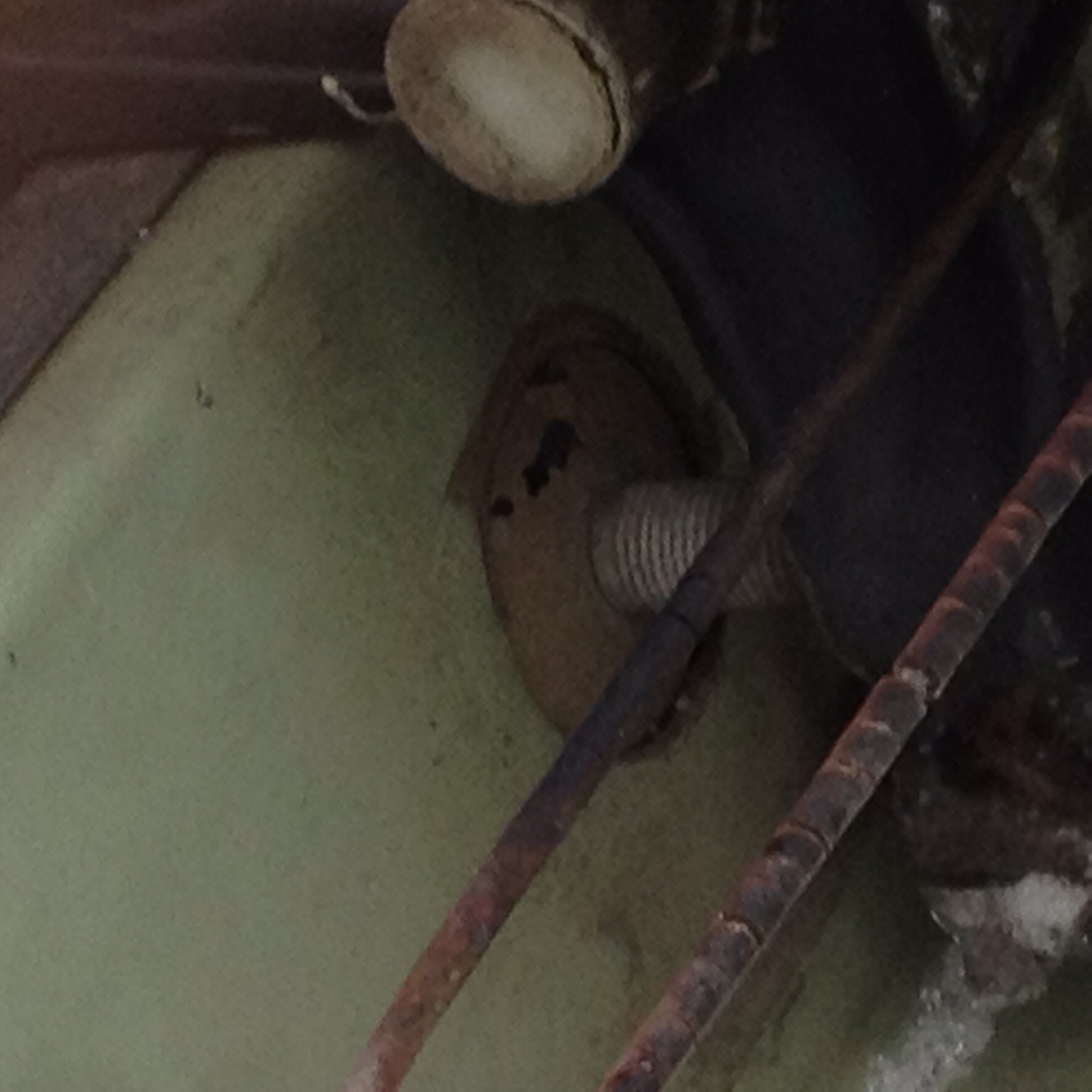

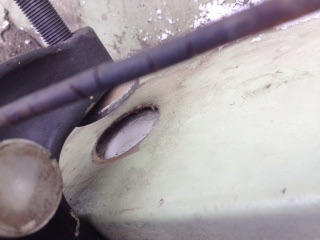

I just purchased a 1969 Hourston Glascraft with a 1969 Mercury 650 and after getting it home I noticed that one of the transom clamps on the motor has pierced the fiberglass on the transom. I need to repair this but is that enough or should I be putting a piece of stainless plate over the area to stop this from happening in the future?

Pull the motor and inspect the hole.Next I would take a 1/8" drill sample and see if its dry,along with removing if possible all through transom ftg and screws to check the wood in that area.If the rest of the transom passes the sound test then I would seal the hole and use a 1/4" aluminum plate/plywood/mud flap etc for the pads [which need to be replaced] to land on.Is that motor bolted on as well ?

So finally got a chance to look over the new boat a little more today and after jumping on the motor and checking for flex and tapping transom with a hammer all seems solid. The seats have come loose from the floor so I will have to repair that but floor seems solid as well, some of the glass has worn off the floor since 1969. I removed the one motor mount that I thought had punctured the transom and was happy to find that It only went threw the splash well and under there was a nicely fiberglassed transom. Also I removed some of the screws on the top sill and tried to push a sharp point into the transom but was solid. For me good news. Means I can actually use the boat this year for a bit instead of tearing it down over the summer in the driveway. I may take a couple of samples from the bottom of the transom from the inside but all looks well.
