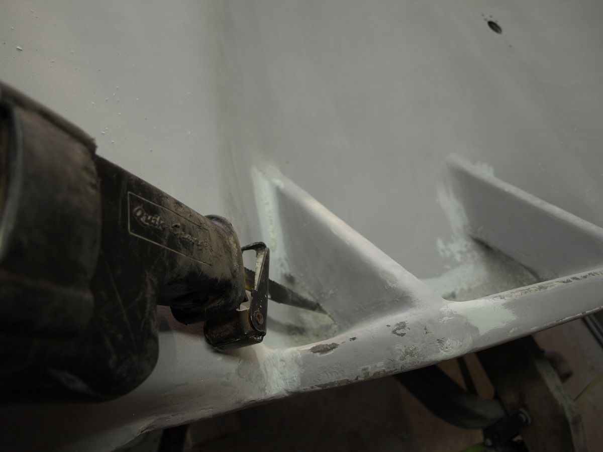

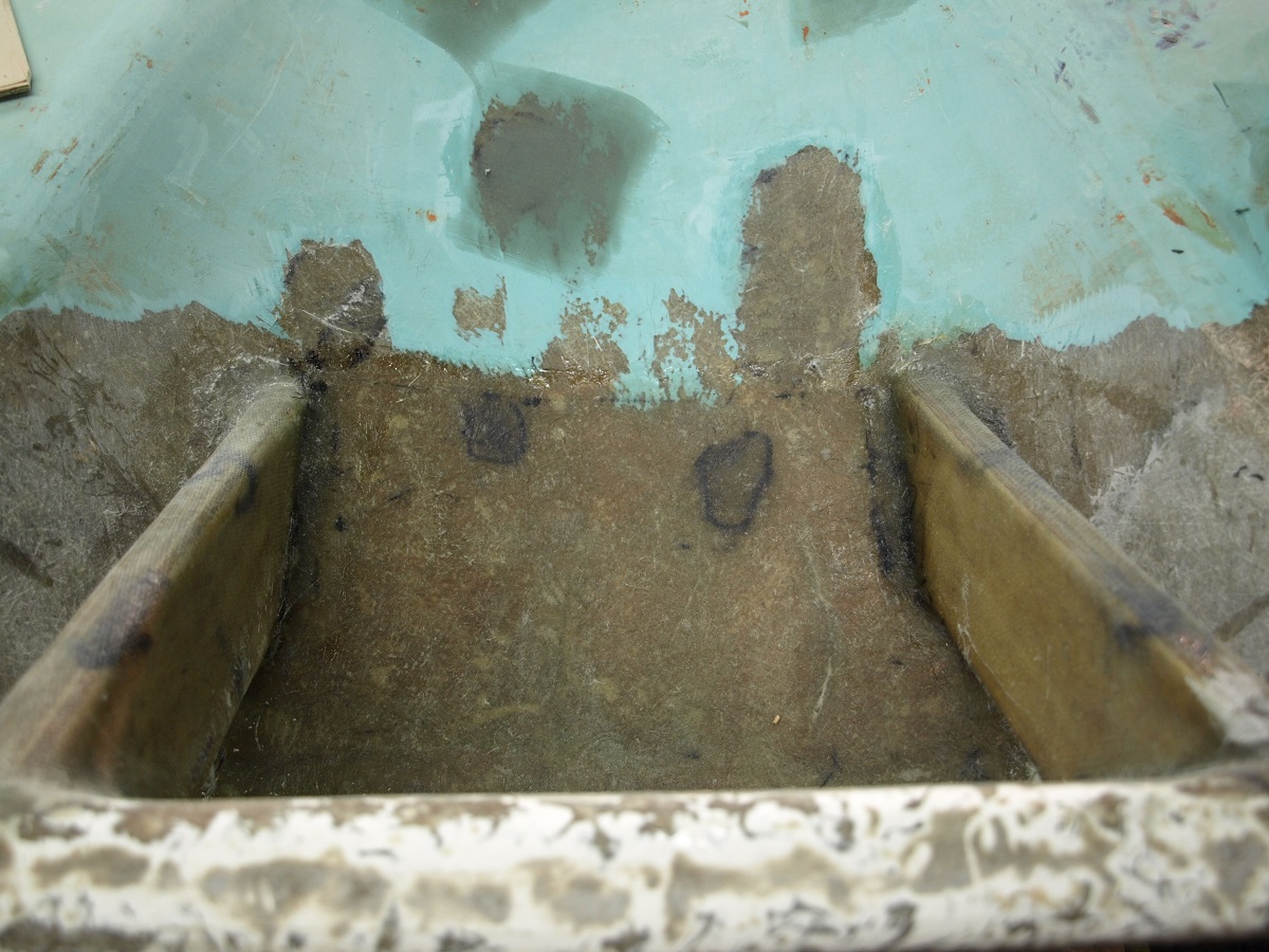

Couple of things. The fella up the road from me, 3 miles, has the nations largest collection of Switzers. Say's he's been called certifiable:)
He does have a hull of a '70 Glastron that he is willing to "let go" for $200. Hull only, no trailer or motor and it needs tons of work. I'll have to pass. He will never let one of his collection go.

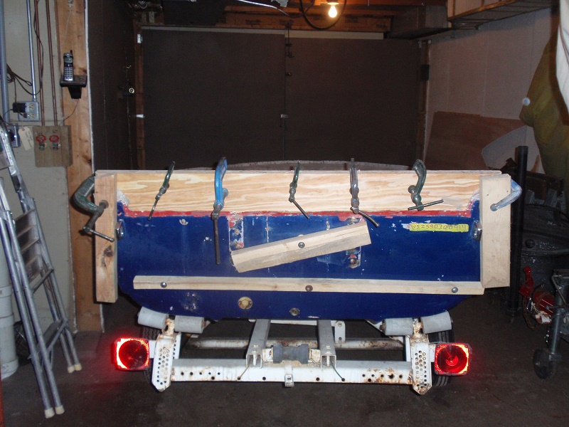

Other than that I purchased a '70 Crestliner, 14', trailer but no motor. This is the one I'm thinking of putting in a new higher transom. Won't know for sure until I get it home and do some measuring.
I know the pictures are small but the best I can do for now.

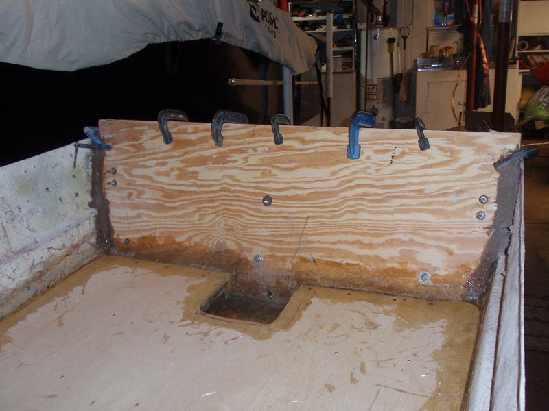

Re:Has anyone ever "raised" a transom? 11 years 7 months ago #104626

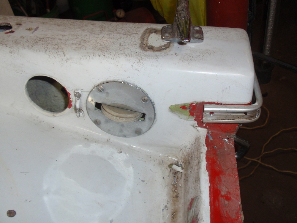

This is where the cut will be made.

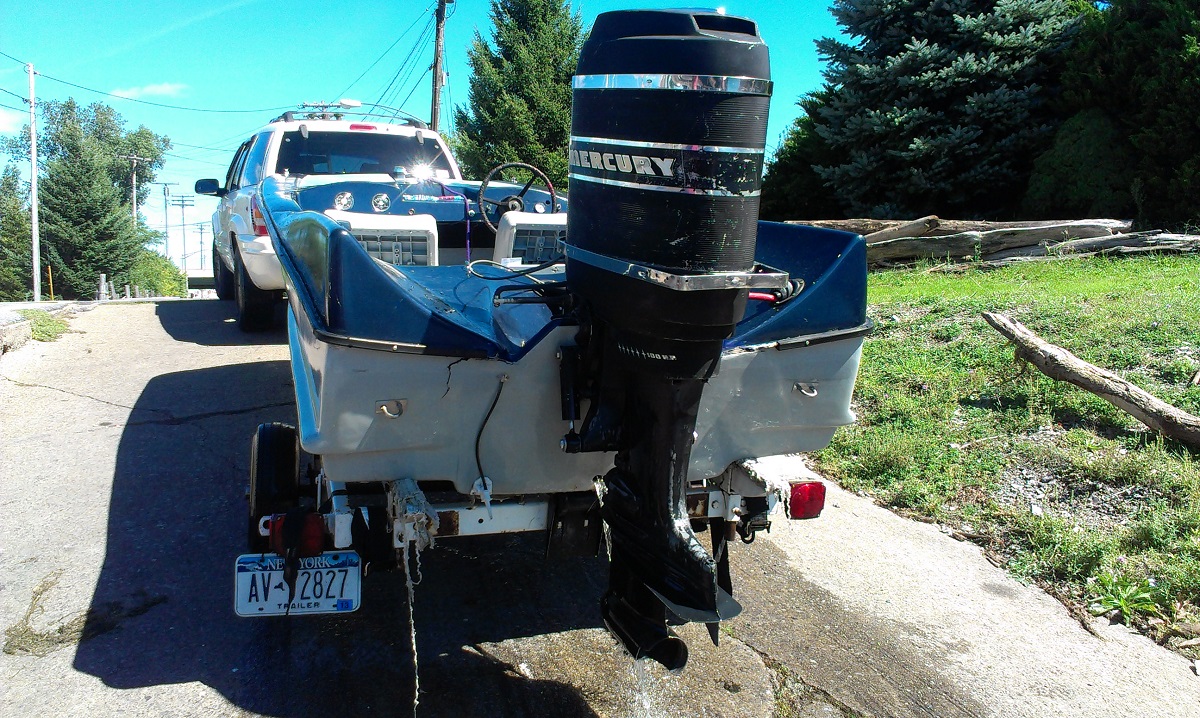

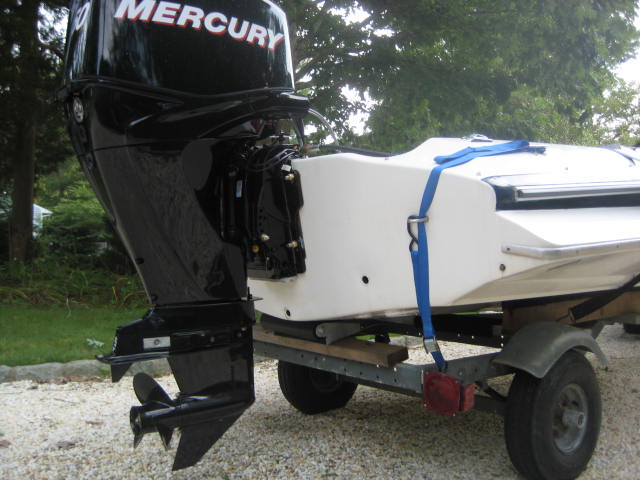

Rebuilt mine from 15" to 20 " had a 78 70 hp Merc on it... Now I have the new Merc 50 hp 4 stroke

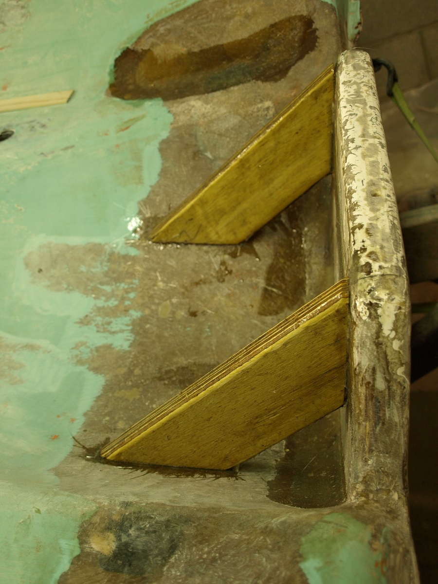

Heres a back view
Re:Has anyone ever "raised" a transom? 11 years 7 months ago #104900
OOOOO I'd like to try that one out fishing. :woohoo: If you have to totally rebuild the transom and it can be done without making it look "Goofy" as stated above ,I would do that. Goofy is a good word for some add-ons I've seen on boats. Remember that homemade cruiser someone posted a few years ago with a spliced on truck cap? :P :ohmy: :unsure:

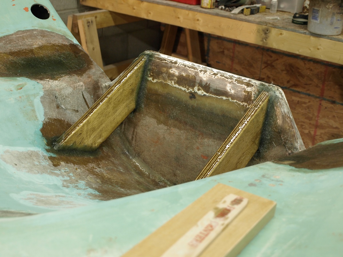

I like the way you shaped it, seems to flow with the lines of the boat.

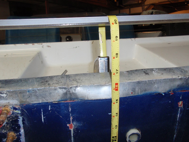

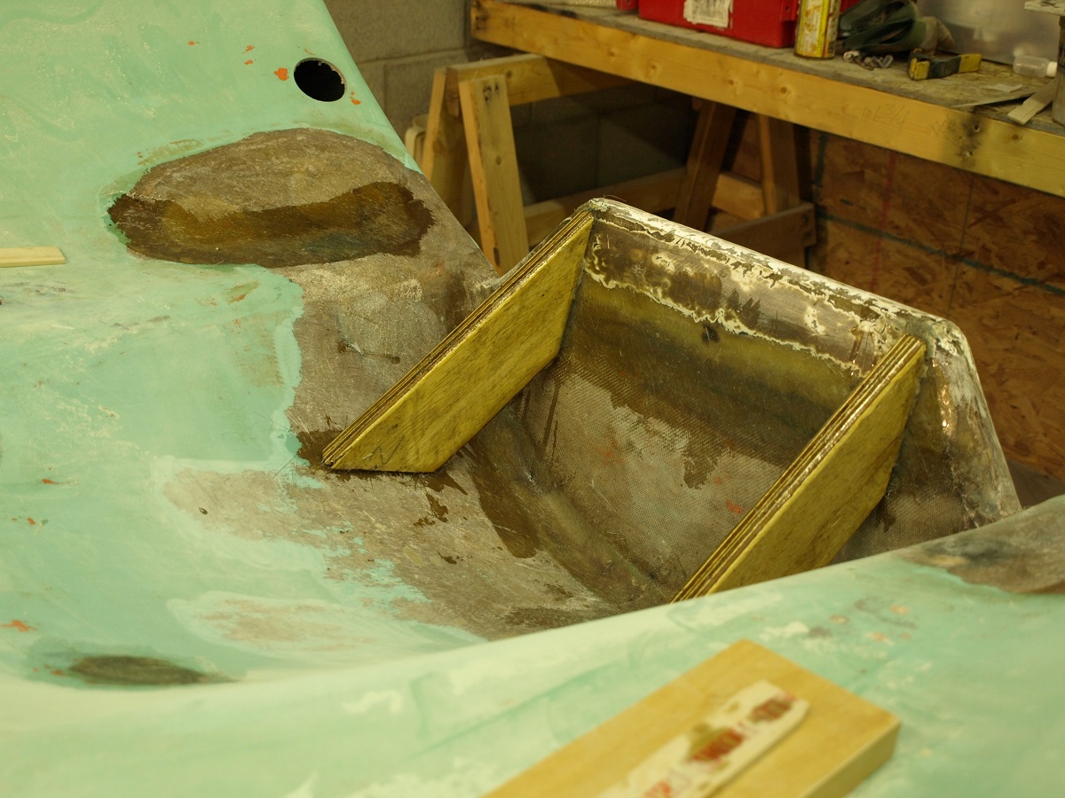

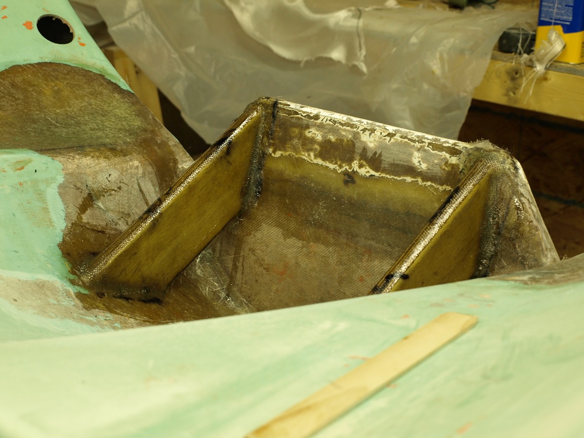

I'm still in the install phase waiting for the 5200 to set up. Keeping the blocking on it for a week.
After seeing your design it's making me rethink about cutting out the corners of the cap and maybe just curving back up or maybe even just "slitting" the transom in those corners and sliding the cap back into position. What/how did you top off the new transom to blend it in?
The final picture is the measurement using a straight edge across the top of the original aft corners so the transom would be straight across after the surgery.

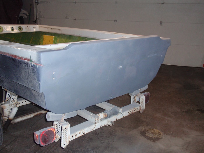

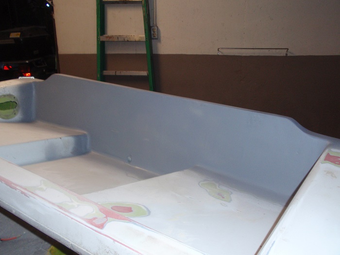

Finally was able to do a little work on the transom the past few days. Got a thin coat of hi-build primer on it to show up the flaws to be fixed or filled in. It's a start. Raised it to 20 1/2" and it doesn't seem to be an outlandish hump.
Question I have is what do you guys use to cap off the top of your new transoms? There was a mashed up aluminum strip across the old one but it was beyond salvage and something needs to be put on there so the motor doesn't smush it. I can get another aluminum strip but I would prefer something that curves over the edges a little.
Like I said, it's still needs work.
Re:Has anyone ever "raised" a transom? 11 years 6 months ago #105500
Looks awesome Cal, great job. As for the top I cant help much, mine is naked with varnish. On the Clipper that is not the Century lol ;)

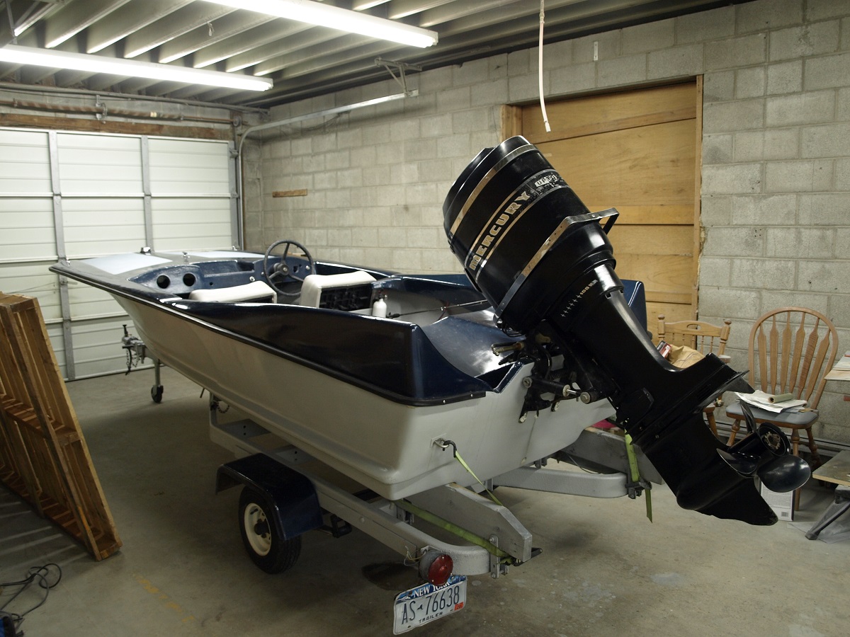

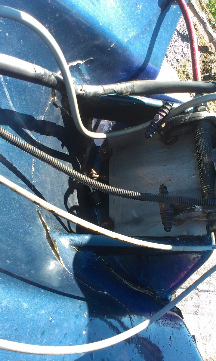

Here are some pics of mine:
Here it is after my "incident" with a rock in the Niagara River:
Extension and knee braces held up just fine, lower unit not so much:
Dave in sunny Buffalo

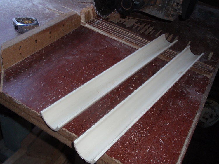

I'm also experimenting with making a cap out of PVC by sawing a pvc pipe section in half and using my heat gun to shape it. Could be interesting.

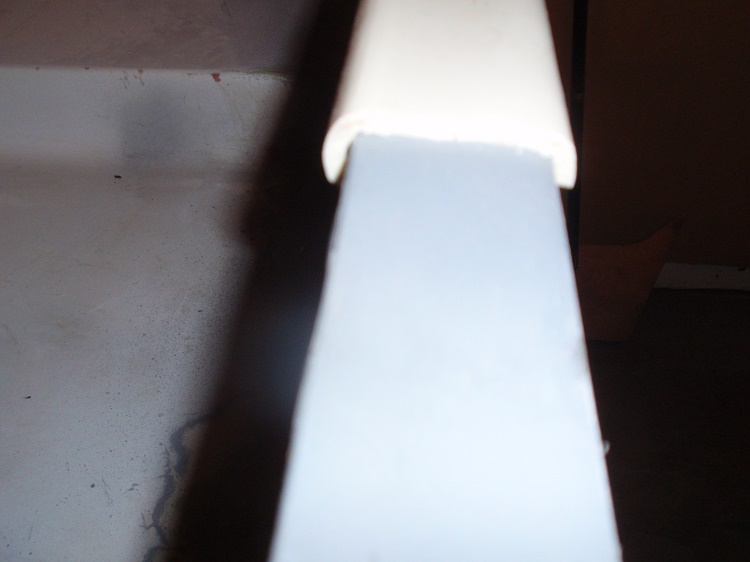

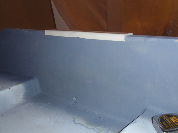

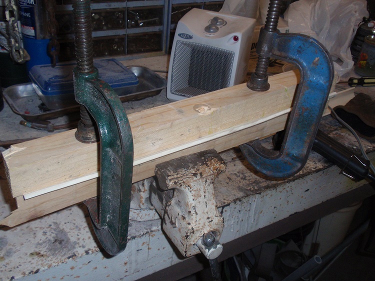

Spent a some time "sperimenting" with a short piece of PVC that I had laying around. I cut it in half, using the heat gun will turn it into flexible rubbery easy to work with stuff but it gets hotter than blazes. Heated it up pretty good and then mashed it between two scrap pieces of 2X2. It cooled in about a minute and held the new shape. I then heated up the edges and bent them over the edge of the 2X2 and clamped them for a minute. It came out an almost perfect cap shape. This was schedule 40 PVC, fairly common stuff. since this worked out better than I expected I'm going to pick up some lighter PVC drain pipe and do a section the length of the transom.
Cut in half with my old radial arm saw.
Clamped with 2X2's after heating.
Pretty good fit over the transom if I do say so myself.
