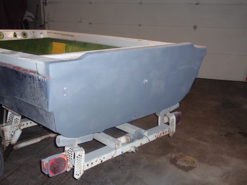

Looks good, was that just and add-on piece then the metal plate or was the whole transom replaced?
Here's what I finished up doing with before and after pictures.

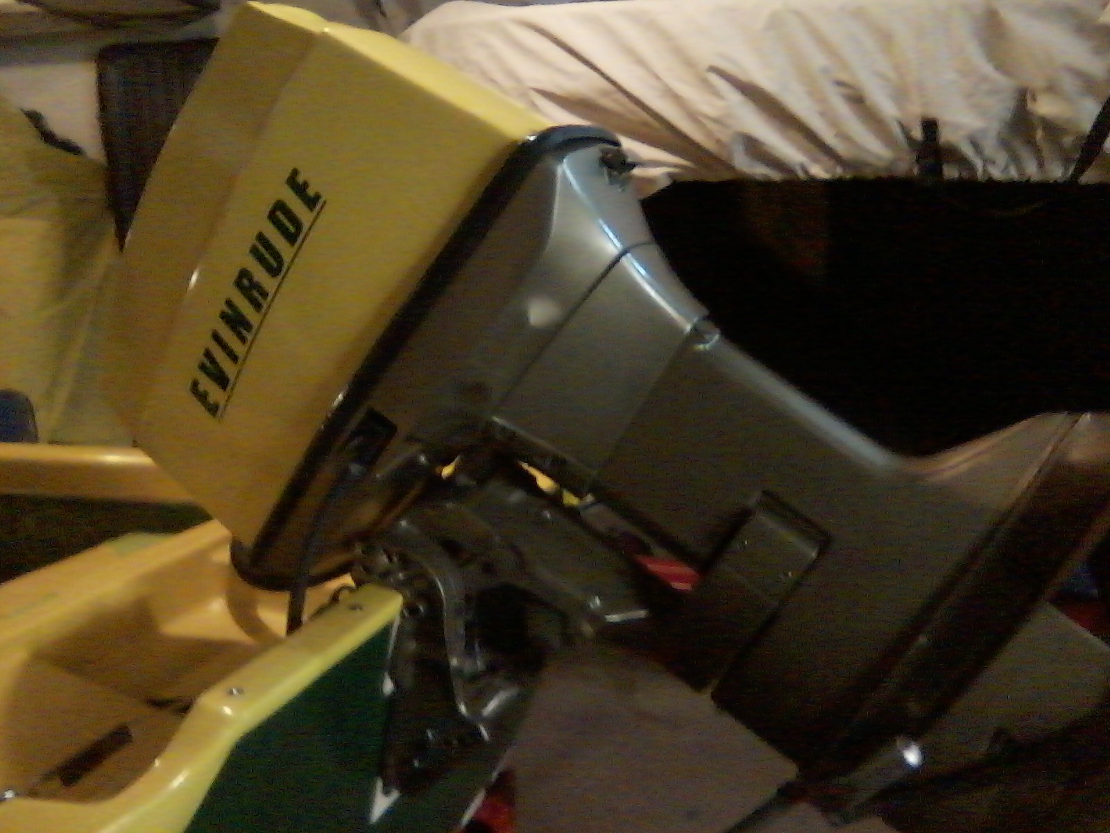

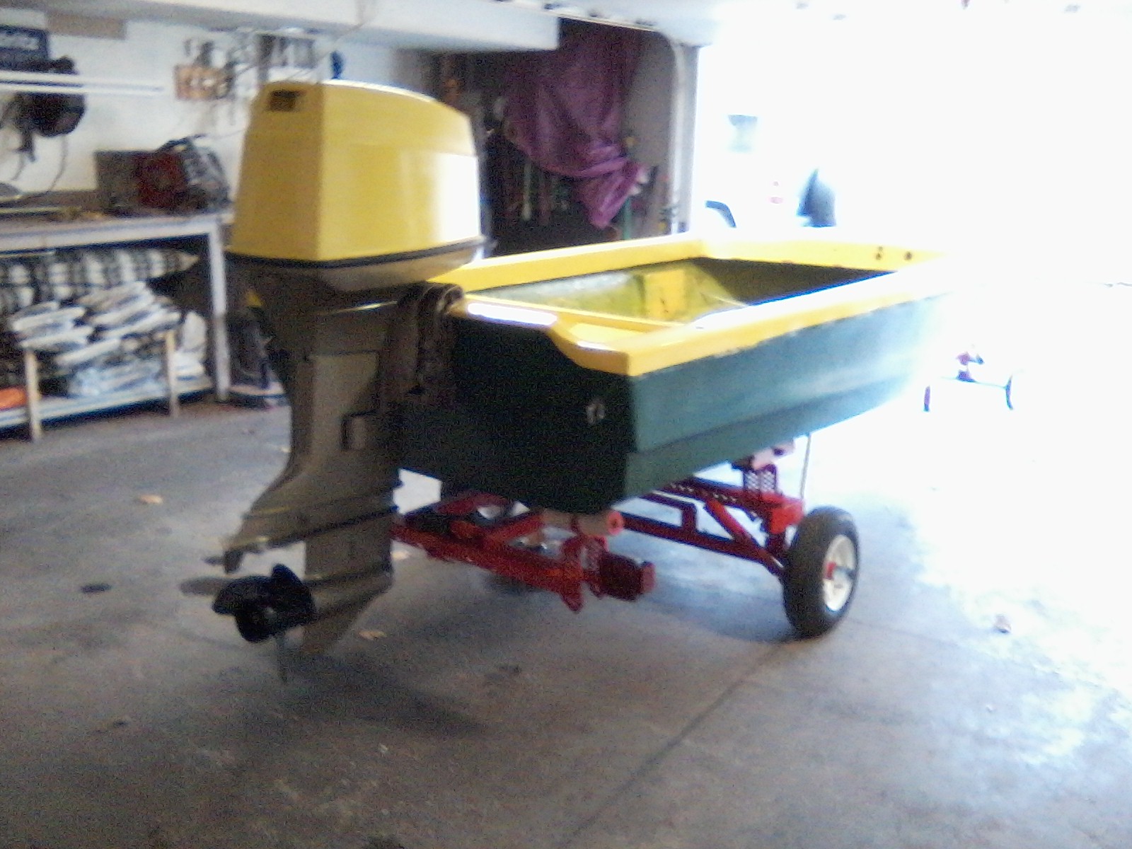

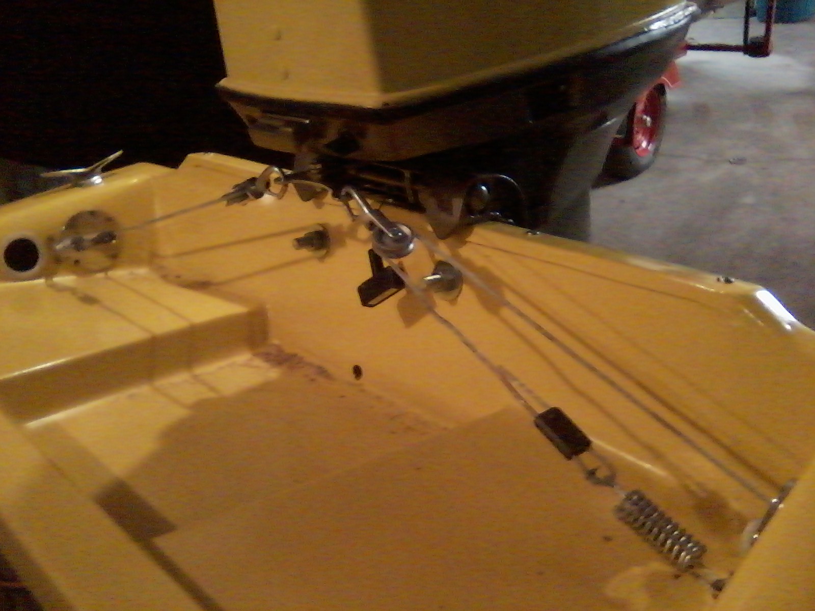

Re:Has anyone ever "raised" a transom? 11 years 3 months ago #107331
Finally hung the motor on the new raised transom Friday.
Saturday was hooking up steering cables, about 2,000 tries before finally getting it right. Higher angle on the cables but nothing is binding.
Sunday I finished the steering setup. A one off of old parts I had laying around.

Re:Has anyone ever "raised" a transom? 11 years 2 months ago #108039
Time to finally put this project in the books and set up on Craigslist. Got the graphics from Fastsigns, $26.
To add... I did top off the new transom with the PVC and it turned out great.
Re:Has anyone ever "raised" a transom? 11 years 2 months ago #108040
Looks great. I hope someday my Evinrude will look that good. The transom looks factory.
