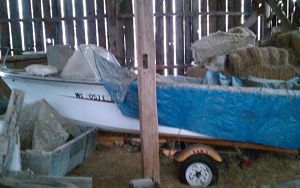

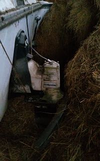

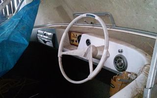

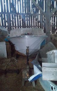

Here are a few pics. Not the greatest but all I've got at the moment.

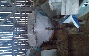

The 'ole Renault still in hibernation.
