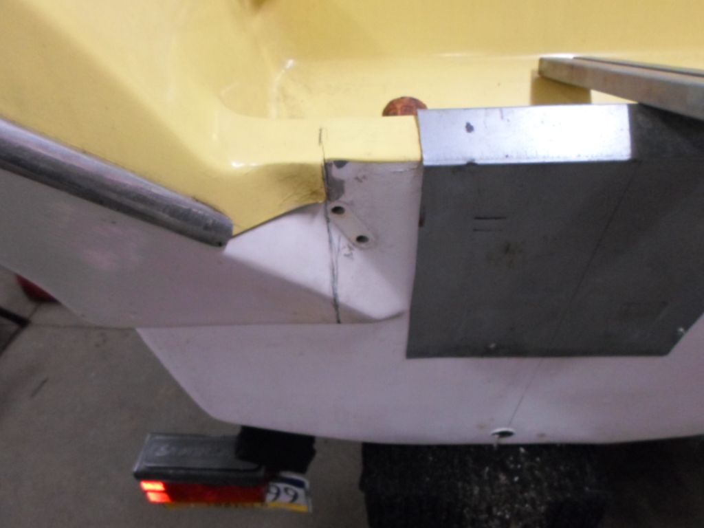

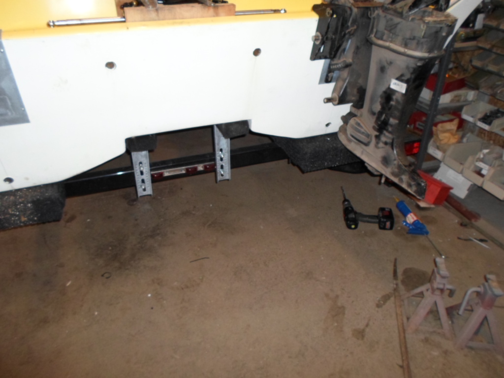

I have the PowerCat up at Tim Calms' getting twin merc 100's. Getting anxious to have her back. Have a pole building going up in January so I'm hoping to have her back in there shortly after to install a floor and seats, lighting, and other goodies.
I'll need to get 2 tachs and a speedometer.
Tim's mounting part of the floor under the splash-well for me so he has a place to mount the power tilt/trim motors. I'll probably put a bench seat across the back. Putting 2 15 gal aluminum tanks in the sponsoons under the floor.
Had to have part of the 'glass over the transom trimmed to fit the width of the tilt brackets, that's what you see in the one pic. The other is just of her with a leg hanging for alignment.
Glad Brian built the heck out of that transom! This girl's going to be a blast!

Heard from Tim the other day. My 18DC is close to coming home! Unfortuantly, her pole building won't be ready till spring. We broke ground and got about half the fill leveled when the rain and freeze hit. Oh well, I have about 5 more parking spots because of the hill we removed!
He completely rebuilt both motors. One needed a new block because all 6 pistons were burned. Looks like someone put 3 carbs from a 900 merc on my 1000 and advanced the timing way to much. It needed complete rewiring, plug wires, distributor, you name it! No real gaskets anywhere, someone just used gasket sealer. Oh, and there was black gasket sealer stuck all over the crank shaft from it oozing in. Just a total mess of a motor. The other one needed a new leg, that was the one with the frozen pivot. So now it's blue in the middle! I told him i could do all the cosmetics when i get her back.

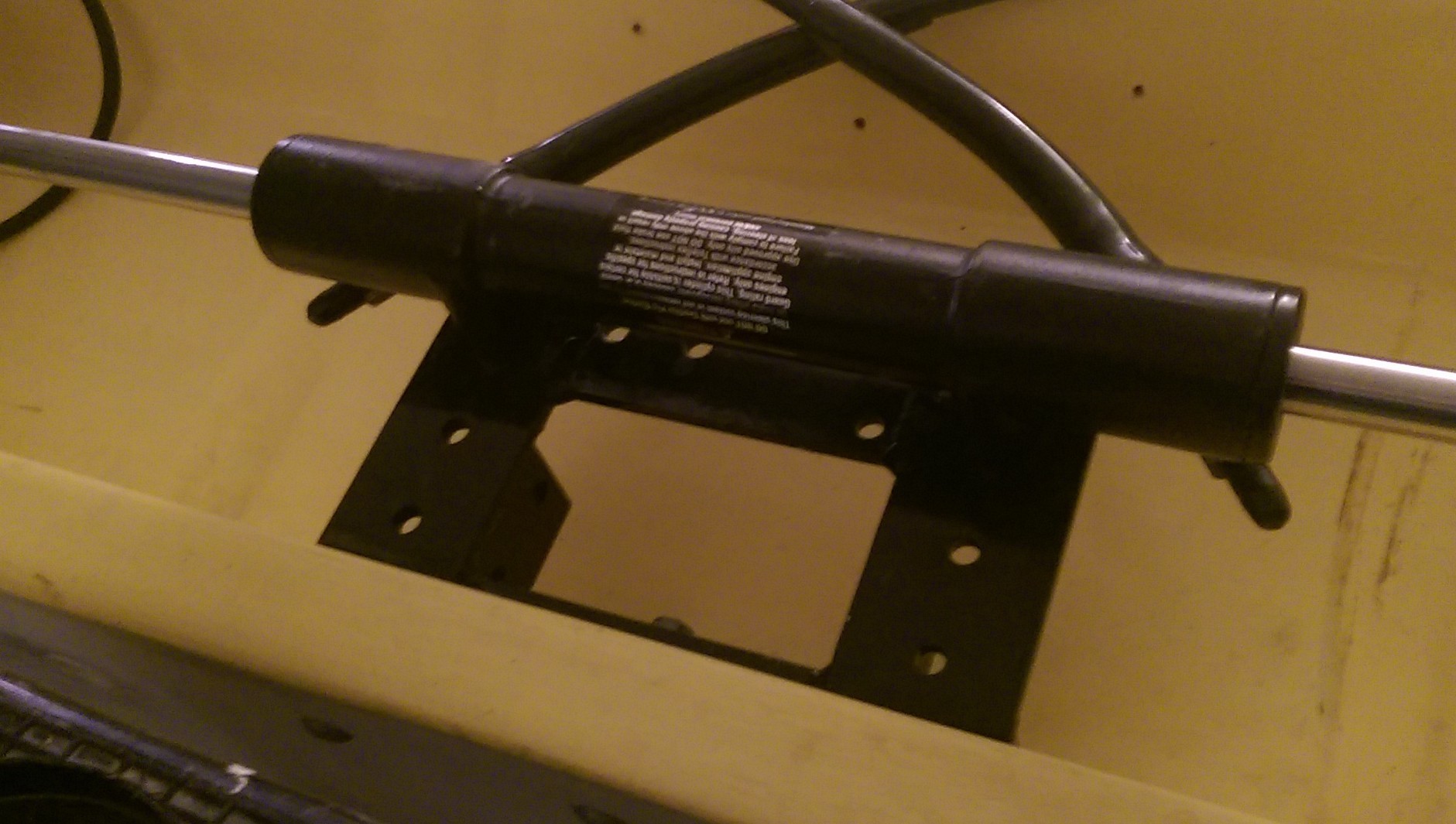

He built a custom mount out of aluminum for the SeaStar hydrolic steering. I installed the piston and helm, but the piston was just mounted temporary until the motors could be put on.
Hopefully by this time next weekend i'll have some pictures and better info on what he has done. Then i can get started on the electrical, gas tanks, floor, and interior. Looks like my car will spend this winter in the drive way like last year when i put the floor in the Chevron.

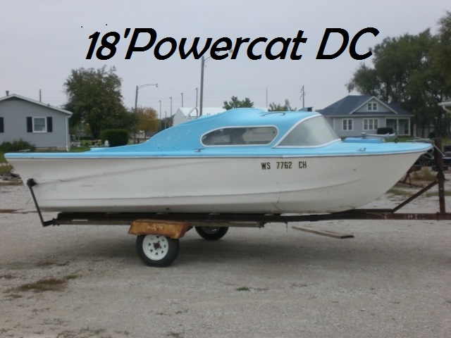

Nice boat, they are a good ride you will enjoy it,,I have a 18dc but don't know what I am doing but I have rode in an 18 before,, good luck looks good Bill

Bill, Right back at ya! I prefer that blue over my yellow. Don't get me wrong, the yellow is in good shape, won't be changing it any time soon.
Every time i se an 18dc, it's missing the windshield. If i don't get one on, i'll need goggles running those 2 100's.

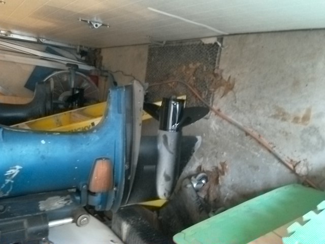

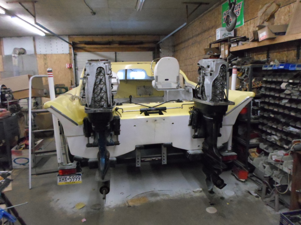

So took my dad who's 79 and a buddy from York PA to Castile NY on Saturday and brought her home!

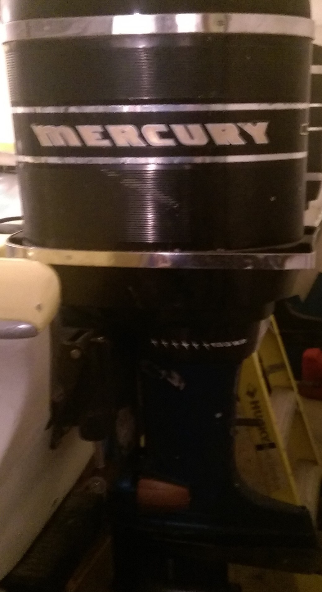

Tim gave me a list of stuff to finish. Brake in and tuning. Both motors were rebuilt 100%. New carbs on the one that had carbs from a 900. He rebuilt the electric motors and pumps for the power trim. I got 2 aluminum 18 gal tanks from him i'll put under the floor.
This is the motor that had the stuck pivot. replaced the whole leg with one that works, but it's blue! Oh, and it needed a doner block.

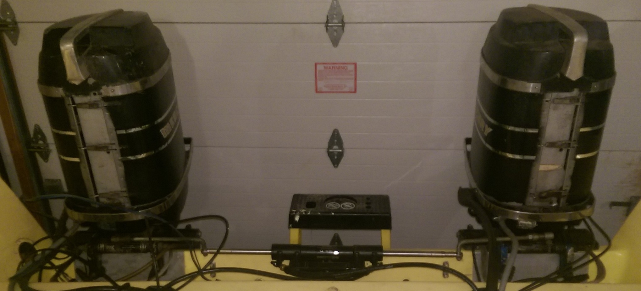

More pics...

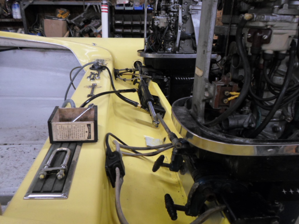

The hydrolic steering.

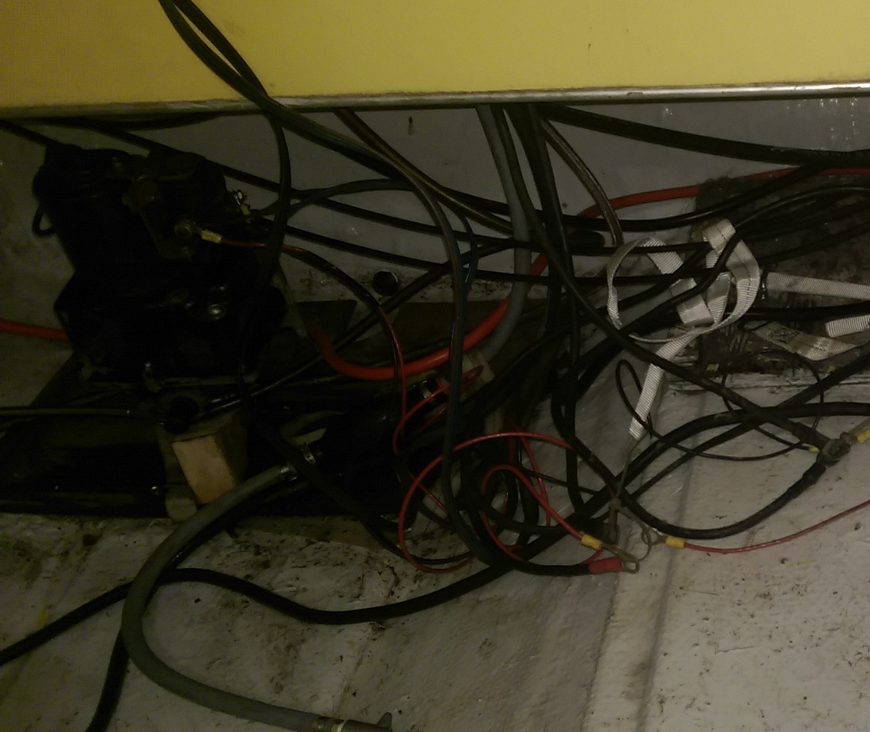

The tank that'll go under the port side floor. Need to figure out how i'm gonna do that:
It's a mess now, but it works. The pumps will be mounted after i do a floor.
The Twins!

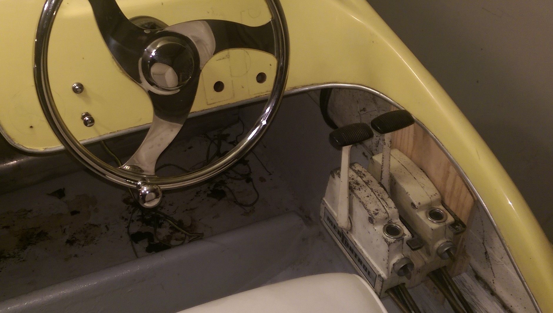

Can't have twins without twin controls.

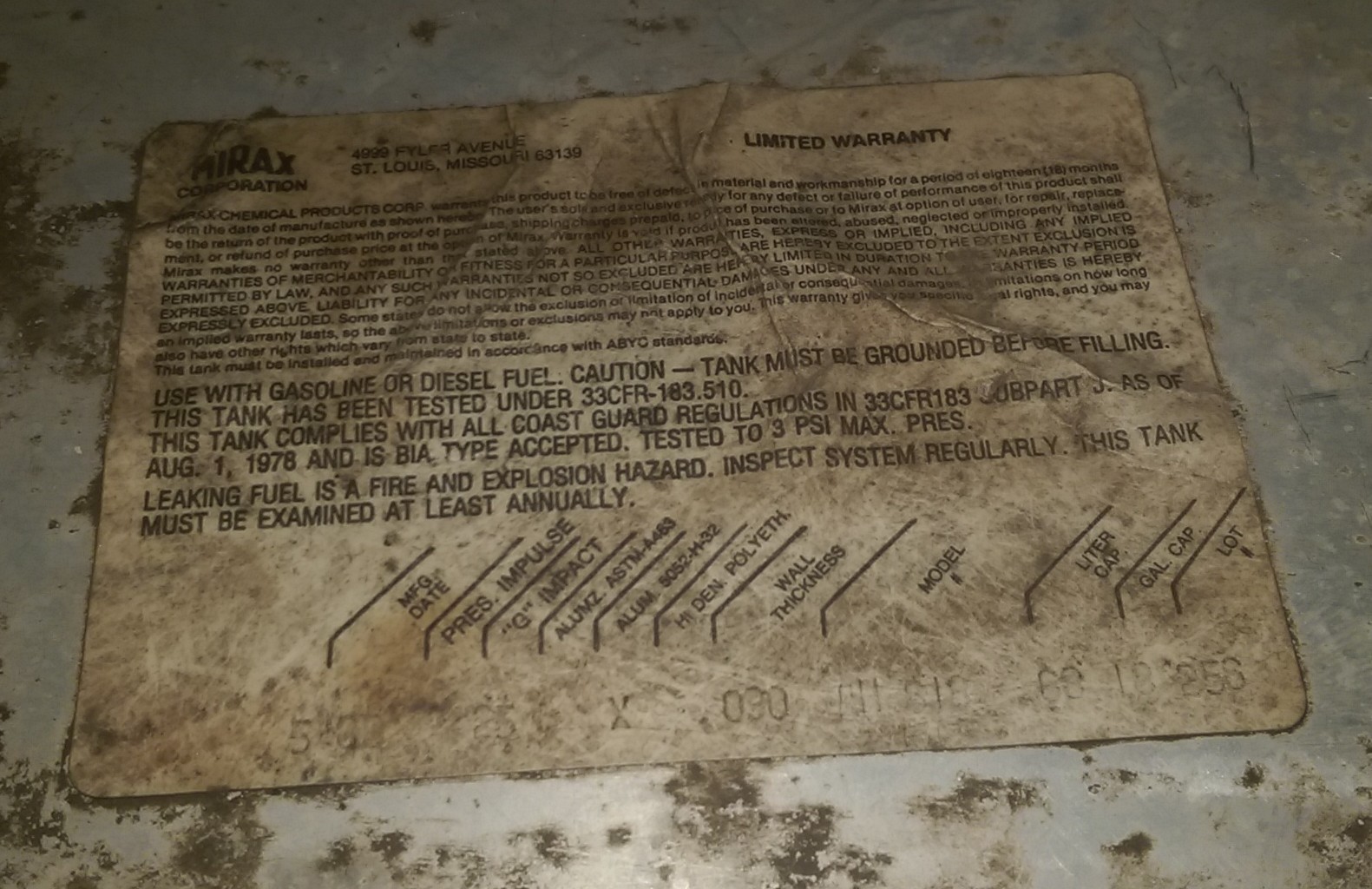

Gas tank label

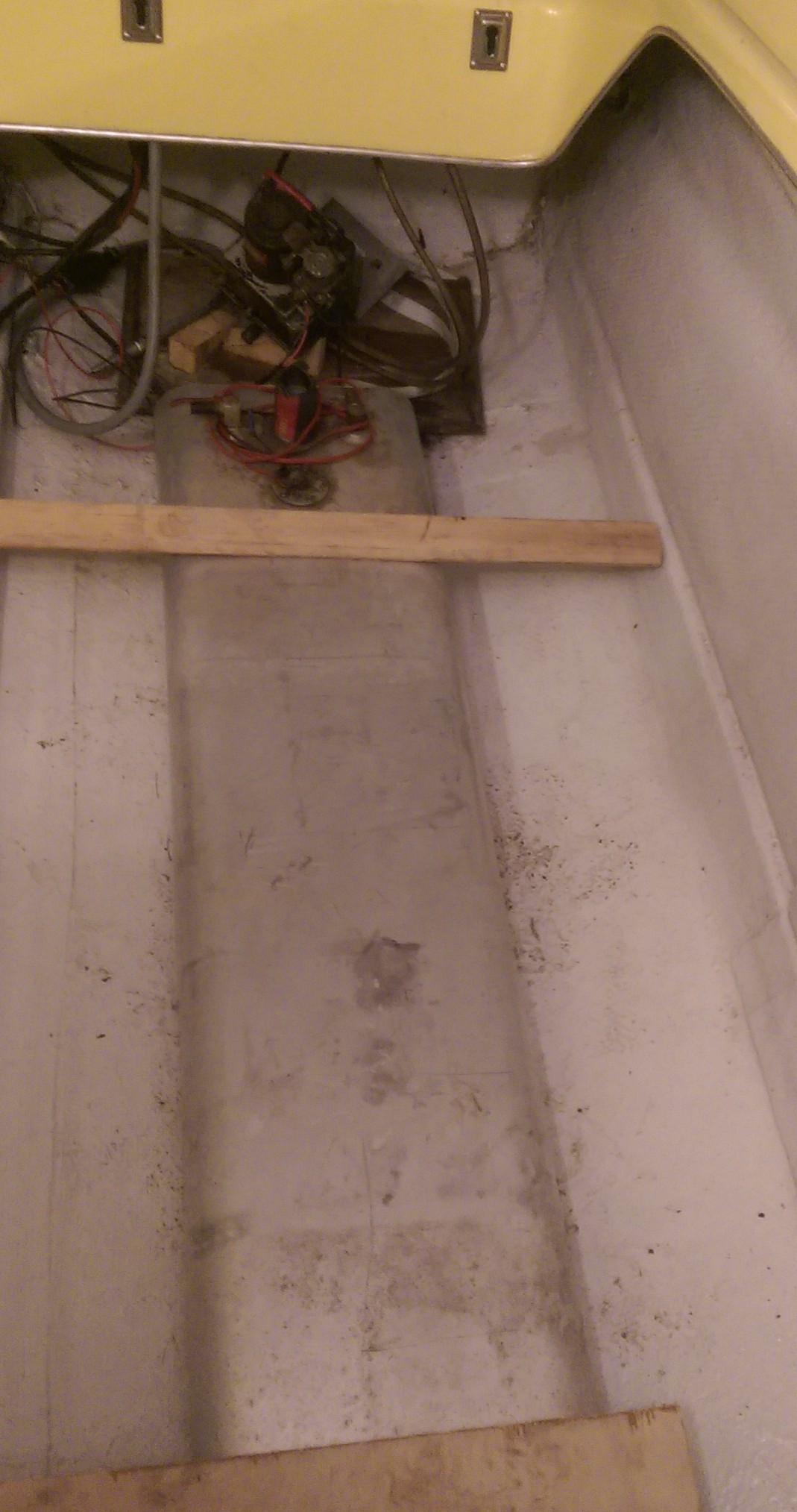

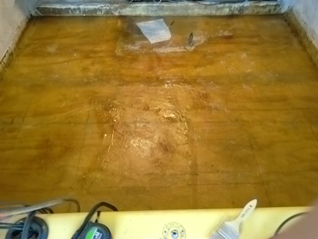

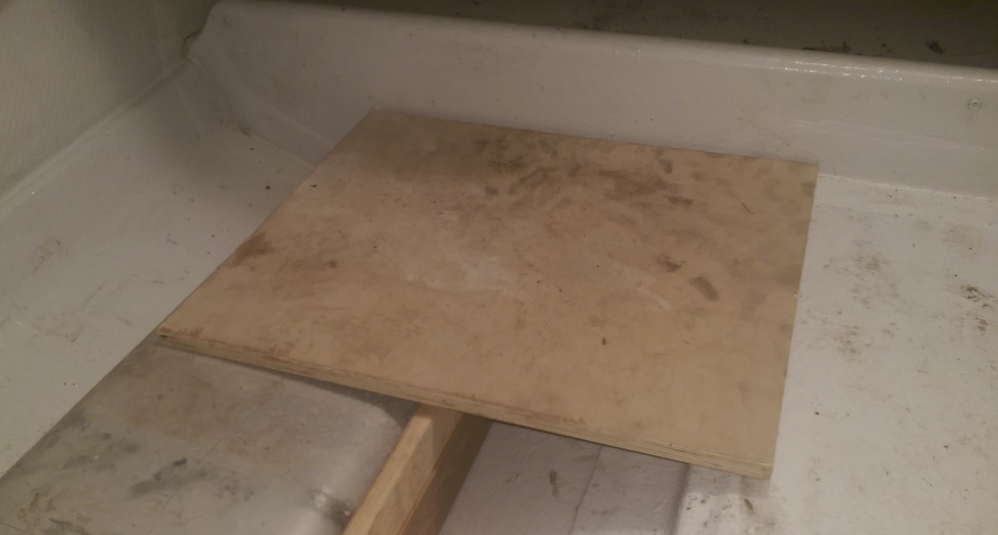

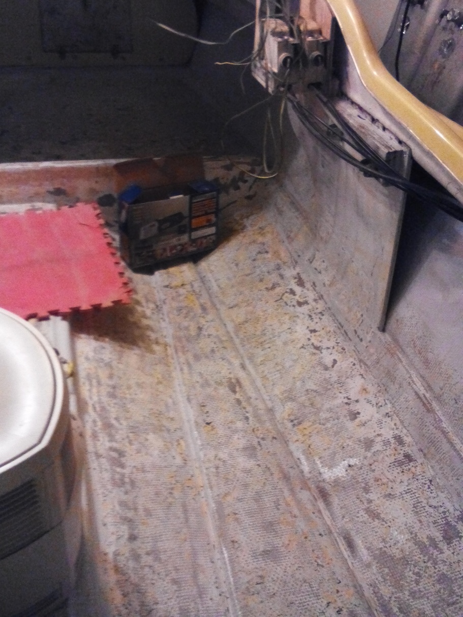

Spent yesterday sanding down the floor paint in prep to add stringers and floor. I vaccumed all the dust. Should I wash it before glassing in the stringers or just wipe every mating surface with acetone?

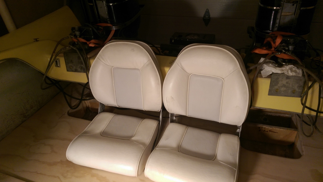

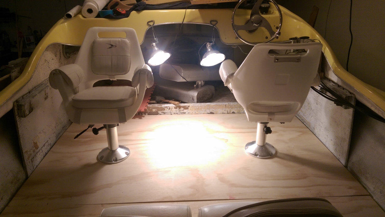

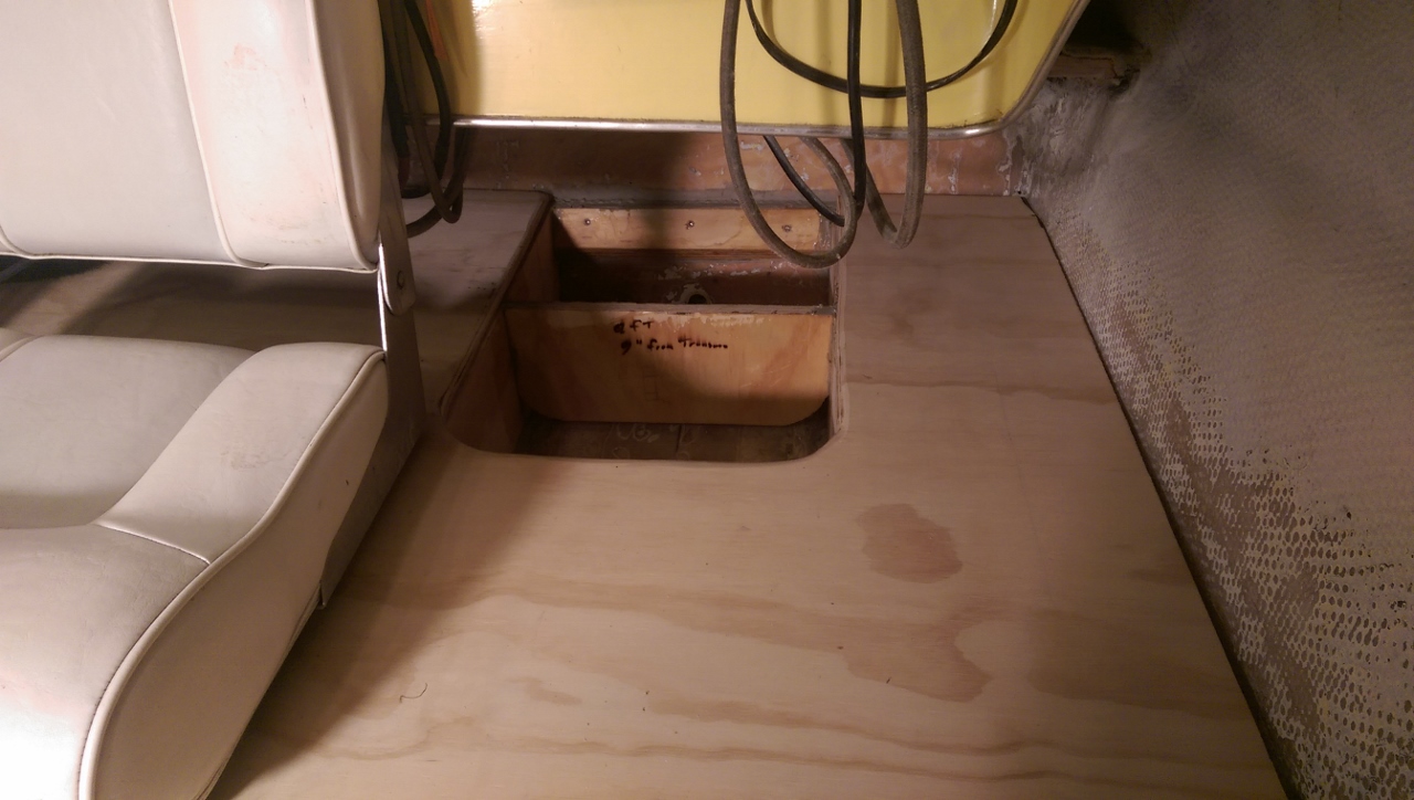

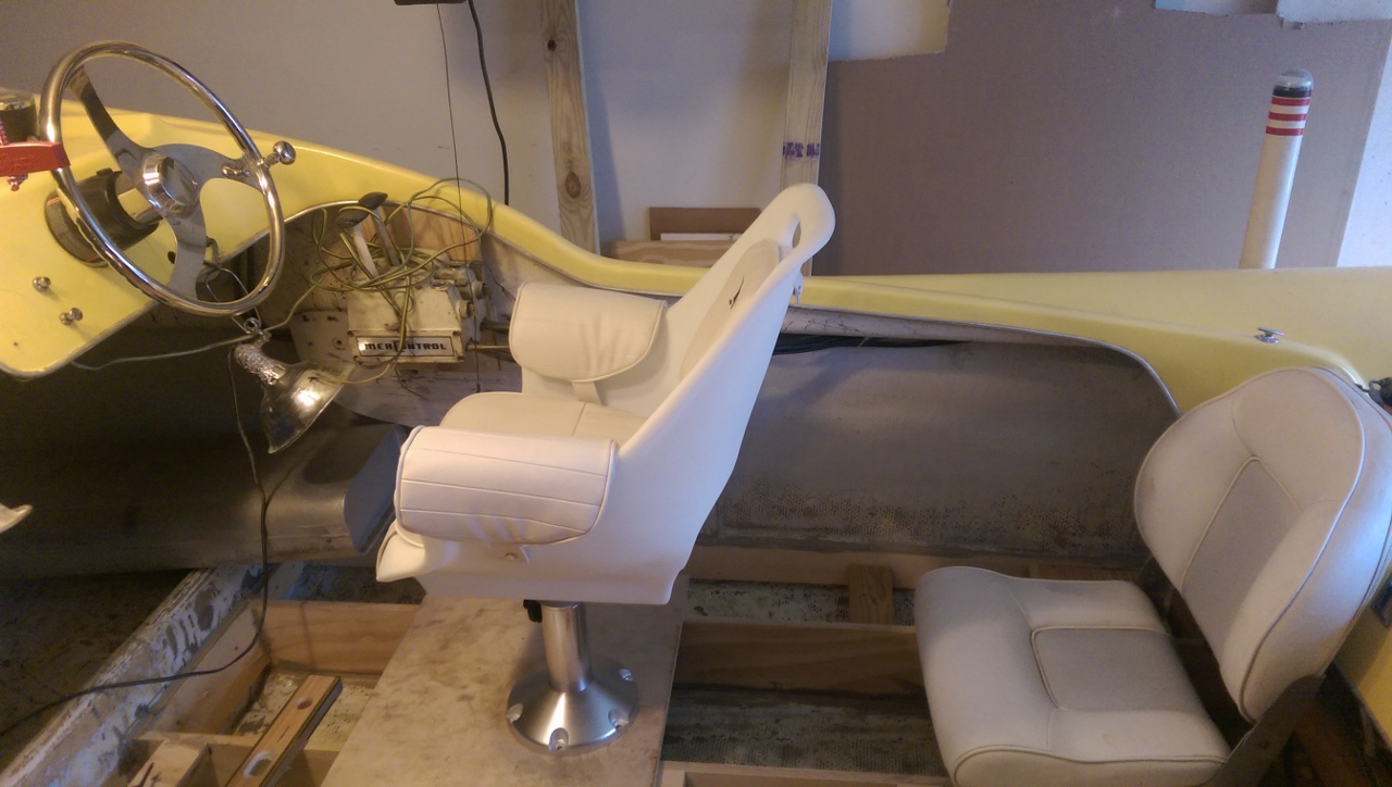

So i have the stringers glued in and the floor fitted! Now i need to remove floor and start 'glassing things!
Here you see the seats in place. But that rear jump seat is a bit to big. I'm going to put in a bench with a box below for the batteries and such.
Here's the two seats and the floor sitting in place.
The two seats in the rear and the bilge access area.
Close up of the bilge access area. The front half of that will be where the connections to the gas tanks will be made. The rear will be where the bilge pump is, and the plug in the transom. There is an access like this on the other side.

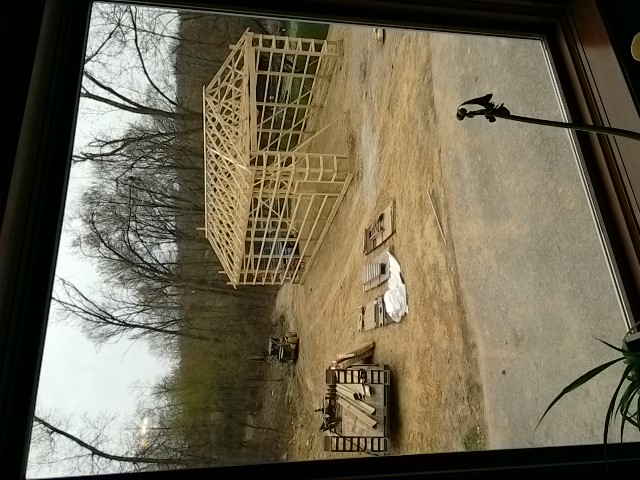

My pole building is almost up. Was supposed to be in last year but the ground froze. I wanted to have it up for this project so I wouldn't hit my head on the door opener so much! Well I can do other parts of her in there. Like the bench seat. . .
