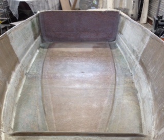

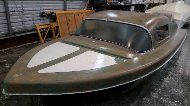

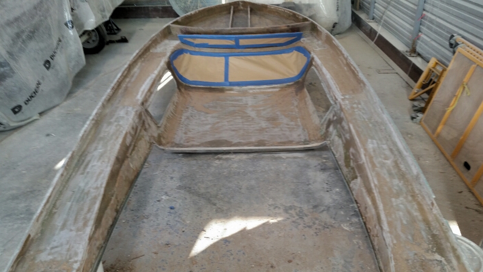

New stringer ,new deck.and new transom .i have to cut the deck off cause I want to flip the boat over to do the work that is require on the underside of the hull.

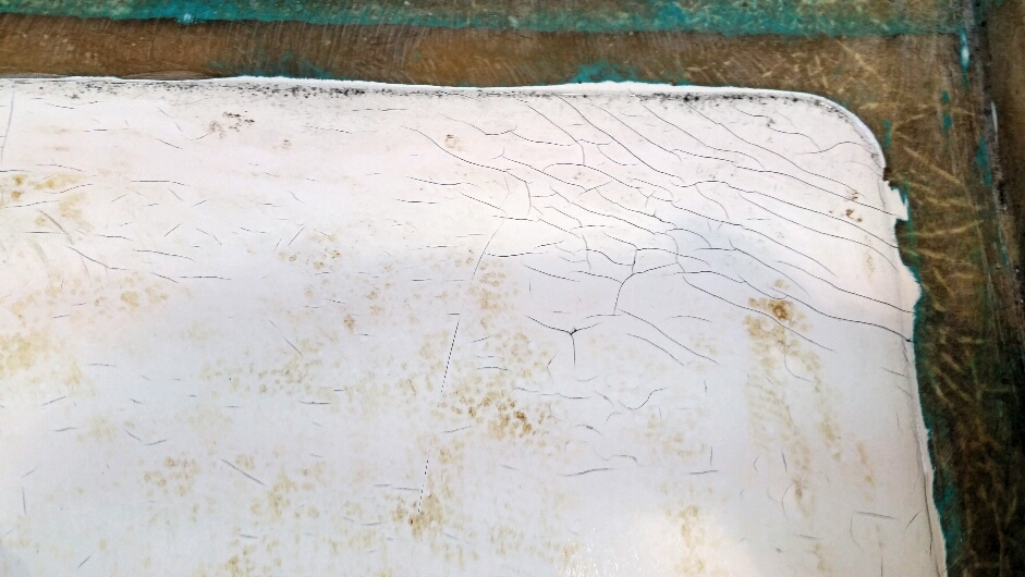

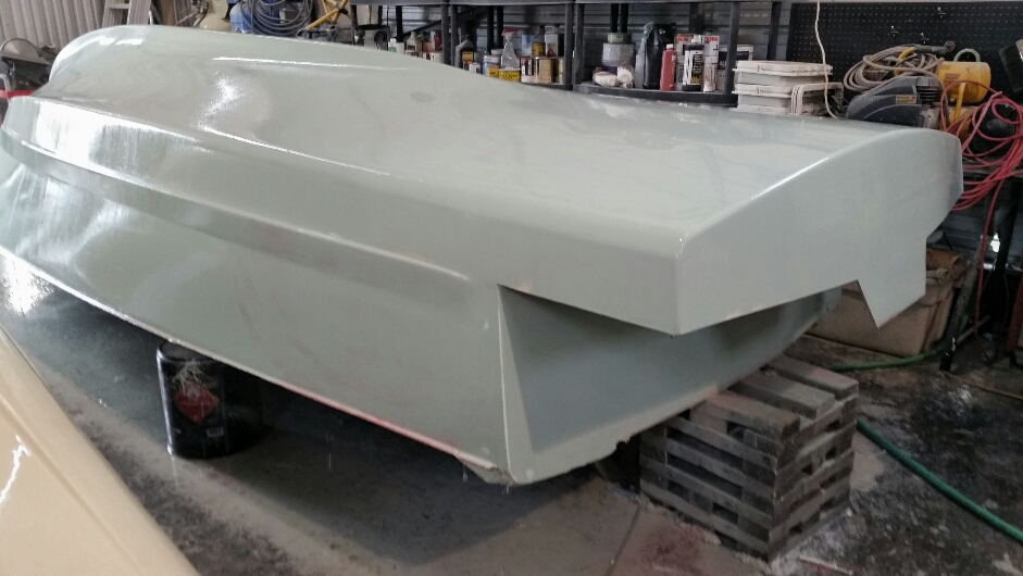

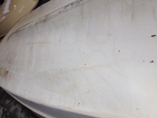

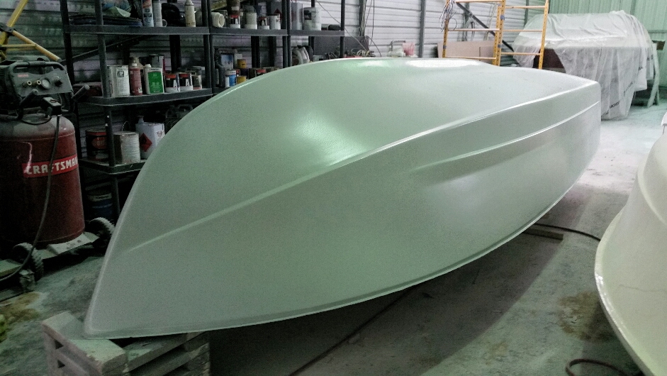

So I flip the boat over today ad found a lots of crack on the gelcoat so I think it is better to sand it down and reglass the whole bottom again. The boat in the back is a 1959 Larson senior not mine belong to a friend I'm just doing the work for him.

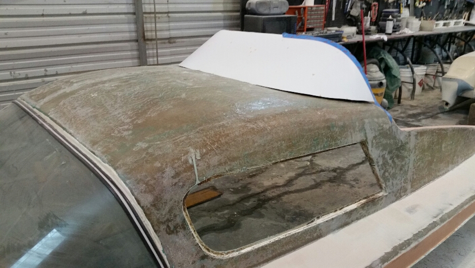

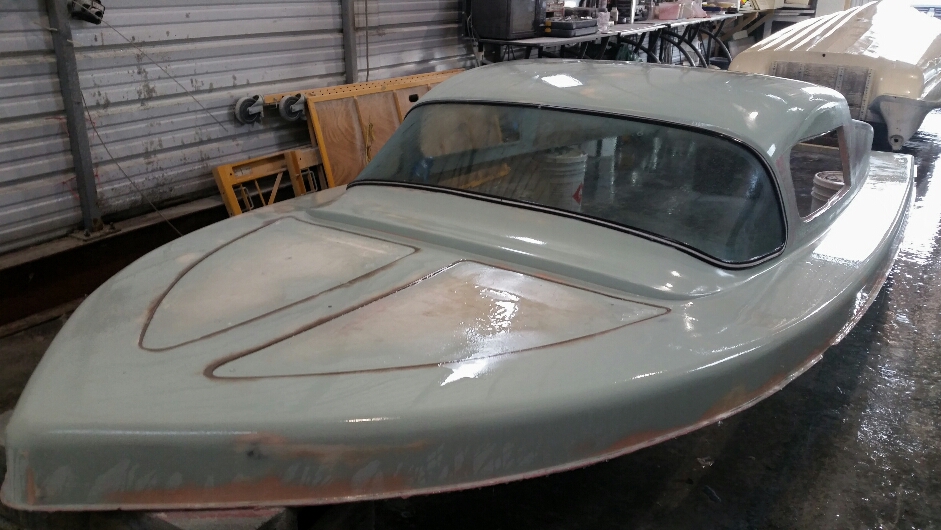

Got more work done she got a coat of gel coat on.i had to grind all gel coat off the deck cause it was cracked everywhere.

For the deck I finish glassing the top side with 1 lay 18oz woven and 1 oz mat the flip it over and replace all wood reinforce then i glass it all in then I gelcoat it.

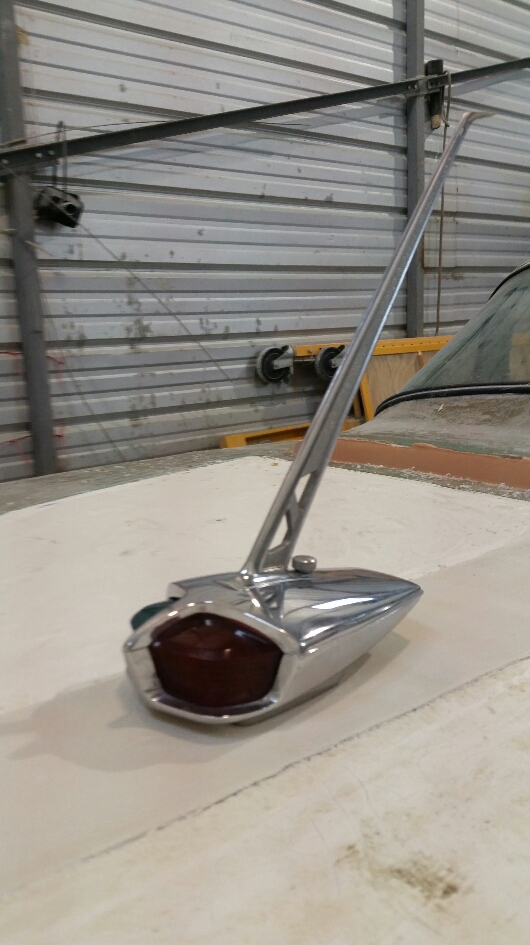

Ran out of filler today and it's weekend so I couldn't do any body work and hull is not ready to sand down yet for 2nd coat of gelcoat so I fiddle around with making a mold for my top winshield also I am trying to make a swim grid and engine pod upside down which is a little bit tricky and not sure if it will look or work okay But the cool thing is I went to a flea market this morning and found a nice bow light for $10.

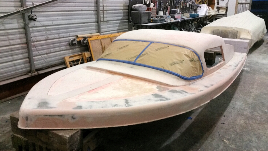

Got more filler today so on the deck it goes almost done with body work I just have to dye the deck and board it down to find low spot.I made a fiberglass mold for the hull extension and dry fit it and everything line up good I hope my pod and swim grind works or else it a waste of time not only that I don't want to have to fix anything once my boat is all done.

Hahaha 8 hrs for work 4 hrs for the delmar.12 hrs a day but I have fun doing it.glassing my pod on to the boat upside down suck resin dripping all over me I can't flip the boat over yet the gelcoat is not fully cure.it's really hard work sanding the hull and deck all by hand I just to get it as straight possible.

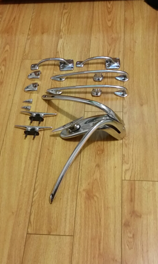

Got hardware all done and ready to install.
Re:Delmar restoration 11 years 7 months ago #104150
im assuming you got it chromed if you did how much and what shape was it in before. if not lucky you didn,t need chroming ha
Re:Delmar restoration 11 years 7 months ago #104155
  • commando
  • commando's Avatar Topic Author
  • Posts: 271
  • Karma: 18
Just polish aluminum no chrome it was pretty bad shape old and ugly before .
Re:Delmar restoration 11 years 7 months ago #104161
did you remove the anodize or just polish?
Re:Delmar restoration 11 years 7 months ago #104162
  • commando
  • Posts: 271
  • Karma: 18
Just sand and polish and a lot of patients.

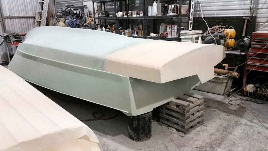

Body work is all done all I have to do is check it over and clean it then I can spray gelcoat on her but no gelcoat yet still on order.

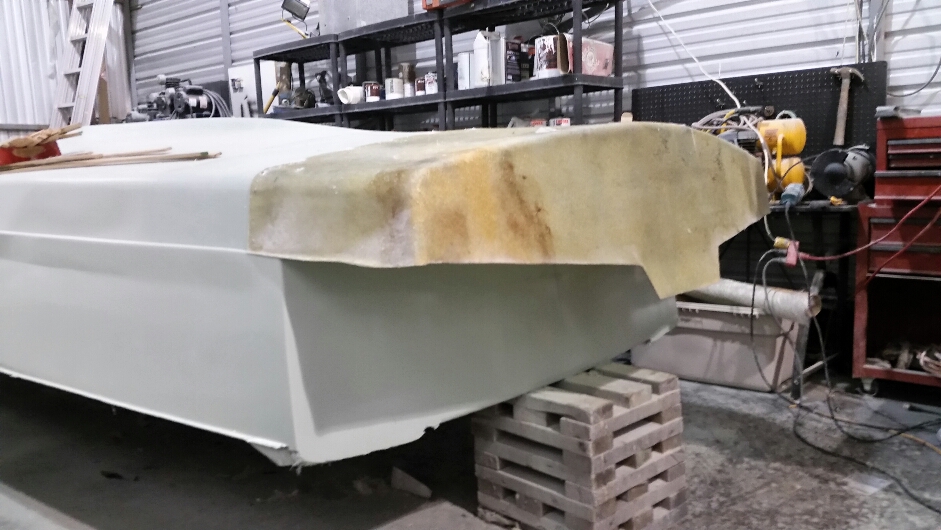

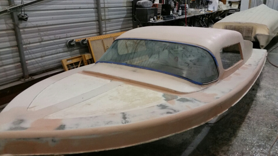

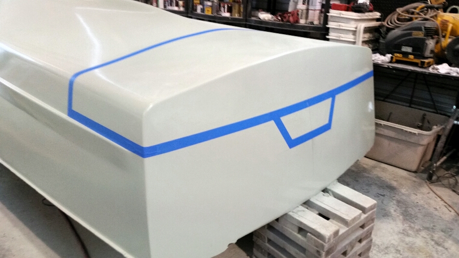

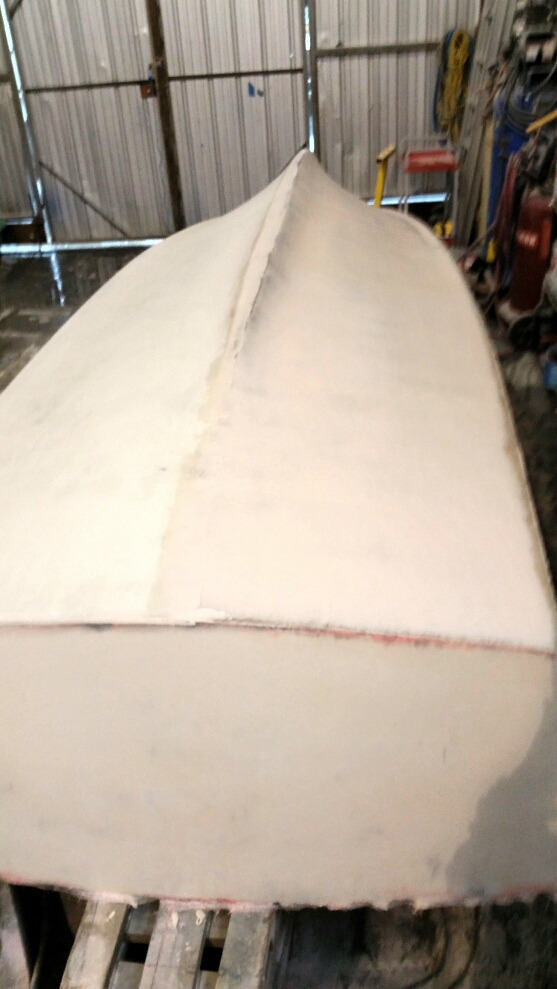

Well I finish all of the body work on the extension and the deck also I spray a coat of sealer on it everthing look very straight and all good to go ahead with my final choice of color in gelcoat.my gelcoat arrive today so maybe this weekend I can spray it if the weather is nice enough.the bad news is no one get to see what color it is hihihi so next time I post is the interior work on this boat only that might be awhile cause of the time it took to wet sand and polish the boat and mate the deck to hull stage. I'm curious if you guy look at the extension can you tell if it is a add on or not I just want to know your opinion. Thanks
Re:Delmar restoration 11 years 7 months ago #104435
Looks pretty good to me!

Re:Delmar restoration 11 years 7 months ago #104436
Looks OE great job

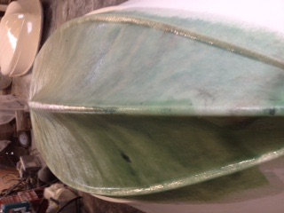

Just joking here is what my boat color is a little bit of yellow, green for sure and a little bit of blue depend on where the sun hits it.I love it......got 2 coats on so when it is dry I'll board it down with 3 20 grit and spray 2 more coats on her.

Love the color. It really brings out the lines also. I never noticed the extension lines that you took all the way back when it was primer. Very nice job!

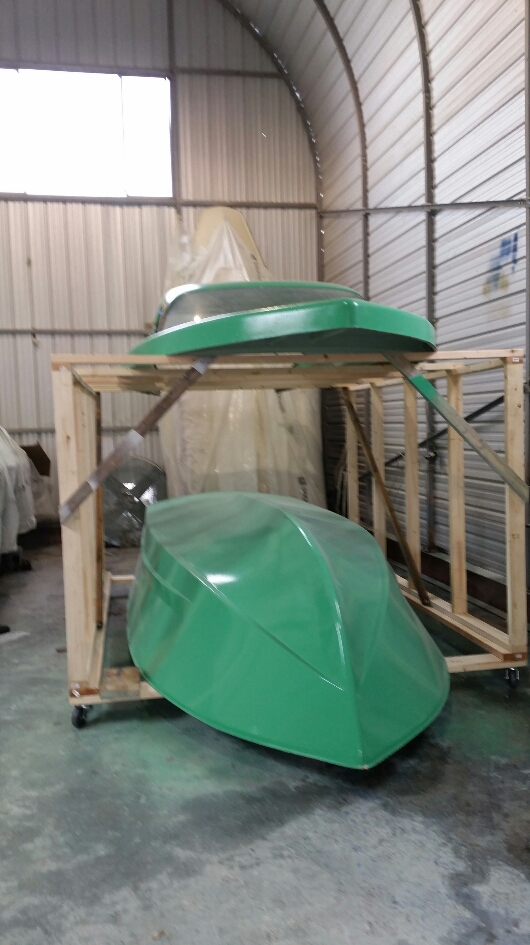

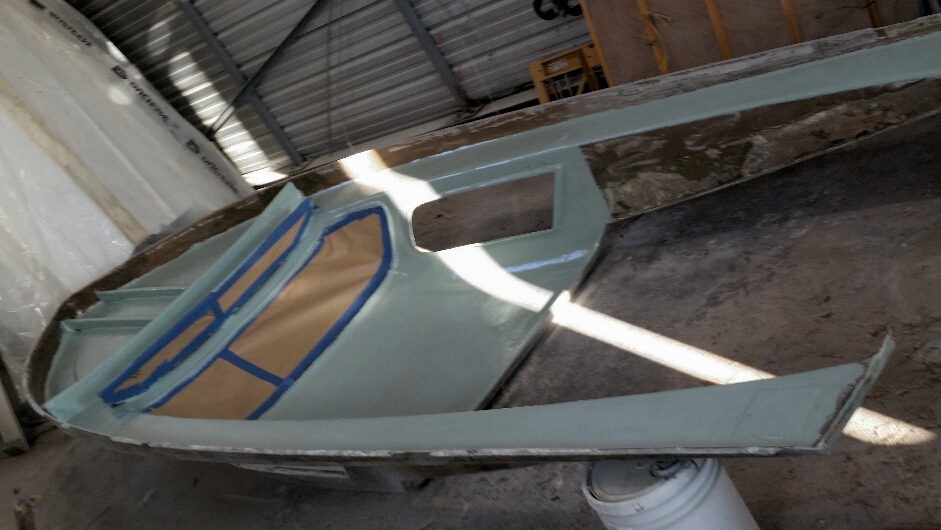

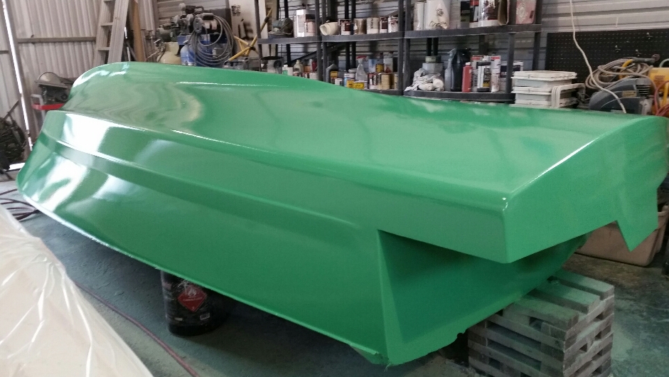

Did got some gelcoat on deck and started on the wood work but as my schedule is very tight so I made a rolling cart and rack so I can put her away for now until I have time I can just push her out of a corner and work on her again.
Re:Delmar restoration 11 years 7 months ago #104731
Looking great, yes that color is kewl

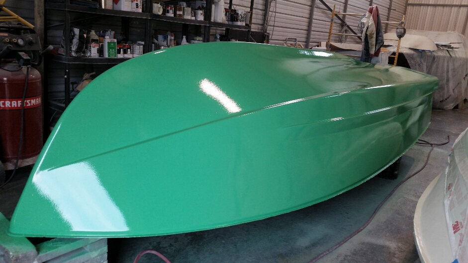

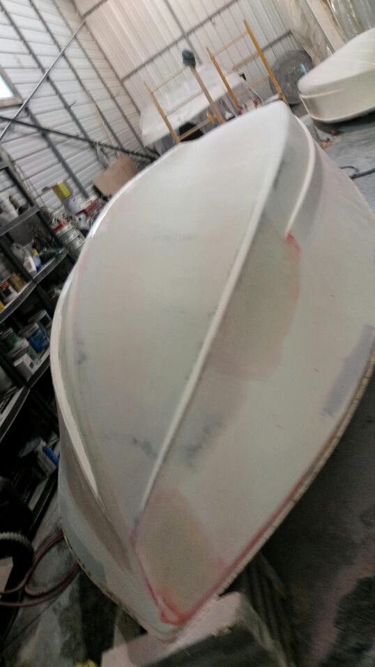

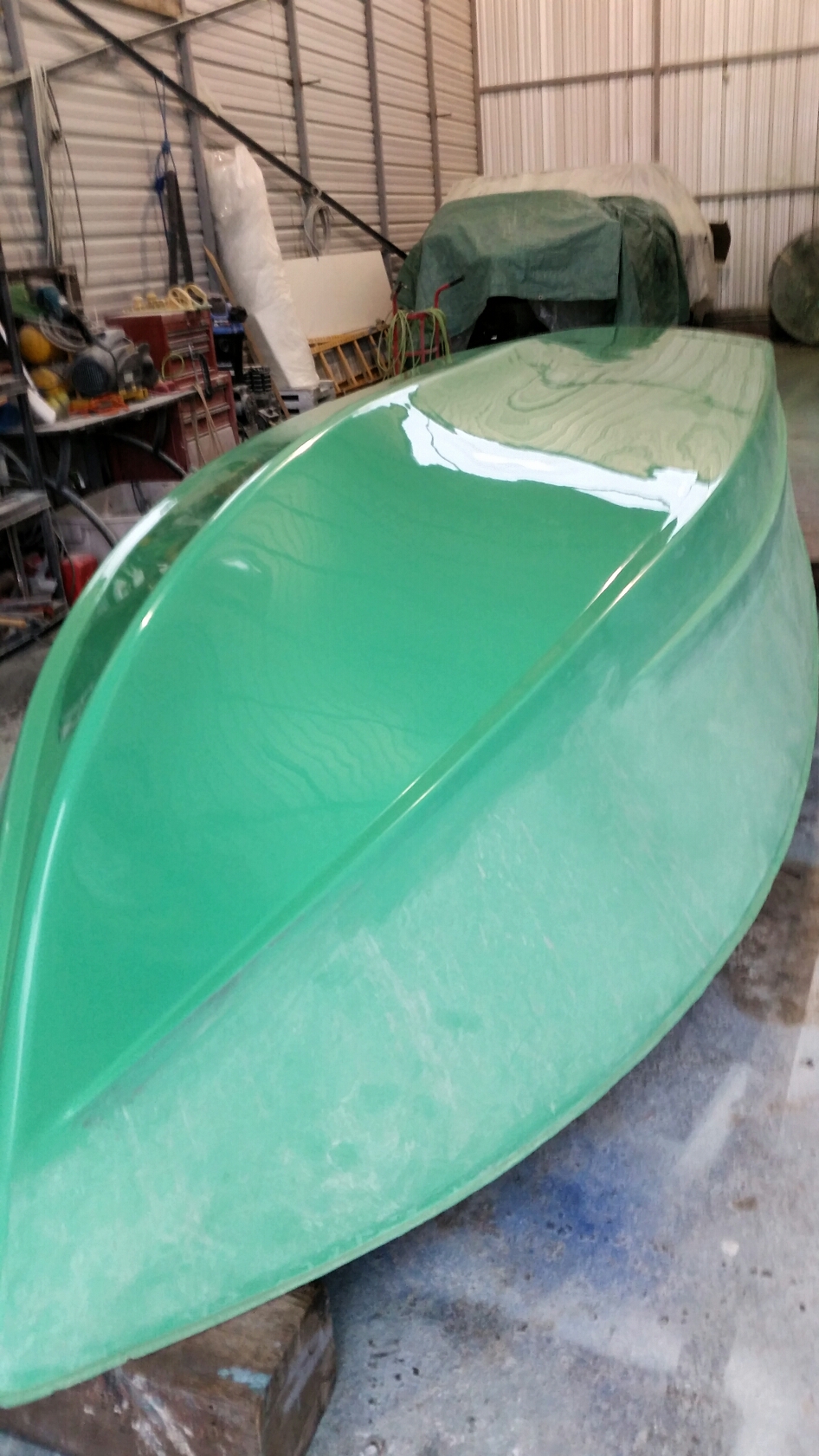

So I took a day of work to sand and polish the bottom of the boat I think I'm happy with the outcome.now I can flip her over and get this project going again.

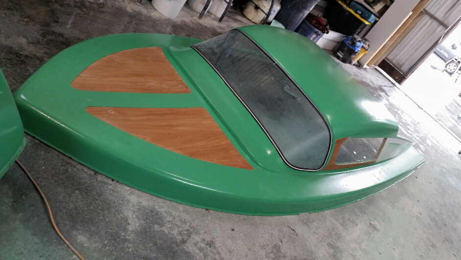

Wow, that color really pops! It is looking really really good!
