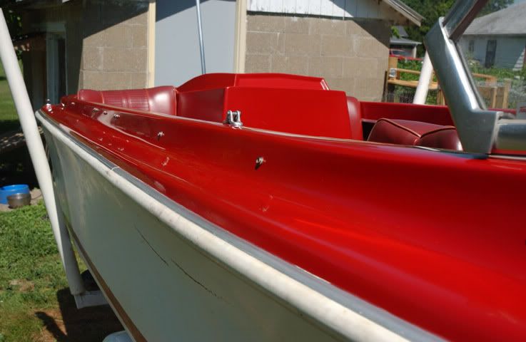

Here is what I did and the only thing that would take the paint off. 20 cans of wallmart carb cleaner took most of the paint off except a few spots but revealed a horribly faded and oxidized finish. As you can see below!
The red almost looked pinkish. I don't do Pink!

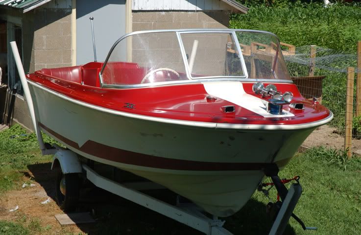

After getting all the nasty paint off I took 400wet dry and sanded the entire thing. After that 600 after that 800 after that 1000. I actually scrubbed too hard and put some pretty bad marks in the gelcoat as this is a first to me. After it was all done It looked shiny but still pinkish. I had no more time left to prepare the surface. After doing a ton of searches and realizing I had little time left little money left and eager to get on the water I decided to do the penetrol thing. Didn't use Marine penetrol just the regular stuff at home depot. Pulled the boat into my dads barn did a quick wipe down with acetone (quick). Smeared on a bunch of penetrol in three square foot sections at a time and wiped off immediately with old t shirts. Did the whole boat then immediately covered with tarp. By the way the weather was 95degrees and 80%humidity. Came back the next day and smeared on more penetrol and wiped off immediately. each time looked better and better. Came back The next day and put a coat of Megauires gold class carnuba wax ( the stuff you find in Wallmart for automobiles). I couldn't believe the results see for your self....
From two feet away in the shade you can see the bad swirl marks from sanding too hard with 400. In the sun it strangely disappears. Can't see the scratches in the sun. Anyway I am more than pleased. One thing I would do different is not push so hard with the 400 wet dry and also use some higher rated UV wax. My boat is covered all the time when not in use and sits on a trailer. For those of you on a budget this might be your ticket!
