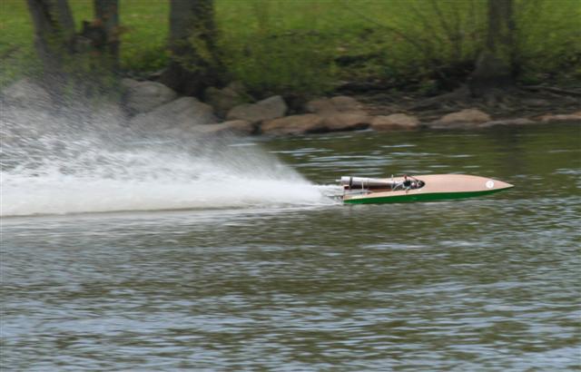

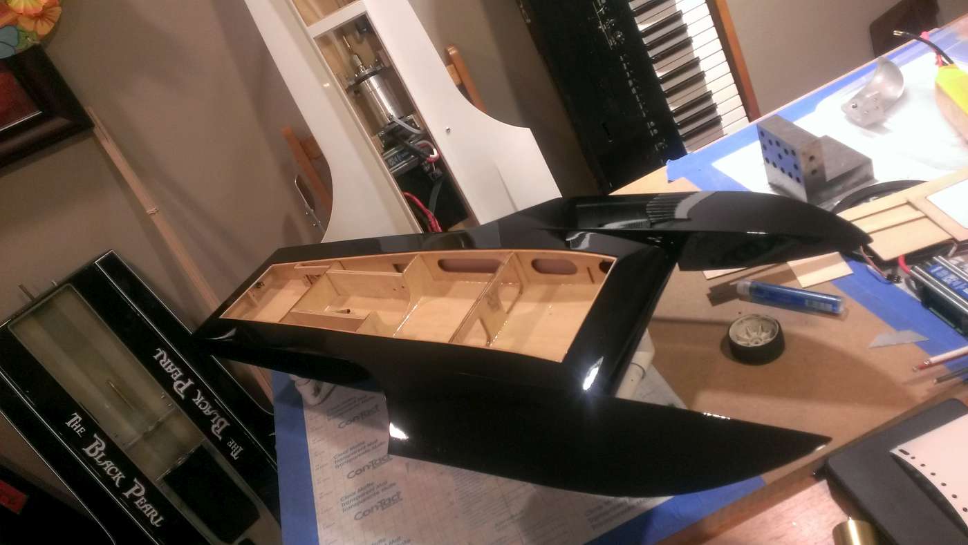

For what it's worth on the subject, I build and race model wooden boats nationally and use West Systems epoxy exclusively. I know the scale is smaller and you may start to laugh, but some of our boats are capable of speeds over 70mph!! The West Systems/wood combo makes a very rigid, durable frame.

I build and race wood rc boats also. I have been using AeroMarine epoxy from jgreer.com with good results.
