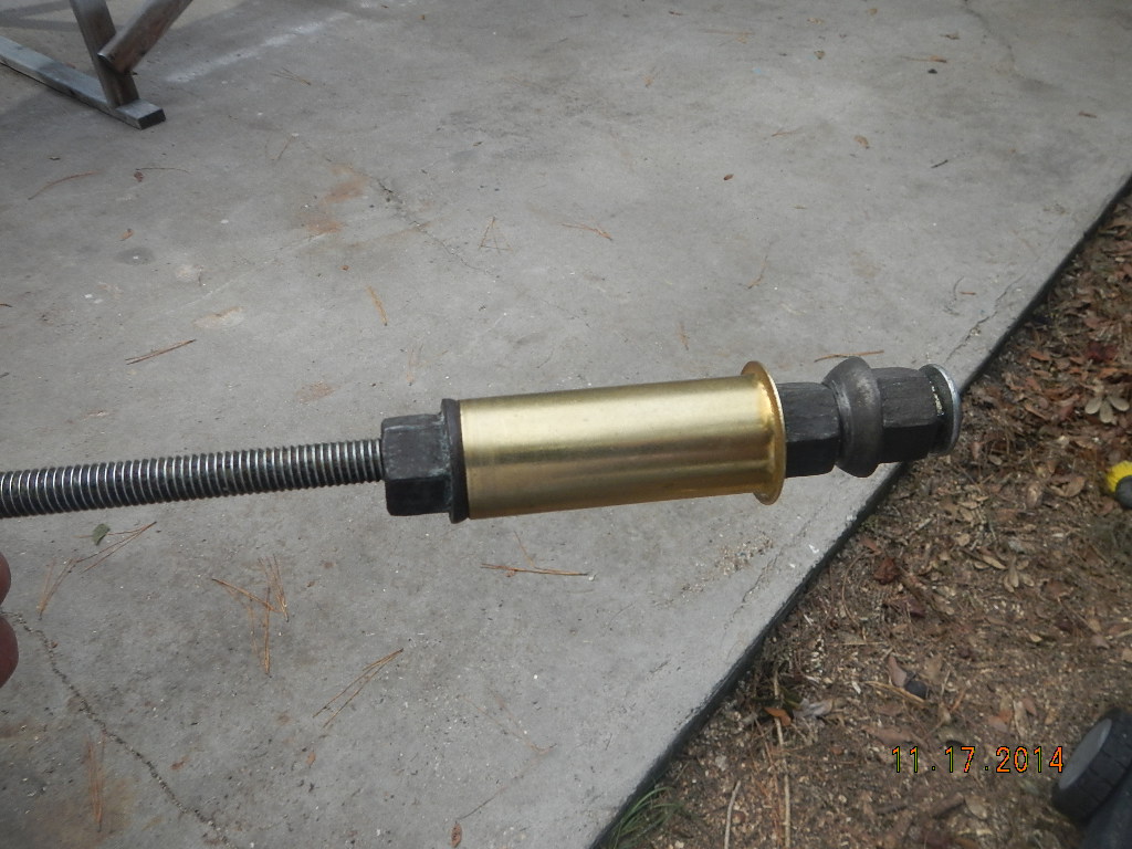

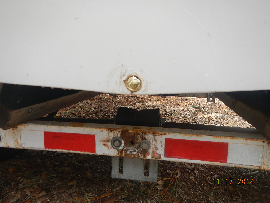

Re:Drain tube over cut? 11 years 9 months ago #102486
I used what was laying around. Includes threaded rod and lug nuts. I did finish up with small ball peen hammer. I used a tubing cutter. I trial fitted before adding glue.
