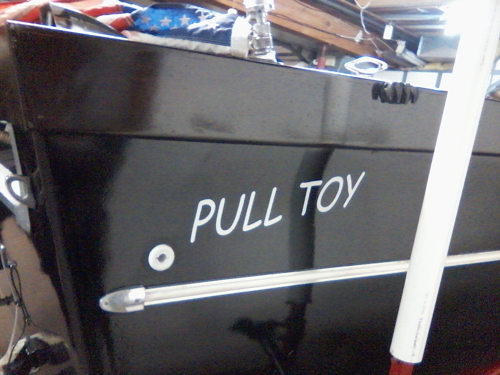

Weather has become pretty chilly, down to freezing some nights already so I'm putting my "Pull Toy" to sleep for the season. Polished her all up, took the battery out and have a vent fan running in the bilge to keep fresh air circulating. It's stored inside a heated garage. I Sta-billed the remaining fuel, pulled the plugs and prayed in fogging oil, and sprayed inside the carb. Misted the entire engine with silicone and planning on changing the elec. shift lower oil. Last spring I put in OMC type "c" today I was looking at some local stores that sell off brand lower unit oils that are stated as "compatible with type c". Didn't buy any cuz I'm a little cautious about the "compatible" claim. Thinking about staying with the original OMC, since the selectric lowers are finicky. Costs more but maybe the clear conscience of knowing what's in there is worth the cost. Opinions??

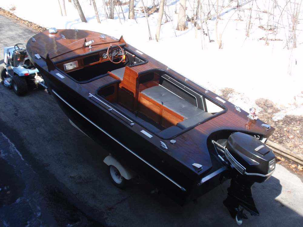

What a gorgeous boat!!!!!!
Re: What would you guys do? 11 years 11 months ago #101127
63 Sabre,
That's just downright PURTY. = I award you both ears & the tail.

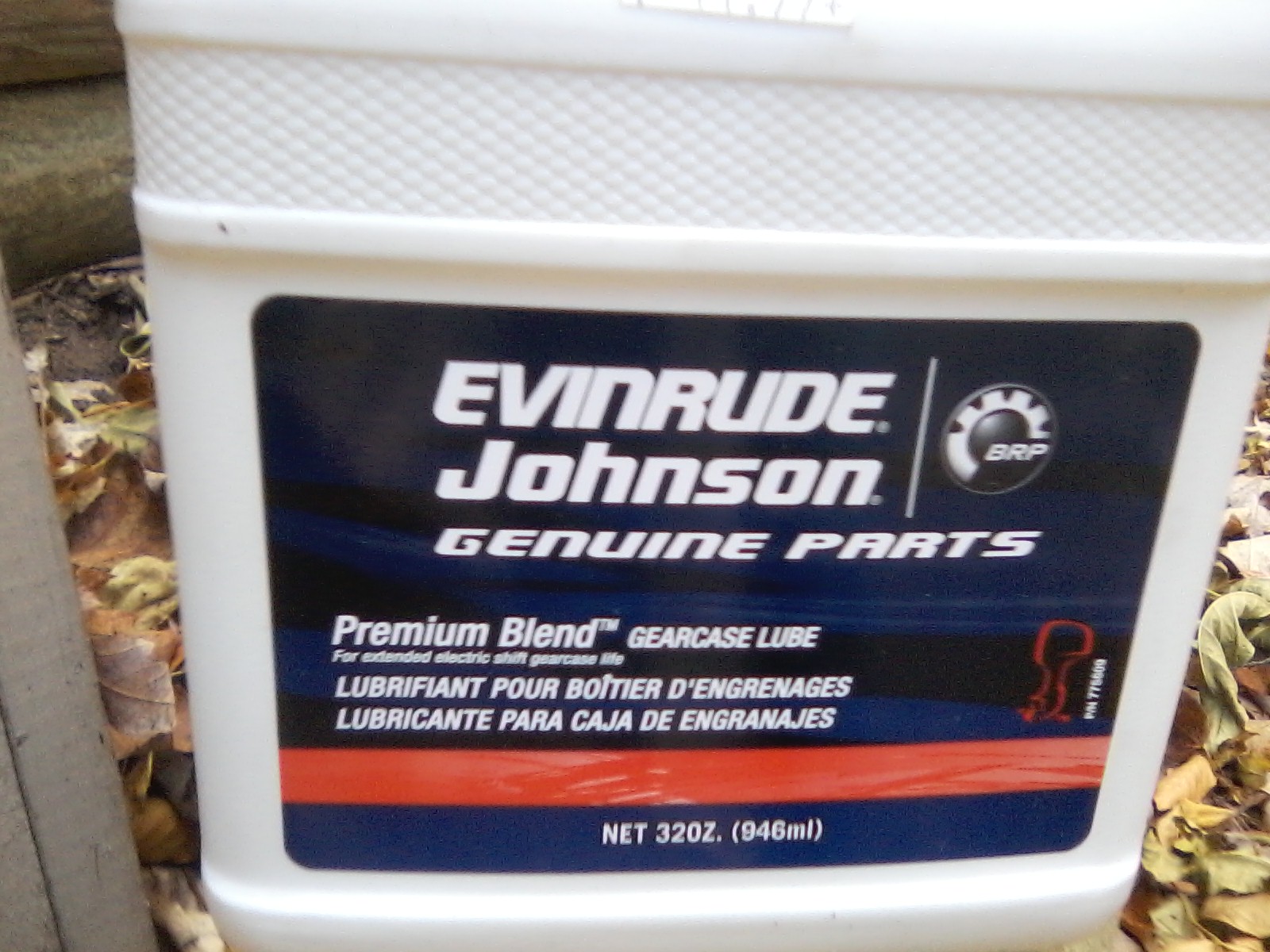

OMC calls it Premium now.

OMC/BRP still makes the stuff and yes it is called "premium blend" now. I'm in the middle of doing my fall preseason parts and oil orders at work, planning on getting myself a 5 gallon bucket for home use. (I'm down to about 1 gallon left - Lubrimatic brand I think). The stringer I/Os use over 1/2 gallon at each change.
As for aftermarket lubes, I have over the years used both Lubrimatic and Sierra type C as well as hi-vis in all sorts of outboards and I/Os with no problems. As far as I know, type C is only available in quarts and smaller now thru the aftermarket. Somehow, I doubt anyone else on this forum is thinking in 5 gallon quantities so I doubt that matters. OMC/BRP requires dealers to purchase case quantities (12 per case) of quarts or 10 ounce tubes and that is why it is hard to find. One case could be a several year supply. Most aftermarket vendors will break a case & sell individual quantities.

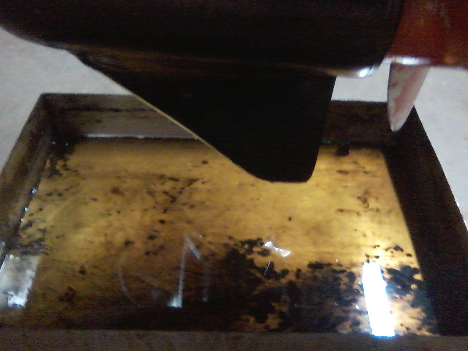

Drained the unit and the oil that was in there was spotless, clear amber color. I think I'll save it and use it for regular lube for around the house.

Oh, holy crap! I thought it was 320oz, not 32...my eyes were tired last night. Still, like you said, it's peace of mind for our very expensive parts.
