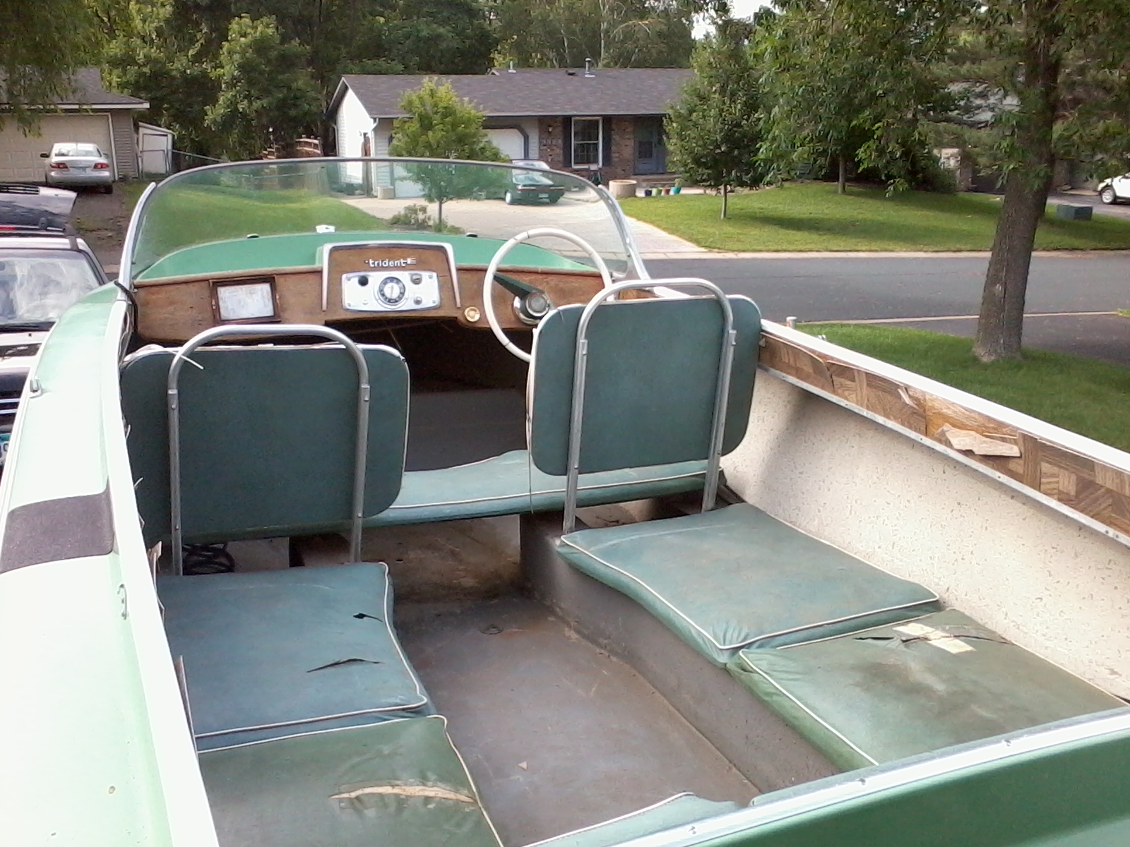

I am looking for opinions on wood preservative. I am redoing the upholstery on my '58 Glasspar Trident. The seats are all independent cushions based on 1/2" plywood. I have read that a mixture of 25% polyurethane and 75% mineral spirits is a good wood preservative. My budget is limited but I want to do this correctly at the same time. The boat will see little actual water time, just an occasional day on the lake in Minnesota's short summer. Thanks for you thoughts.
