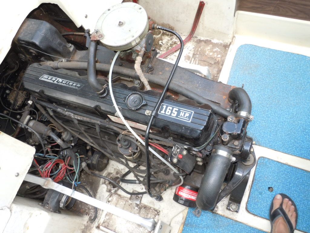

This has been a good year for this boat. I had it out on the Lake from May through September. Only problem was water in the oil. Caught that right away and got it fixed. Water was leaking past the gasket between the exhaust manifold and the riser. She ran good and no other problems. Here's the latest photos.

Jim. It's an 18 footer. The prop is 15 X 23, standard mercury original equipment prop. There is a gasket between the exhaust manifold and the riser. It had a leak in it. I took it to a shop and they did a leak down test. I haven't had a problem since they put in the new gasket.
