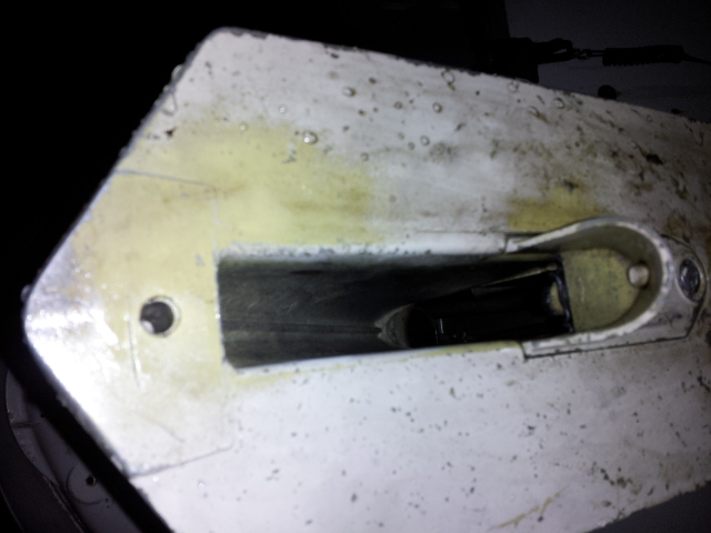

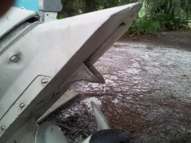

BLPen163 wrote:
I read a little on trim tabs on various internet sites but my motor does not have a trim tab that is adjustable. 1964 Johnson 75hp.....Is there one I could add to it?

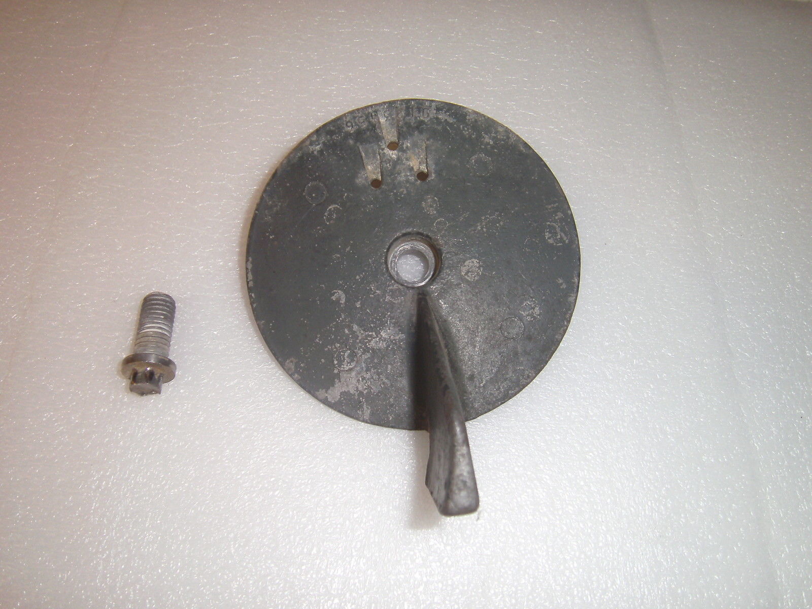

Hold on a second here. From the looks that pic, you don't even HAVE a trim tab. Its not that exhaust fixed snout. That hole rear the cav plate is where it should be, or at one time was.
Would look something like this.

There is a hole but its not threaded?
Probably just could use a bolt and a nut. They have fin/anodes on Ebay. Why dont you ask this in the JEGO forum. Maybe someone there will know more.
Re:Cable steering question 11 years 11 months ago #100637
just went out and looked at 5 or 6 v4's....58/62...all have that hole, most have a do nothing bolt in them but none have a trim tab....maybe something available as an option??

That is weird. I looked at the parts list and there was no trim tab shown. no doubt that hole was at least for an anode. If it has a fin on it like the Mercury's have it would work.
