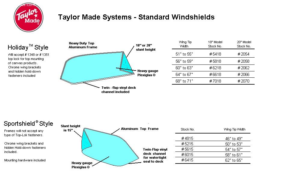

Re:windshields 11 years 8 months ago #100320
The windshields that I had in the glassifieds are still there, but only available in the larger sizes, 70" and 72" tip to tip and some larger ones in the 84" range.
I never really had any of the smaller ones. I've been told some people are having trouble getting through with the website email, so you can email me direct at dave-dcc(at)hotmail(dot)com.

Hey guys only thanks for the info. Only bad part is I have no frame to go with. It was never there when I got the boat. Anyone ever try to cut down like a 70" wide windshield and have any luck sizing it down?
Re:windshields 11 years 8 months ago #100621
The link in the last post shows how to make your own frame.
